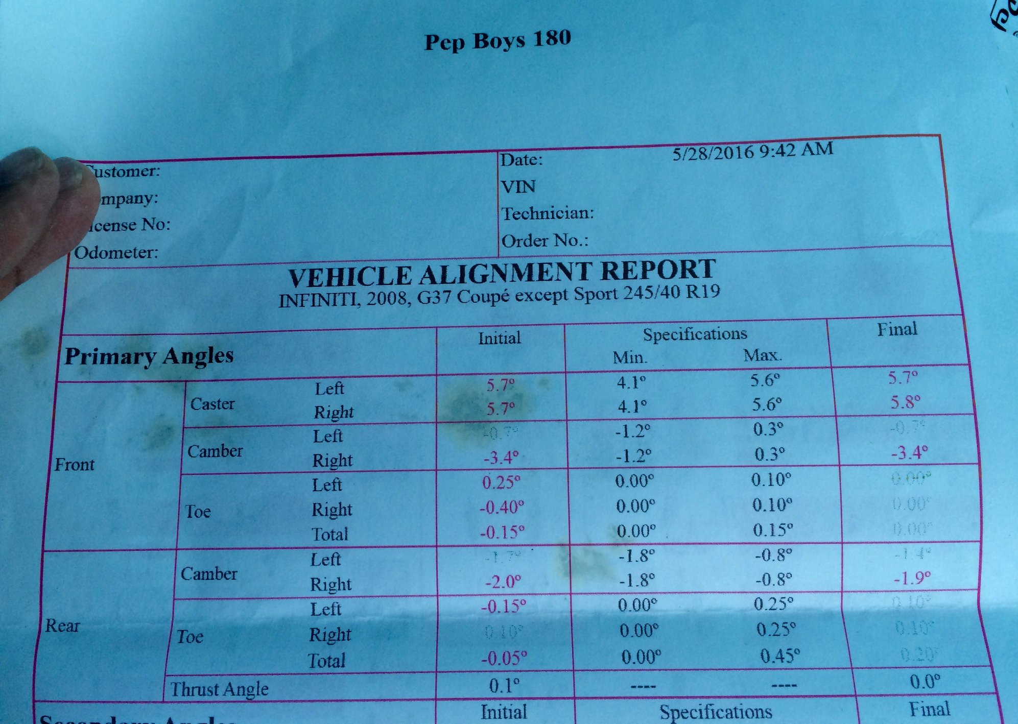

I have an '08 G37s Coupe and lowered on Eibach Springs and have Koni Yellow Struts. All else OEM.

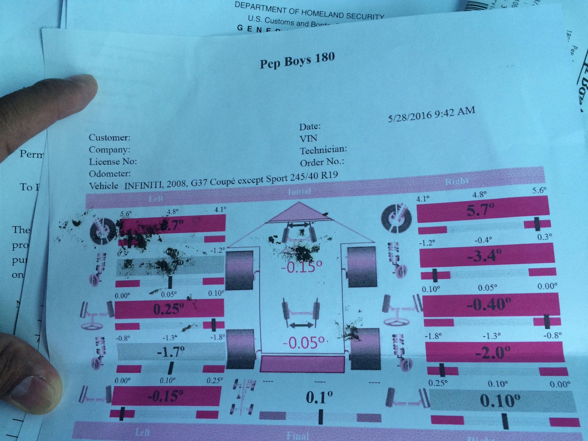

Well after getting all my wheel refinished and corrected from little bent dues to pot holes I had 4 new tyres installed and took it to PepBoys for Alignment. My front passenger side has -3.4° and should be between
-1.2° 0.3° . Driver side is in spec at -0.7° so I'm a little puzzled as to why that is. How is it that the driver side is ok and left is off and tech said he can't adjust camber because it not adjustable.
I know I can buy the spc adjustable control arm to fix camber but the right is ok with OEM control arm. So shouldn't the left be ok as well with OEM control arm? What do I do here to fix this?

Is this on the same wheel as the damage occured? You may have tweaked something.

Something is bent and my guess is the upper control arm.

Unless the alignment equipment wasn't set up properly or the tech doing the work wasn't on his game something is seriously amiss w/ your passenger front suspension.
Could have bent something if you really jacked it on a pothole or possible that the right spring install wasn't proper. Are you even height left to right?

Perhaps but the tech should check as to why one side is way off no?
I'll have to check myself when I have it up on lift. I guess. We'll see.

Thx I'll have to inspect that area.

Thank you for mentioning the springs. Didn't think to check that as well but will do since its suspension related.
