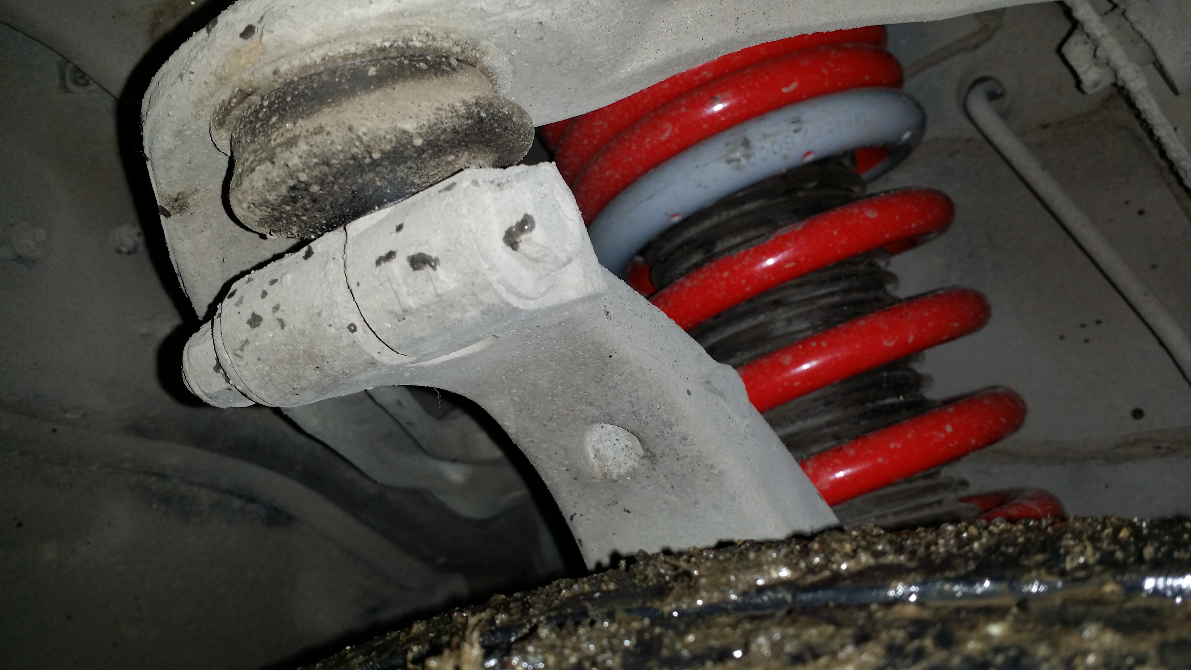

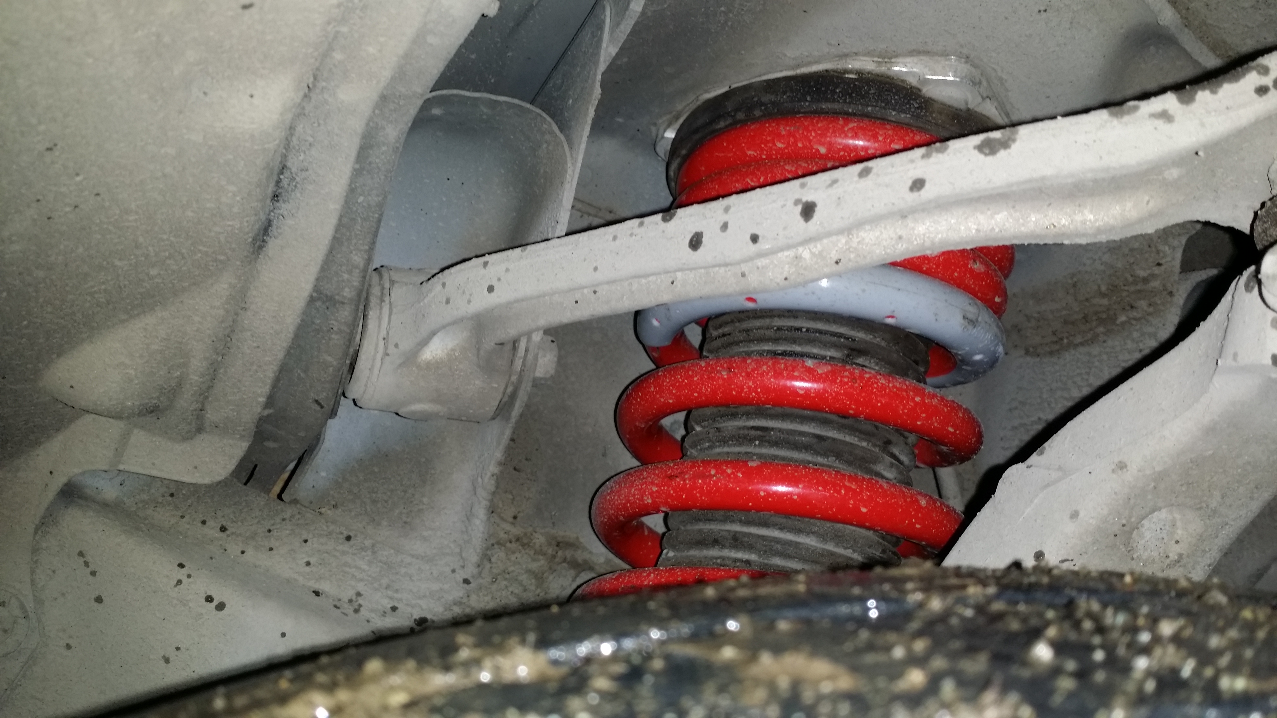

I have attached some pictures of the springs installed. Sorry about the bad quality and I couldn't get a good angle to get a good shot.

The fronts look ok from the pics, not much you can do wrong in front. The back spring bucket has a recessed tray for the spring to sit and that can be askew but the front not much there to mess up. I'd give it a few days then reevaluate if they were just installed in the last 24 hours. Can you get the back jacked up and actually see those rear rubber cones to confirm if they've been cut down?
I wouldn't try to do any alteration to the front spring or mounts.
Hope it's just a settling issue.

If it doesn't settle in the next week or so, I'll just buy different front springs and as for the rear, I'll have someone cut some more.
