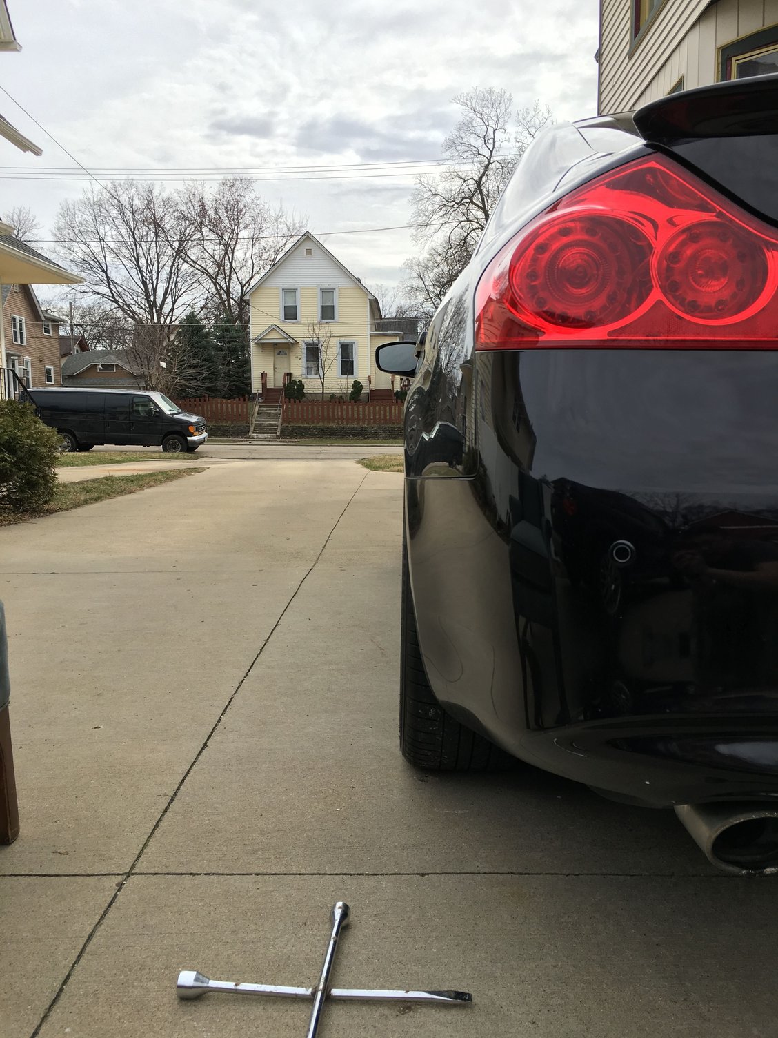

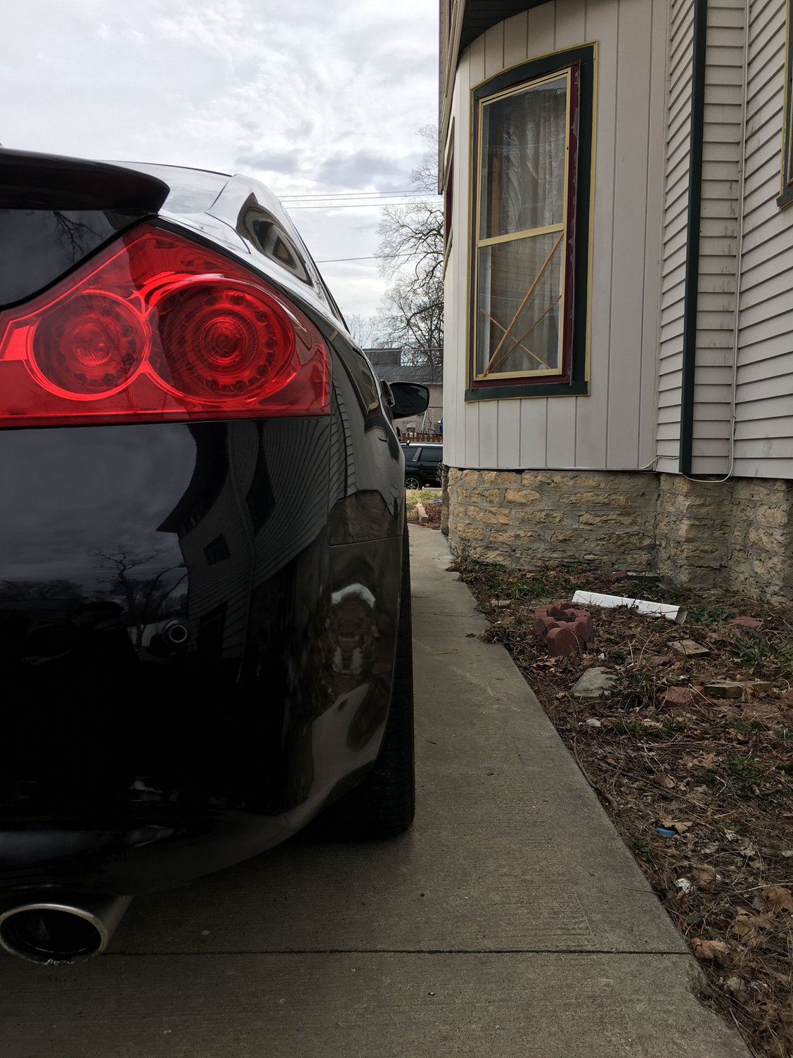

Uneven offset Left to Right
I just put back my summer wheels which are the G35 Coupe Rays 19's
I'm noticing that the tires on the passenger side poke out a bit more
I've got the rear on the rears... And the tires are the same.
Am I missing something?
I know it's not exact but trying to show you what I am seeing
More tire sticking out
No tire sticking out from fender

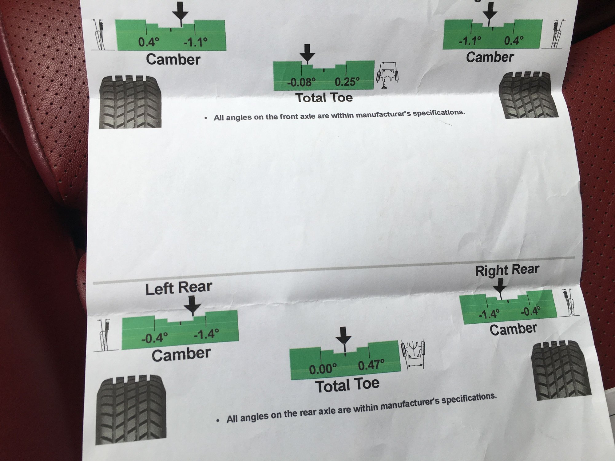

How's your alignment?
Within spec, had it aligned in the fall.
This was from when it was at the dealer for fluids in August of 2015
It was aligned again in September but should be in spec...I think
Old Mar 12, 2016 | 03:28 PM
TVPostSound's Avatar
TVPostSound
Joined: May 2010
Posts: 3,613
Likes: 117
From: Granada Hills, CA
You can't judge by sheet metal, ever.
Sometimes bodies aren't perfect.
But……there are not measurements for individual toe.

Does it drive straight? Are tires wearing evenly? If yes to both, I wouldn't worry about it.
You know, human bodies are not symmetrical either. It's a proven fact that one ******** hangs lower than the other

This is true. I think i may have figured out why it looks like this
I got some work done on the driver side, its possible that the body shop pulled the fenders to get a more flush look.

One other thing that happens sometimes too, is if one set of wheels has hub rings and the ring stays behind and you install a new wheel it can keep it from meeting the hub properly.

OEM won't be, but I wasn't sure if your winter tires were aftermarket or not. If you went OEM to OEM there shouldn't be any rings. If it's really bothering you it only takes a couple minutes to take a wheel off to make sure there's nothing blocking it and put it back on.
Old Mar 13, 2016 | 03:09 AM
OEM wheels are hubcentric, the OEM mag style lug nuts w/ washers get it very close and the 66.1mm wheel bore and matching hub flange do the final centering.

Ninja edit its probably the body work as you stated
