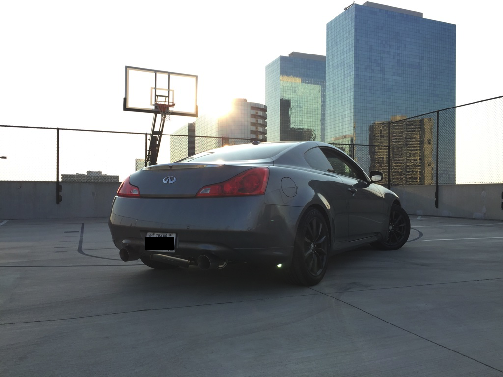

Old Oct 10, 2015 | 12:25 PM
xmajd92's Avatar
xmajd92
Joined: Feb 2015
Posts: 551
Likes: 35
From: Houston, TX
Here is a before & after for you guys:
Before:
After:
Just for laughs
Old Oct 10, 2015 | 01:48 PM
Likes: 4,952
Nice fit!
