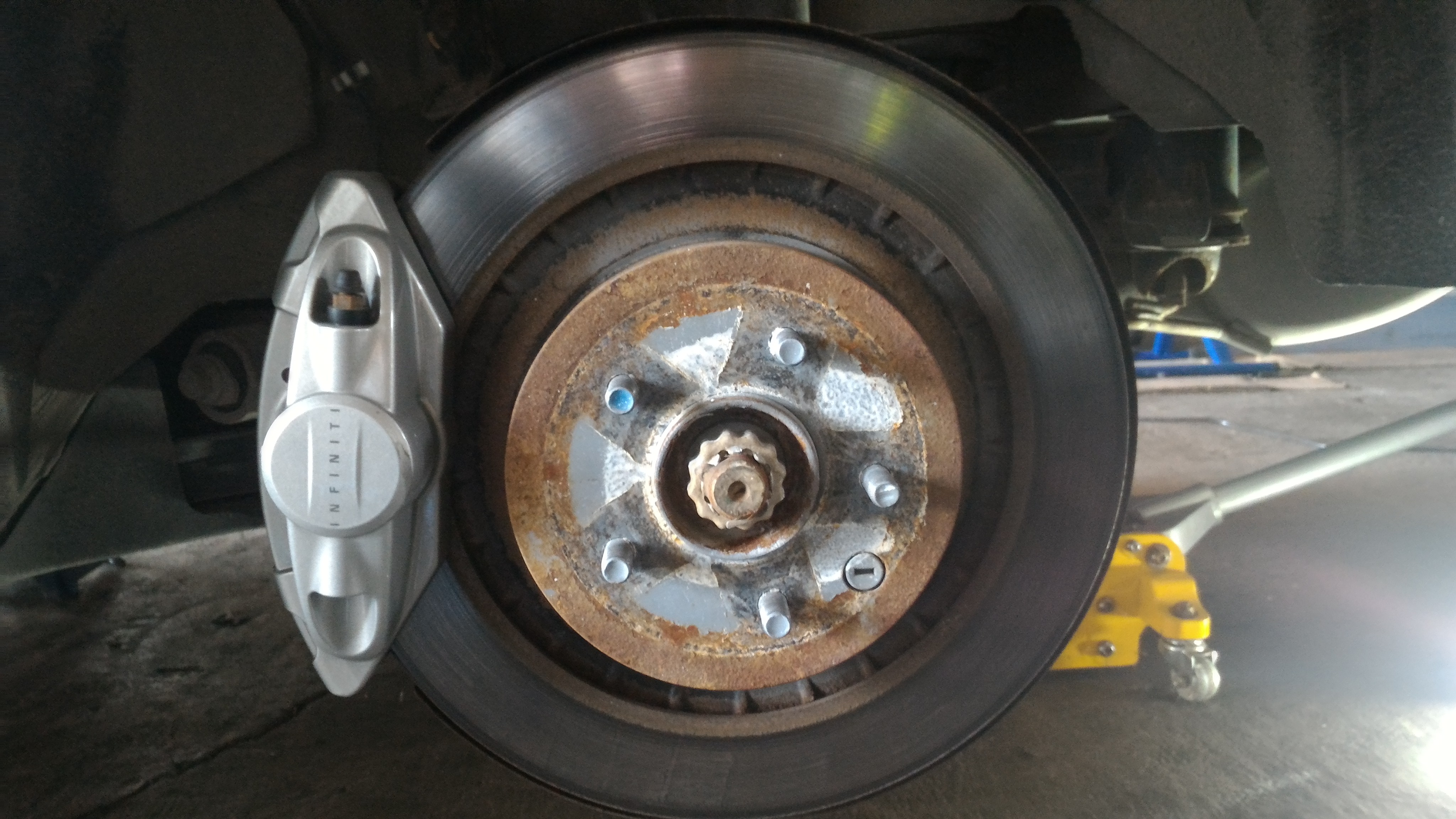

I got my car up and wheels off and was trying to remove the calliper but the lower bolt is blocked by some suspension bits and I couldn't get a 3/4 socket in, gotta get a smaller socket and see if I can squeeze it in. Anyone else have issues getting this bolt out? However I was able to look at he pads and they seem to have a good amount of material left.
I saw you mentioned a specific synthetic grease in a thread (thought it was this one but I don't see it). What temp does the grease need to be good to? I picked up a synthetic grease and Canadian Tire but I don't know if its high enough temp.
I also added a pic of the Car you can see the rusty front rotor, un-cool lol

It's CRC caliper grease and probably good to 1000 degrees or more (just guessing).
You can use a 6pt. box end wrench and wack it w/ a rubber mallet or use a cheater pipe on the end of the wrench for leverage.
As far as the rusty rotor, you can use a wire wheel on a drill to clean it up, then spray w/ VHT Flameproof paint, just mask off most of the pad contact area but leave abotu a 1/4" up into the pad area so the pad will cut a nice clean edge. Should hold up well.
