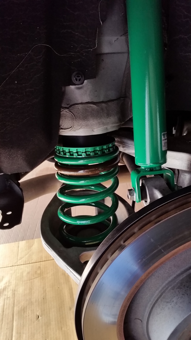

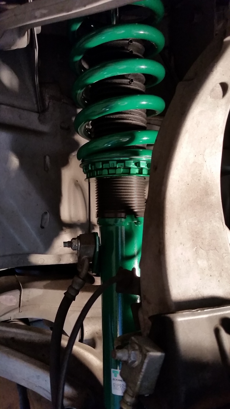

Thanks for all your help blnewt! I finished the install Saturday and the front was sooooo much easier than the rear. No problems at all doing the front and everything went smoothly. Still don't know why I had so much trouble with the rear when it's supposed to be the "easier" of the two. lol

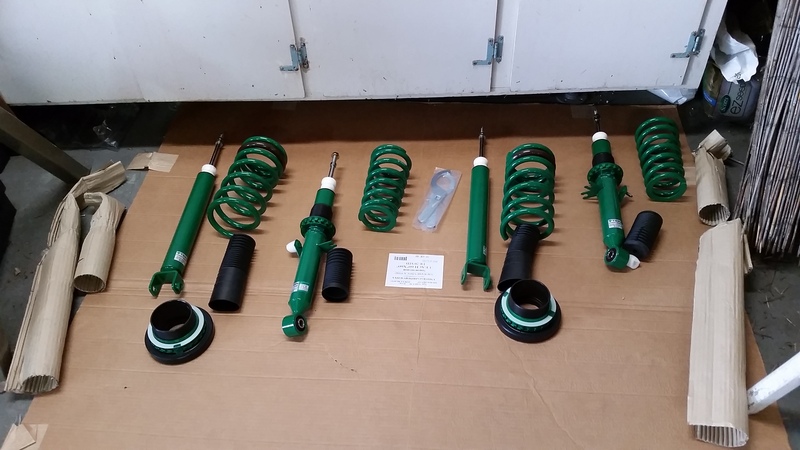

Here are some pictures, initial thoughts, and measurements of the new setup...
Tein BASIS coilovers unpackaged:

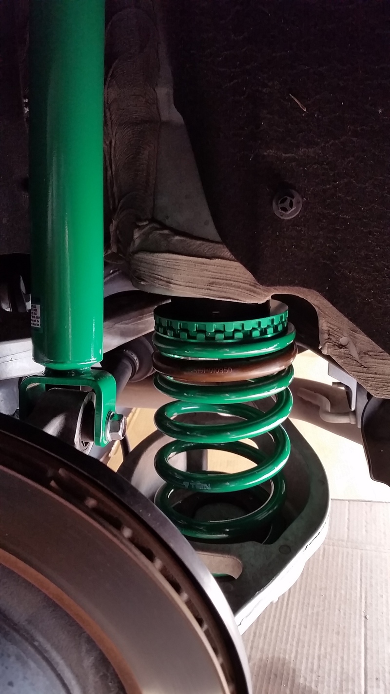

Passenger rear completed:
Driver rear completed:

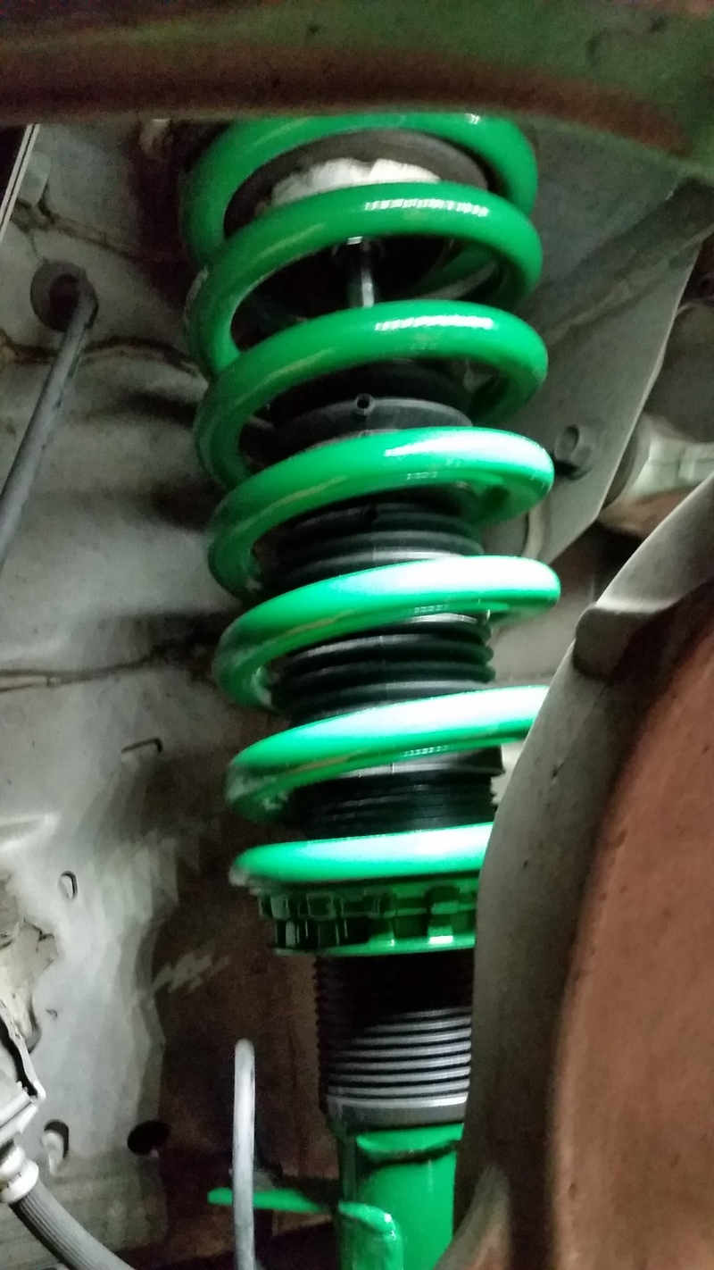

Passenger front completed:
Driver front completed:

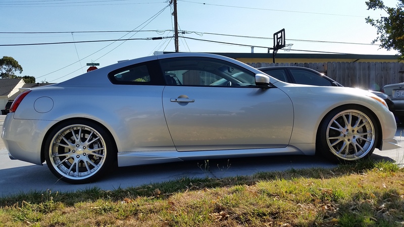

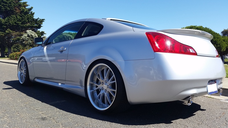

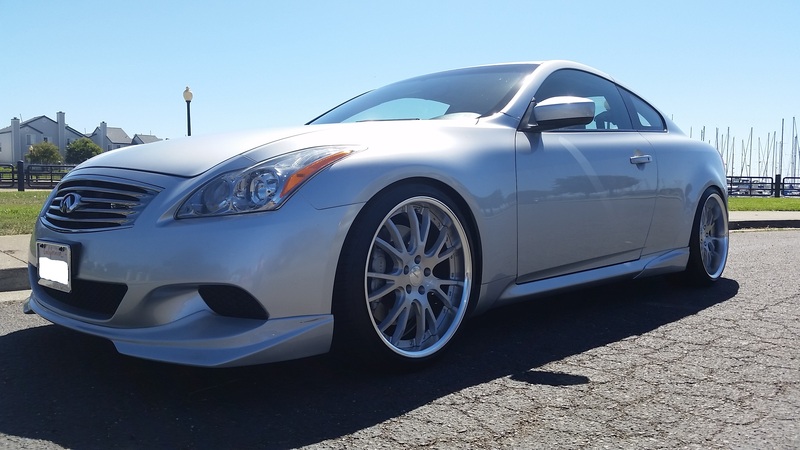

Shots after install with Tein recommended settings. NOTE: I couldn't get a full side shot from the driver side because my brother-in-law's car was in the way:
I took the G out for a quick drive after the install and noticed immediately that the ride quality was a lot softer. The Tein-S that were originally on the car definitely had a stiffer ride to it. Personally, I'd prefer the stiffer ride quality but the height of the vehicle just made driving it on a daily basis unpractical.

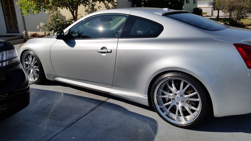

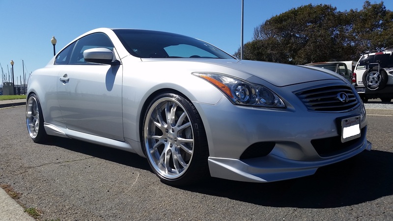

Just wanted to give a final update as I am considering this project complete!!

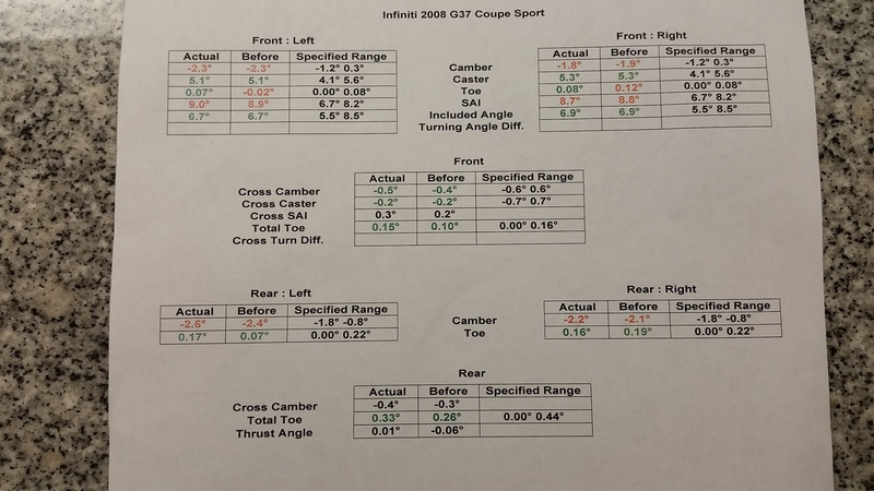

After much adjustment back and forth, I finally got all 4 corners adjusted to 26 1/4". I just got back from the alignment shop and on my way home, I stopped and snap some shots so I thought I'd share. Here are pictures of the final product...
And my alignment specs...
I'm really happy about the final outcome of everything as the height of the car looks so much better and so is my alignment compared to what it used to be (the driver rear was at -3.6 prior to installing the coilovers). Now I can actually drive the car without fear of what's around the next corner. lol

This pic right here is the money shot, what a great looking coupe you've put together, glad you found that happy place, I know I'd be happy w/ such a nice setup
Be sure to keep an eye on your inner treadwear, summer tires can wear pretty quick running that extra camber. BTW, jealous of those wheels, awesome choice there!
