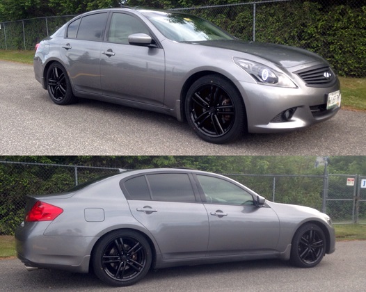

This is an X with 19x8.5 Infiniti rims and Tanabe NF210 springs. No cam kit installed yet as only rear is out of spec and barely, I like the slight slam look... If you're looking for a year round option somewhere with mediocre to bad roads like me, this might be a good suggestion since it reduces wheel gap but doesn't leave you scraping.

damn that looks pretty good and i also just got a set of M 19s... how much did it cost you to do that?

Thanks man, I picked up the springs for $180 and had my local dealer install them, so add the time of labor. Worth it to kill the AWD gap though.
