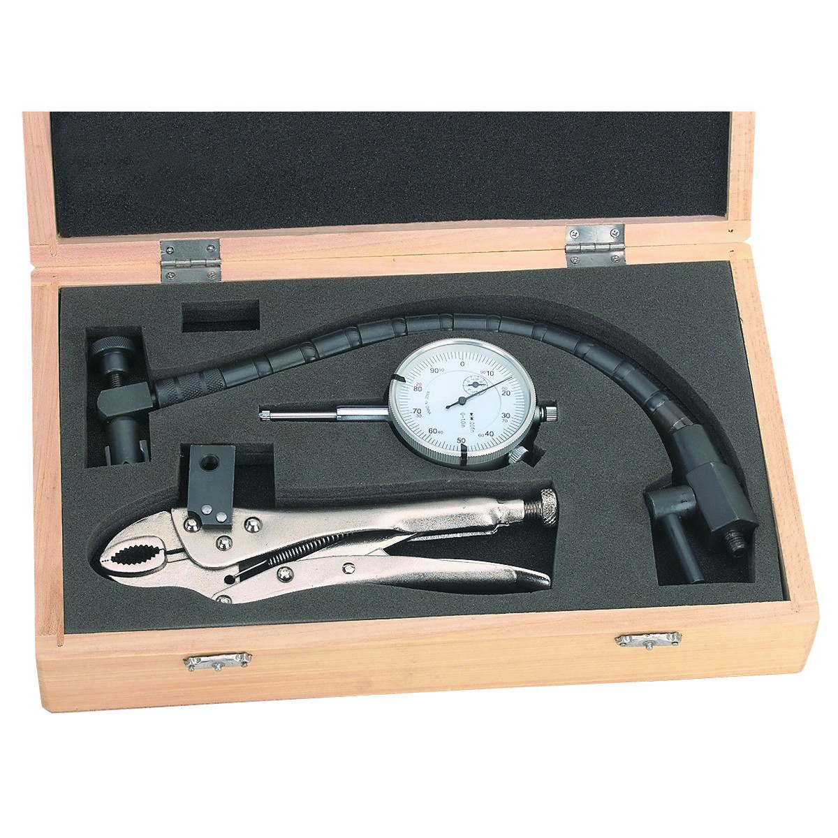

if you install new rotors or even have the oem rotors turned, make sure the hub is well cleaned with a wire brush / aggressive cleaning pad to to minimize rotor runout from dirt between the rotor and hub.
if you want to go a step further buy a dial indicator and index the rotor to further minimize runout or find a shop that has a gauge.
if you want to stay with a ceramic pads and can stand the dust/noise, i would recommend going with an aggressive autocross pad to keep the rotors clean. another option is to buy race pads to clean the rotors after a few stops / bed in and switch back to street pads.
$35 dial indicator with mounting arm
