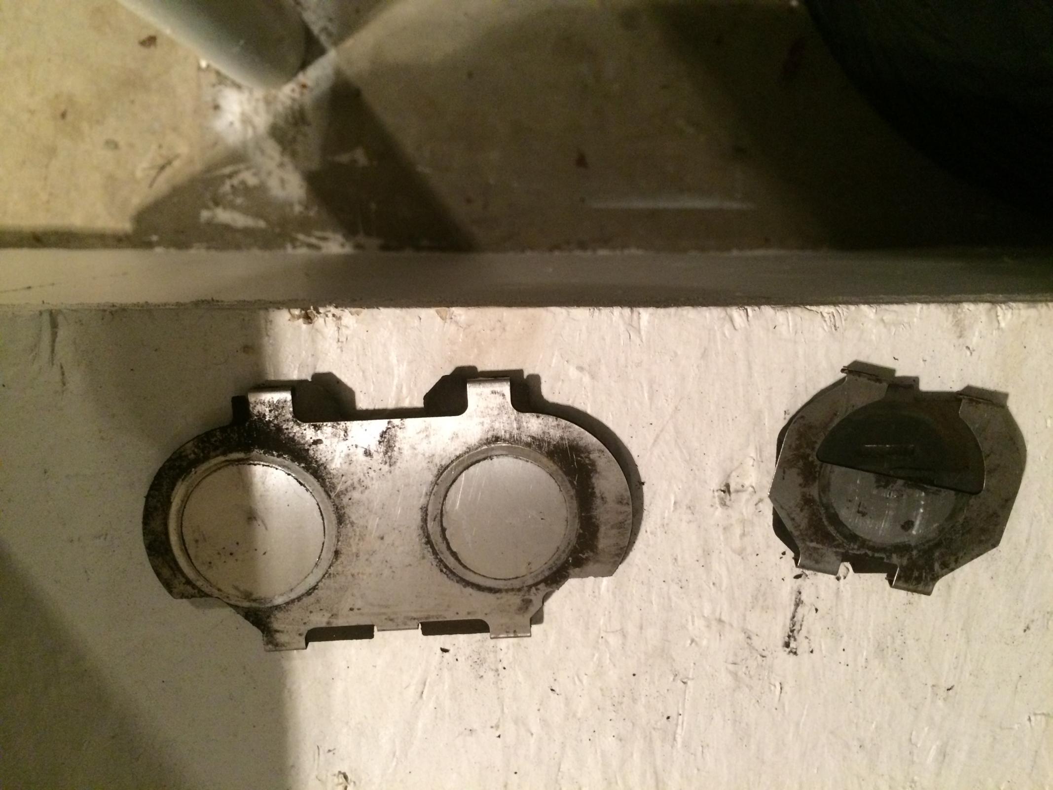

2009 g37s with 60k miles so it was time to replace the brakes.
had a local mechanic replace my rotors and brakes today. After he finished he gave me back all of the old parts and i noticed after i got home that these were still on the old pads (see attached image). I believe they are the rear shims correct? i always thought that the old hardware was reused so i called back the mechanic and he said that they were not needed.
blnewt you said that you don't have to use them is there any harm in not using them?
any help is appreciated thanks!
side note i also got hawk pads however street 5.0. after the bed in the brakes still feel a little spongy.
Old Jan 21, 2015 | 02:55 PM
Should be fine w/out shims on the Hawk pads, if they were OEM pads then you'd reuse them. As far as spongy brakes, might have some air trapped in the lines, I'd take it back and have them do another bleed. BTW, they did do a complete fluid flush right? If not, they should after 60k.
