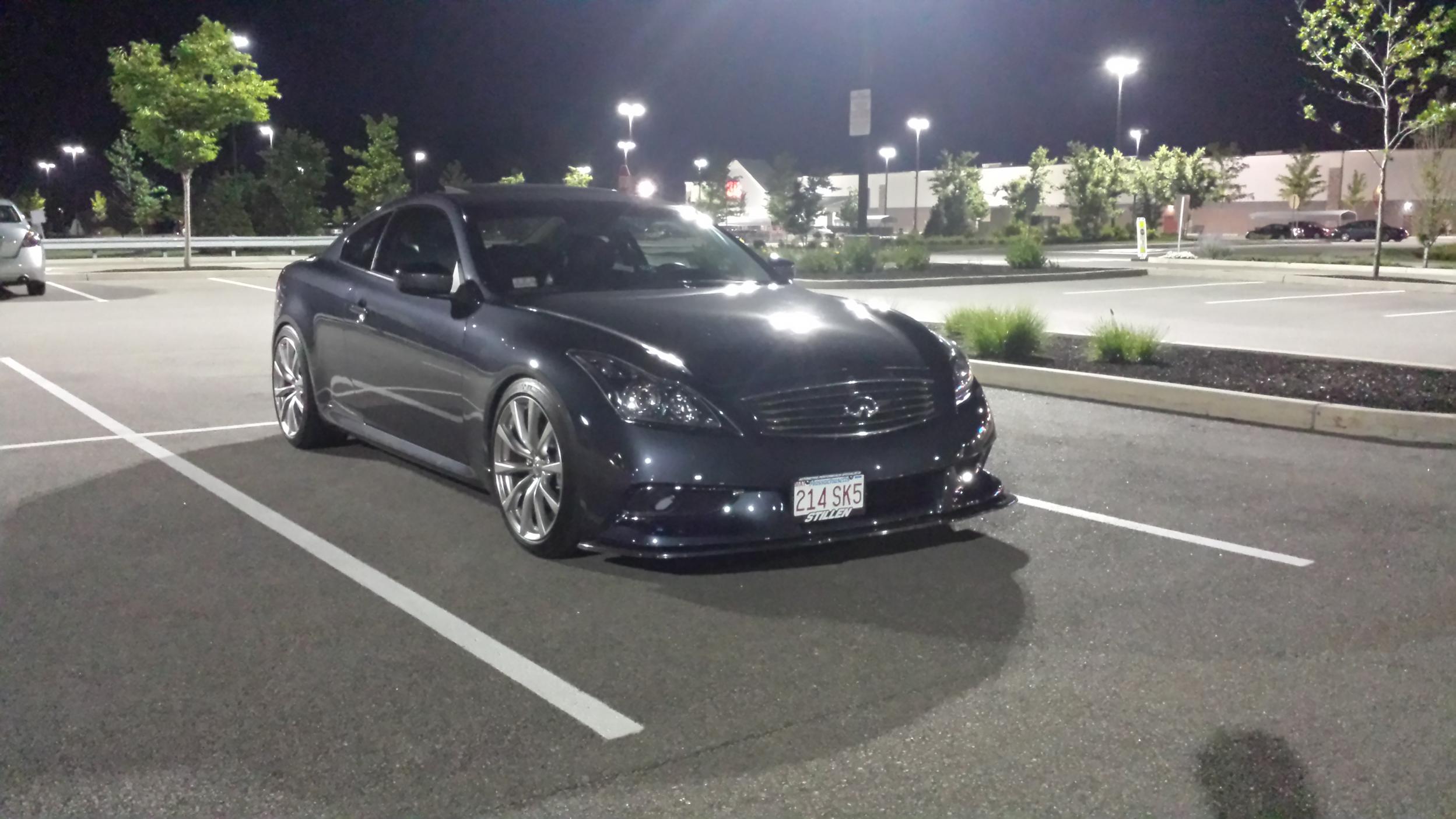

Here's how it currently sits.

You can run 275/35/19s, just remove the spacer, mount the new rim w/ 275s and see how much spacer you'd need to get the same fit you have now, I'm thinking 10 to 15mm should work.

My same thoughts ^^^
