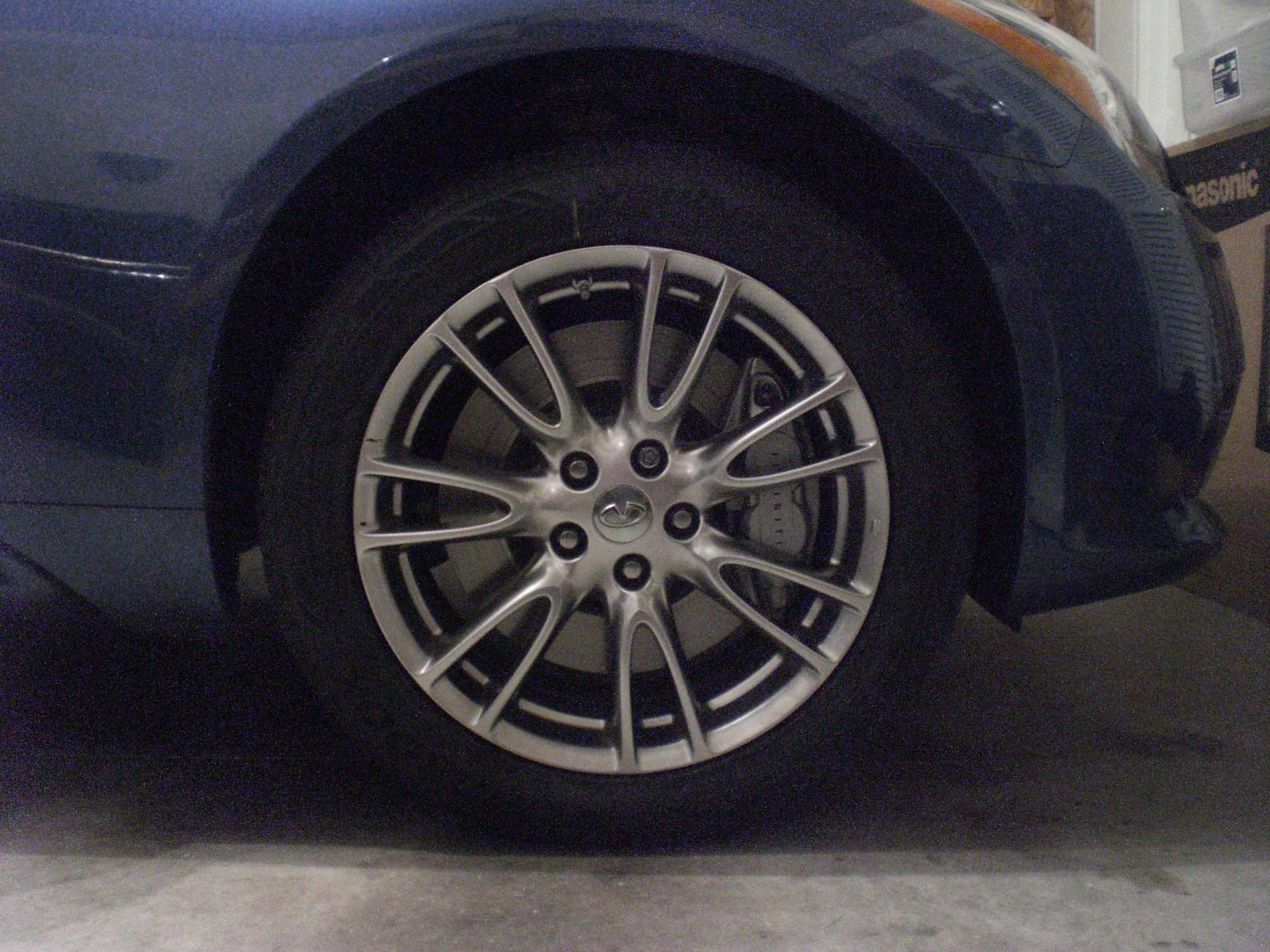

here are the pics of the 18's I used.... sorry it took so long..

I thought those particular OEM wheels wouldn't clear the Akebono's? Thought the wheel had to be at least 18x8.5 in order to clear the caliper. Have you had any issues so far with the set up? Have any pics of the entire car with these wheels on it?

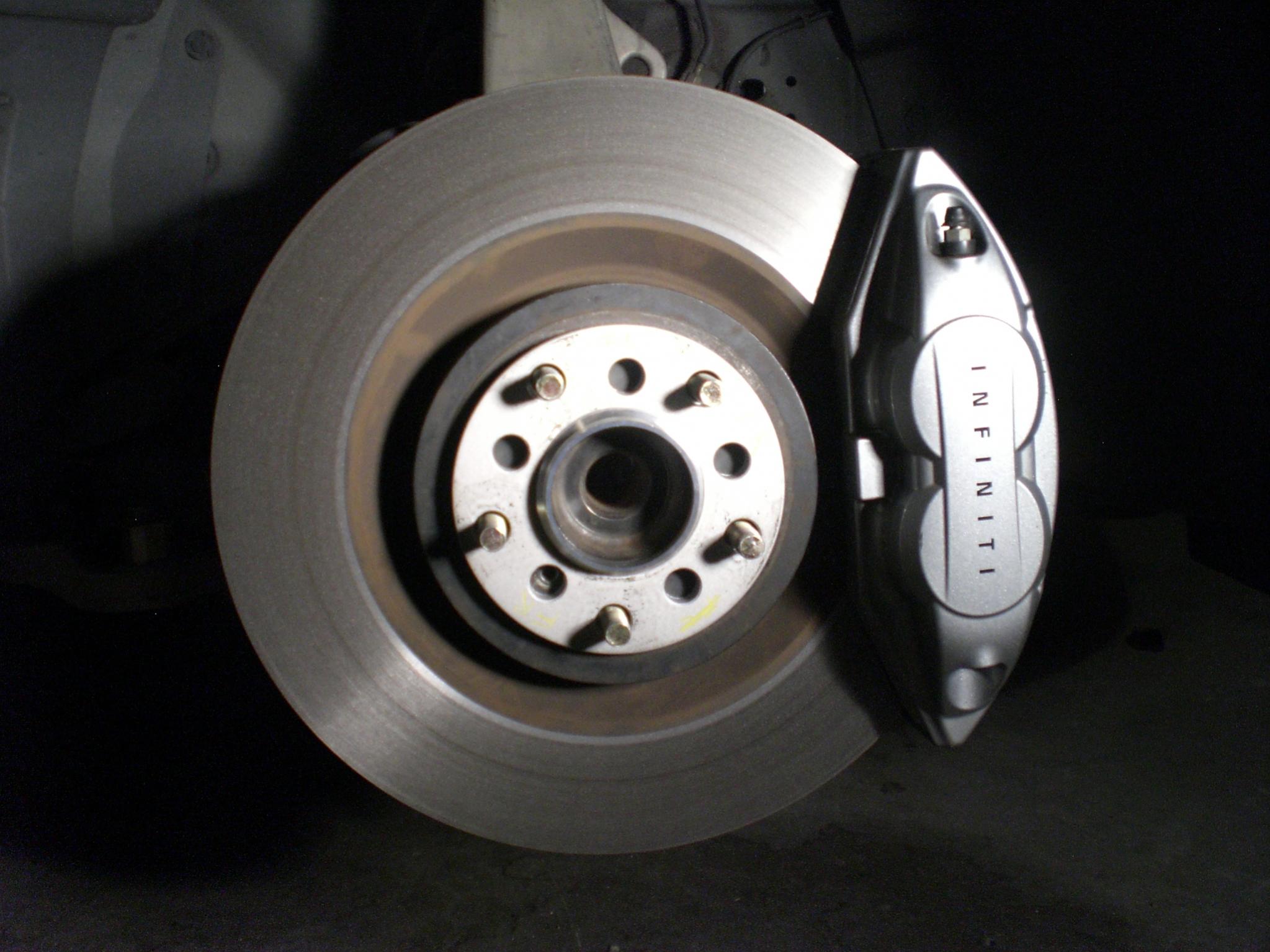

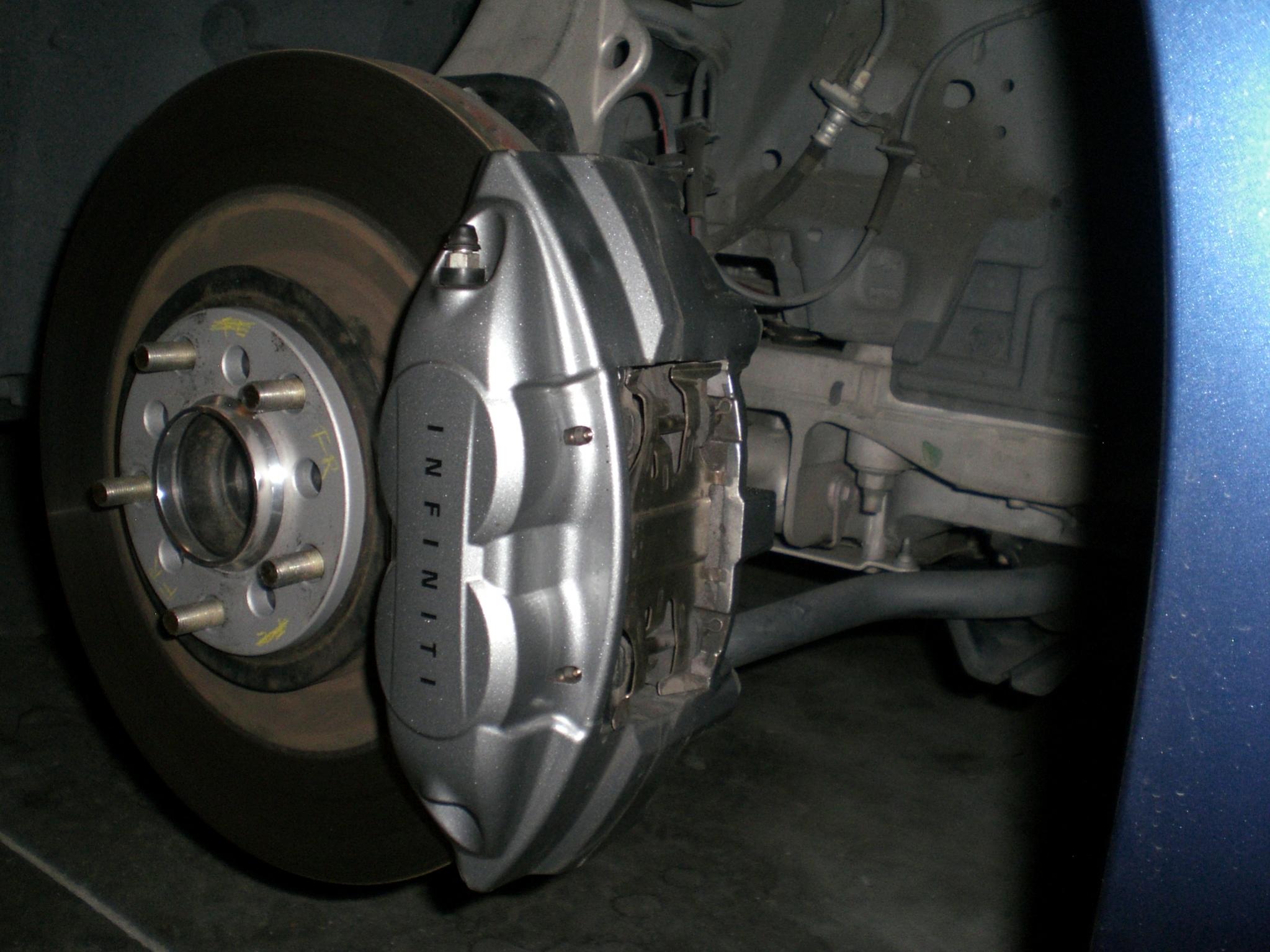

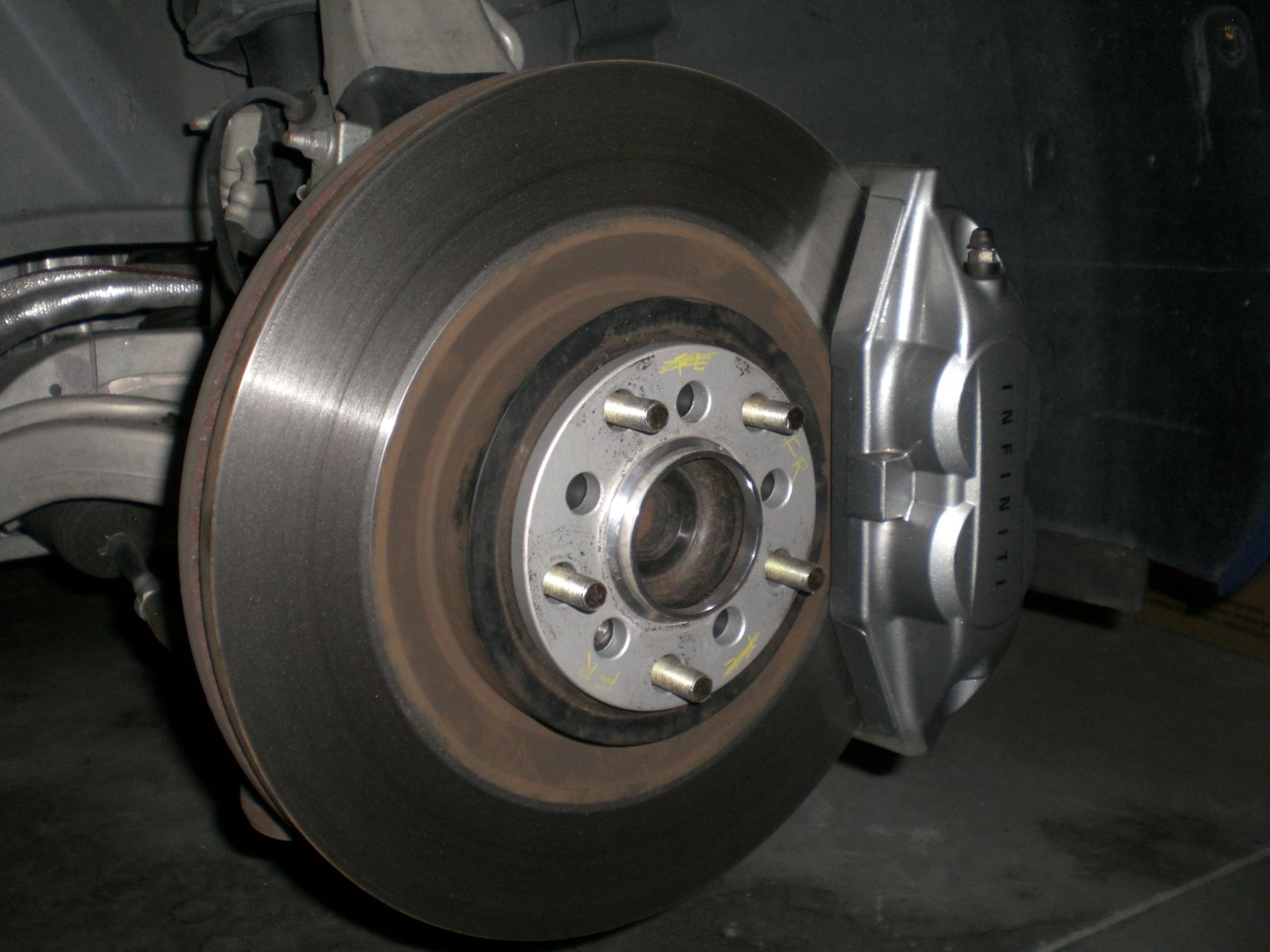

Here is a pick of the hubcentric spacer I used. To test out this set up. I put the original 19" on with the spacer installed and had no vibration issue. This proves that the Allfactory wheel is defective ..The 18" G35 sport "wish bone" i believe is the name of the wheel. Will work just as long as you get a known good wheel to use and the 10mm spacer.

pics of spacer

I put the original 19" on with the spacer installed and had no vibration issue. This proves that the Allfactory wheel is defective ...
I would agree with you.
