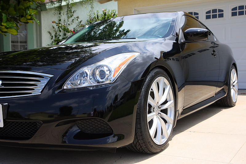

I think you'll be happy with the Pro kit....here is my G with with stock 19" wheels / eibach pro kit and spacers
Very nice.
H&R Spacers, 20mm up front and 15 in rear?
Is there anything compromised when using spacers? I can't get the idea out of my head of the wheels breaking off when cornering too fast, or something equally as stupid.

Originally Posted by WillCo1
Very nice.
I have b2autodesigns spacers and if they didn't break off during the SoCalVQ GMR Run....they never will
Old Jan 20, 2014 | 09:13 PM
Likes: 4,951
Great pic Sergio, G's looking super clean!
As far as spacers, the B2 spacers, H&R, and Ichiba bolt on hubcentric spacers are good choices. Be sure to torque to 80 ft. lbs, DO NOT use any threadlocking compound and recheck torque after a few hundred miles and every tire rotation. Be sure to use a 6 pt. socket when torquing the spacer nuts, they tend to round off pretty easy w/ 12 point sockets.
