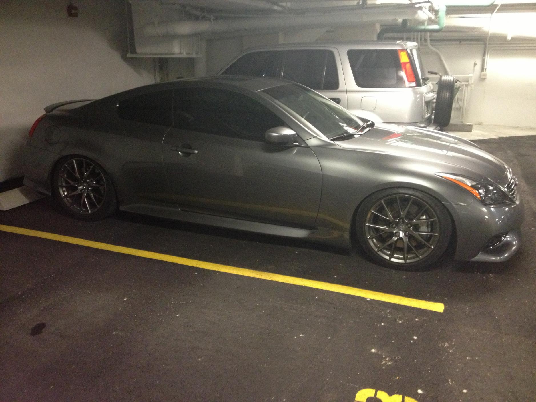

My ride w/ KWv1 & 20F/15R mm spacers.

Damn, your car is on the floor, that's how many inches?
Old Nov 24, 2013 | 01:51 AM
sobeIPL's Avatar
sobeIPL
Joined: Oct 2013
Posts: 622
Likes: 105
From: Miami
KWv1 run around 1500ish. SPC is around 450ish. I got everything THM. With coils you can go as high as stock (or close) and lower than practical to drive. Honestly, my parking spot in my garage (location of pic) isn't quite even and that side appears lower than it really is in the rear. I'm not exactly sure how low I am as far as inches, but I only scrape on stepe inclines and only rub a little on U turns. I'm about as low as you can go and still be "practical". I'd guess I'm around two inches.

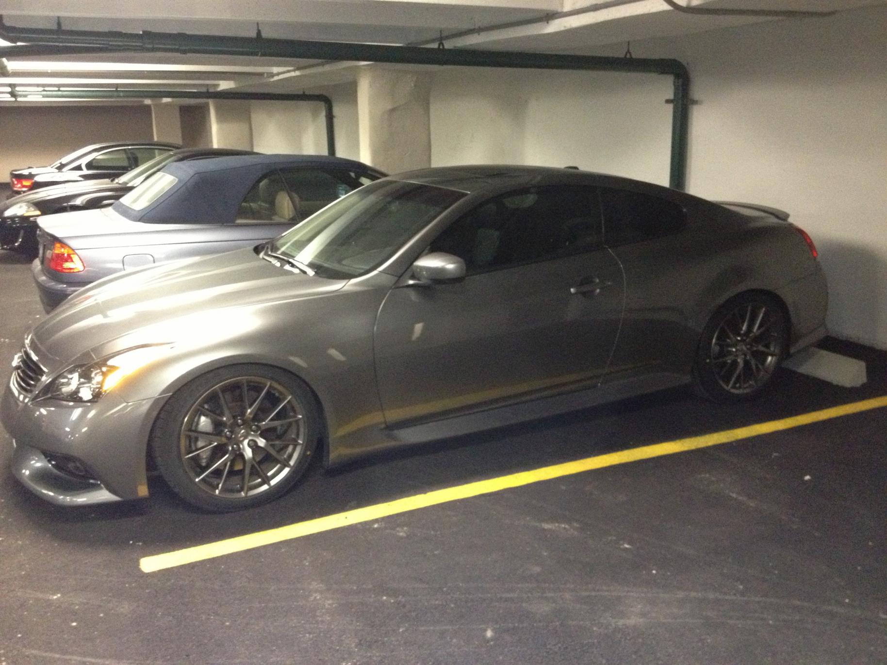

Here is a pic from the other side. This is really how low I am. I dunno why the other side looks so much lower in my parking spot. Everywhere else it's the same on both sides. It's like one of those skinny mirrors in the women's changing room at Saks. I'd say I'm right at 2", but who knows...

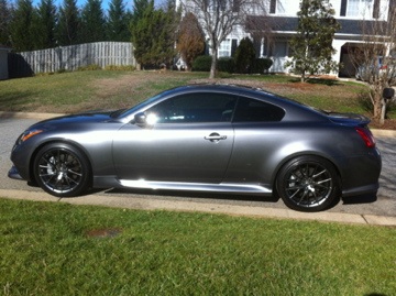

Here is an IPL on swift I dug up for you. I've seen swift once in real life, and it looks like the height of a stock 328i. That's 1.2 in the front and .7-.8 rear. I'm probably 2" in the front and 1.7" rear. The rear on our cars has much less gap than front.
The swift springs look much better in my opinion.
