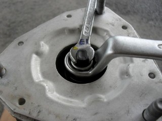

Thought I'll add a pic. I found a 8mm open ended wrench to be suitable for holding the center rod in place without deforming it. (it's really soft)
Congrats on the OP on getting it off.

Good photo, that's exactly what I was describing in my earlier post. I simply used a ratcheting wrench so I could actually turn the nut easily while holding the rod in place without having to remove the 8mm open end on top to reposition the other wrench.

Interesting. Definitely some good information! Thanks. Didn't think a 8mm would fit so well. I sure need some ratcheting wrenches in my life..they are a life saver.
