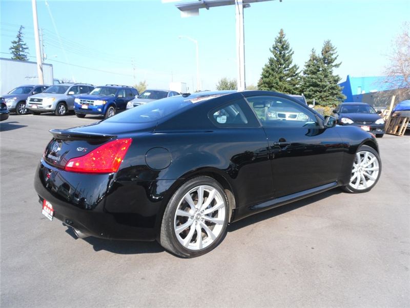

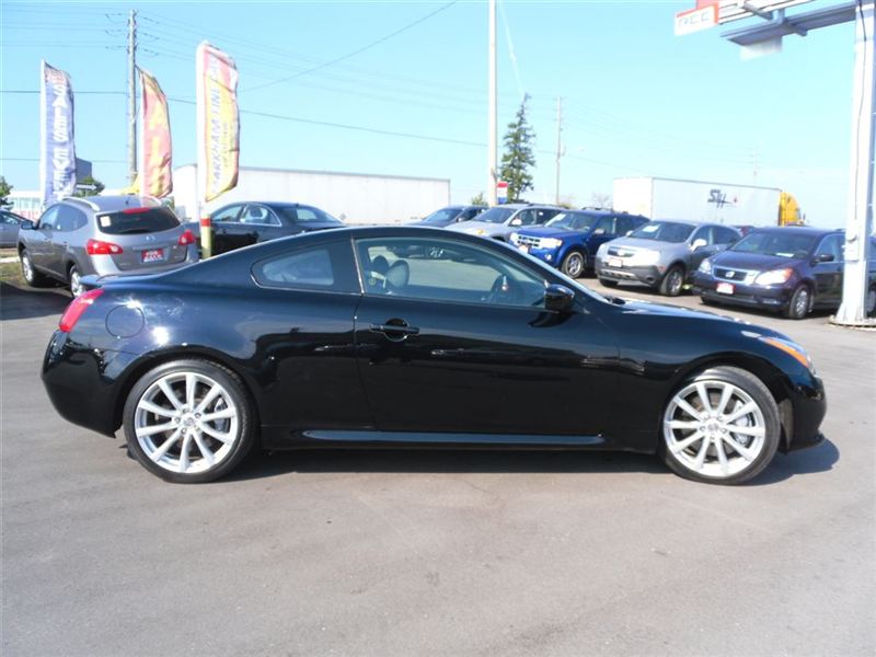

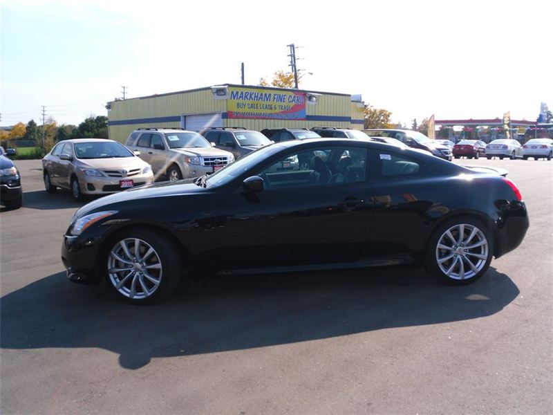

P.S I also attached a few pics of the car from a Dealer. I will take more pics when the car is delivered.

I didn't even know that Magnum MAKES rotors for the big brake kit on your G37s. Sorry, but I think NEXTMOD got it wrong (they do that sometimes). I called around some Infiniti dealers in Toronto and ran my VIN. The service techs told me that for some reason parts lists got screwed up on some early gen Gs (like mine and yours), and they don't show as having big brakes, when in fact they do.

Ah I finally was able to view the pics on the computer. Yes, you have the akebono setup so you want either the g37s or 370z sport rotors (same thing).
