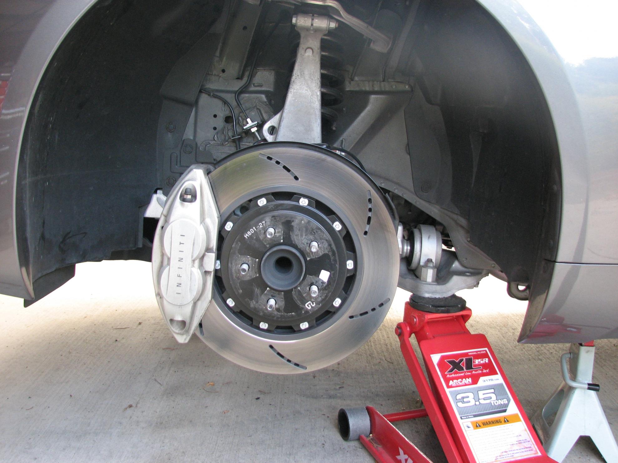

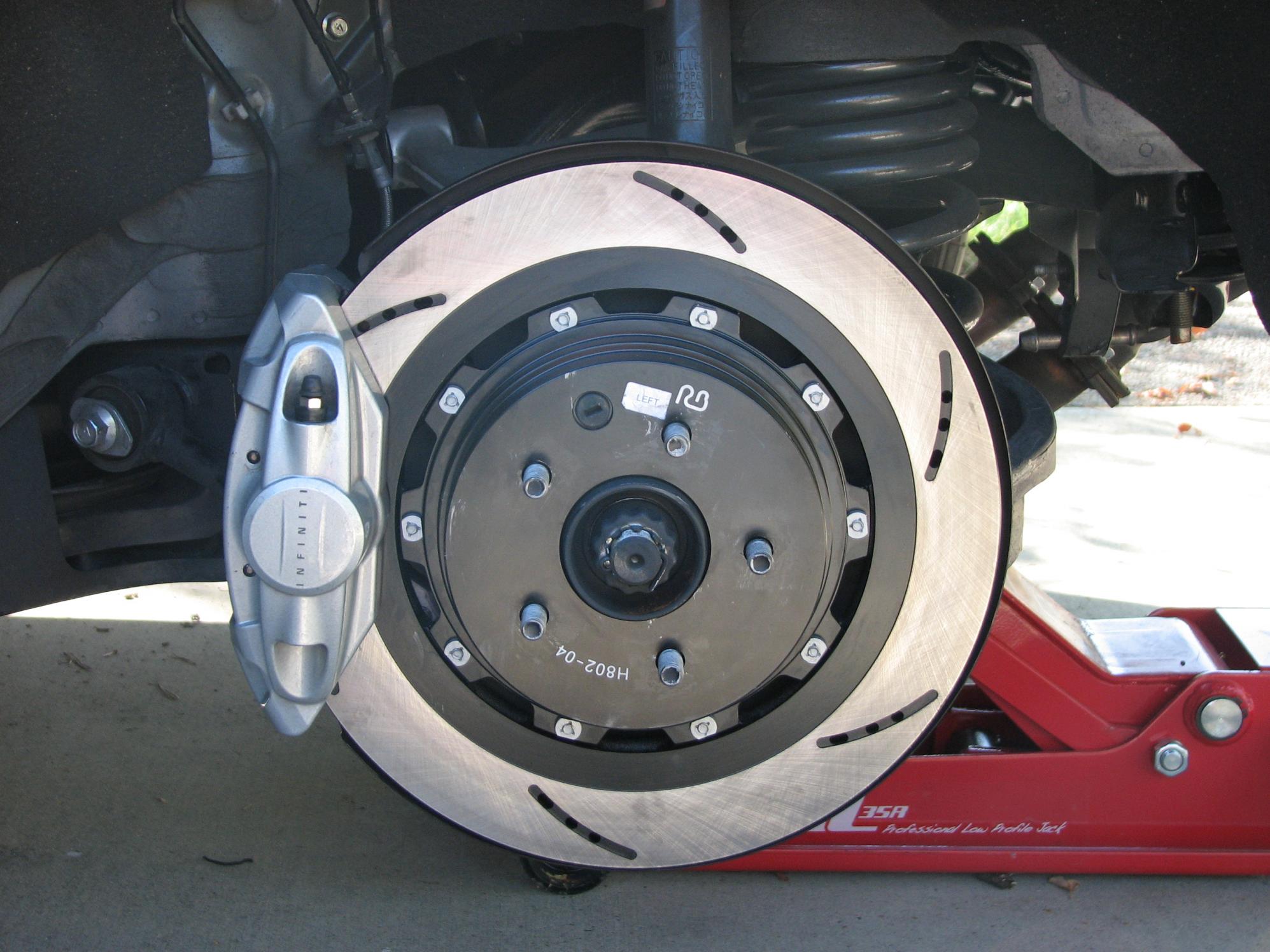

Final Install
Here's what they look like on the car while still on jack stands. After a little trimming to fit the rear backing plates, everything went fine. Performance on the track was great and will be even better with a better street/track pad combo. No fade however no matter how hard I pushed them and great pedal modulation. By the way the pictures were taken on two different days. The fronts after track duty and the rear before track duty and newly installed. I saved 5 lbs. per rotor over the stock ones and the curved vanes and drilled slots definitely helped keep the brakes cool during tracking even with the heat/dust shields still on. My last exercise will be to get rid of those shields when I have more time to do so.
