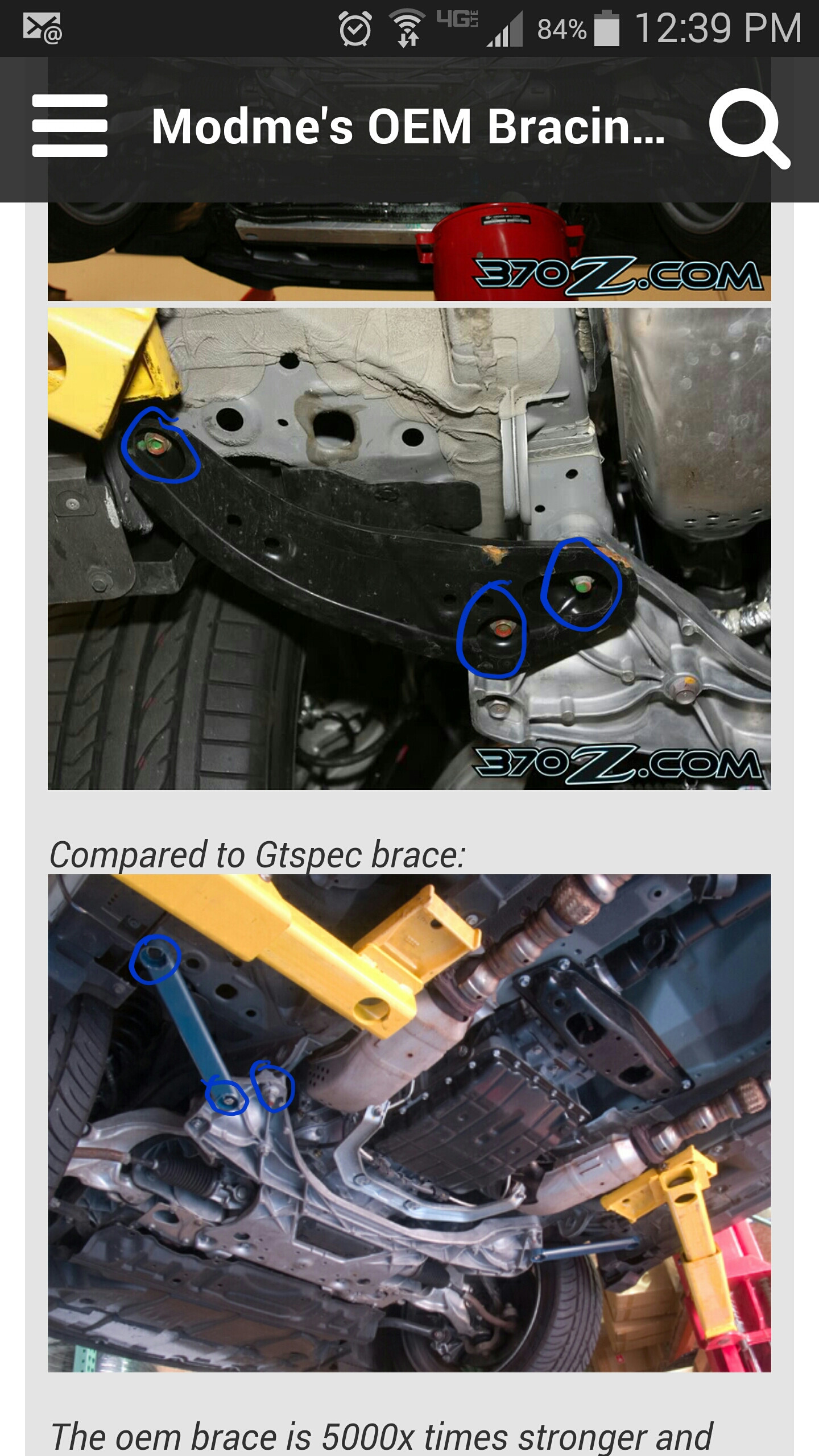

I won't be pursuing this Vert Cradle Brace mod until Spring at the earliest. Doesn't make sense to me installing a suspension mod in the dead of winter riding on snow tires. I don't think those conditions contribute to making a fair assessment of changes in the car's handling. But I am planning on an Auto-X event with a buddy this Spring, so before then, certainly.
In the meanwhile, sure would be great if someone with a Sedan, in a warmer climate...
Love to understand that batwing part better, too.
The question about fitting this up to a sedan has been asked several times with no answer. Do sedan owners just need to confirm hole spacing for the 3 bolts?

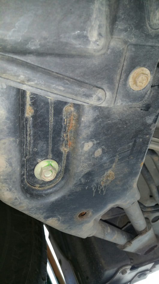

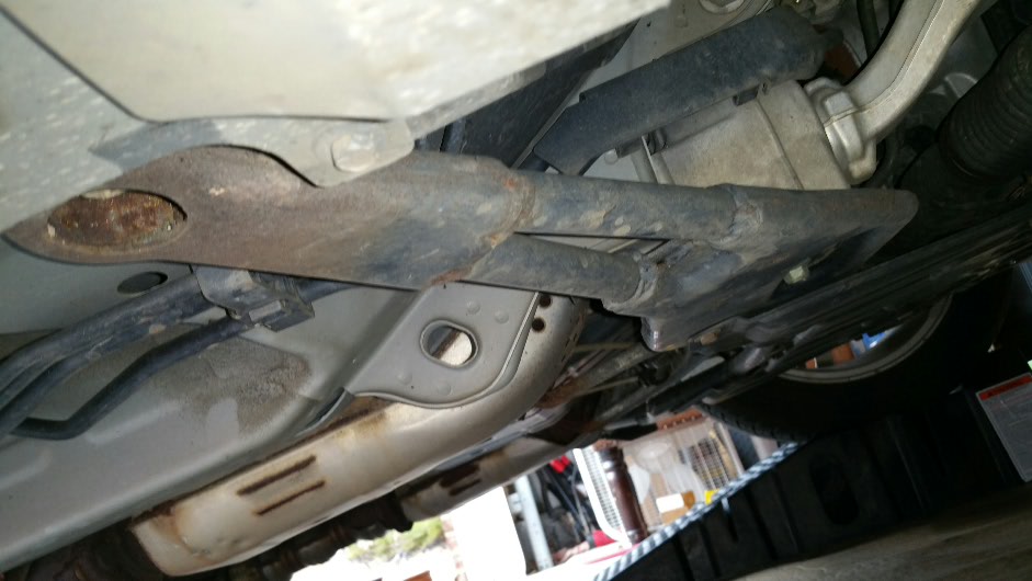

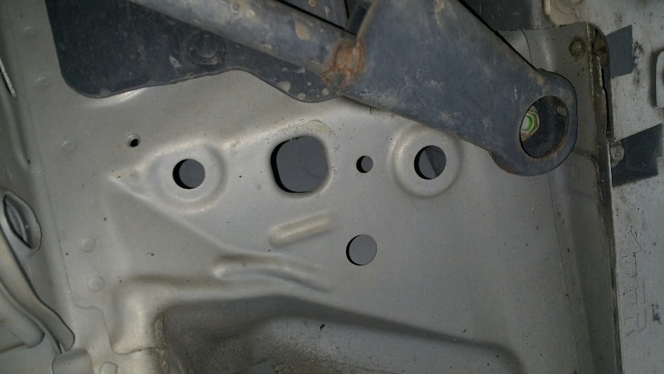

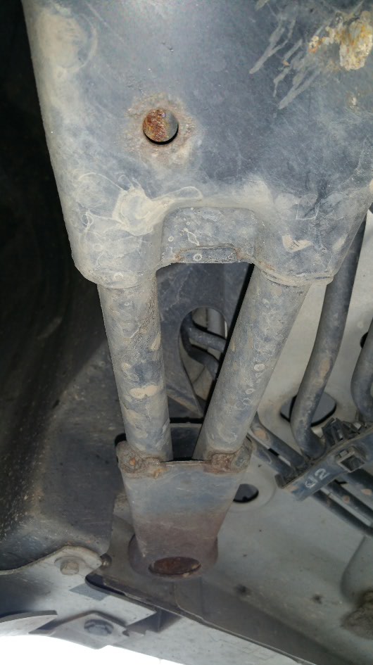

It looks like the awd has some extra bracing. I couldn't get an entire shot of the area as my ramps only let me get so far from the subject, but these should give you an idea of the awd bracing and attachment points. I'm not certain, but it looks like the same points as the coupe.
However, it looks like a different piece. Not sure if they put a cover over that shiny silver piece you see in the coupe images and the brace is all one piece extending from right to left. I didn't take off that splash guard which covers this area when I took my photos. So I don't know of the black brace you see is in lieu of the silver thing with the 2 attachment points on the coupe, or if it goes over it.
Modme's OEM Bracing Project-nzzxuis.jpgModme's OEM Bracing Project-ukkvv9s.jpgModme's OEM Bracing Project-ar6qsuk.jpg
Its different, but same function, and beefier!

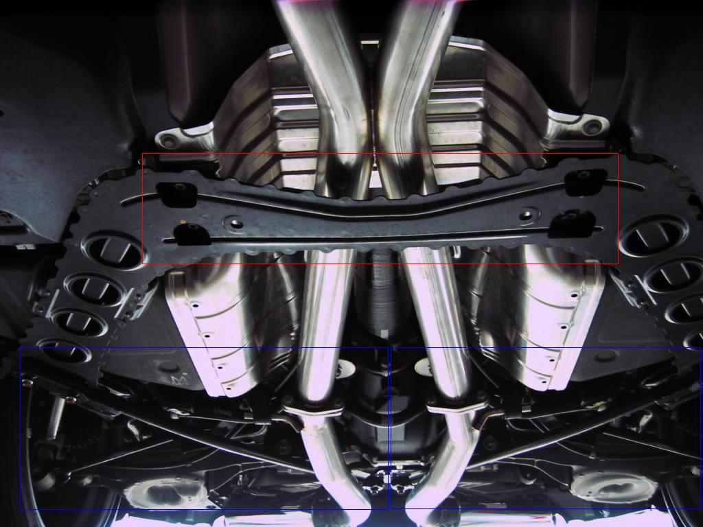

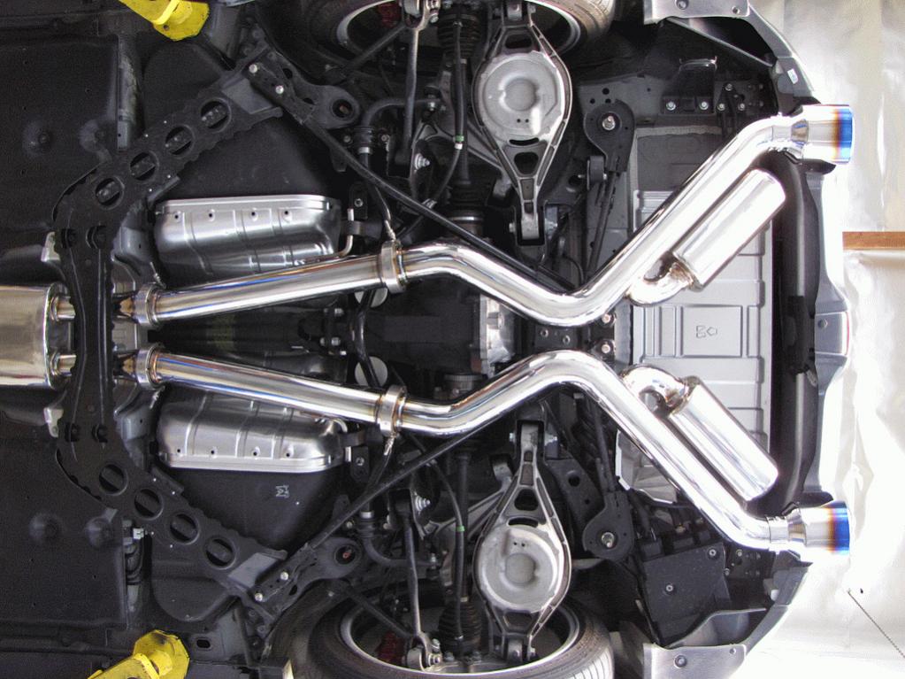

Couple of pics of the batwing on a 350 and a 370Z--they have these braces as well--for perspective.
Note the additional braces boxed in blue on the 370 pic.
Link to removal discussion: Removing subframe brace for exhaust, need help urgently - Nissan 370Z Forum
Don't the AWD Gs have a different front suspension than the RWDs?
Attached Thumbnails Modme's OEM Bracing Project-350z.jpg   Modme's OEM Bracing Project-370z.jpg

But, there is some difference in the front suspension because 370Z Koni Yellows only fit the RWD Gs. Which makes sense, because there has to be different packaging to fit a front differential and other hardware into the X. I'd be more inclined to try the RWD 'vert braces.

FYI, I messaged the guy who was selling that batwing on the forum. It was off an 08 'vert and the mounting holes did not line up with his '11 IPL.
So caveat emptor.....
