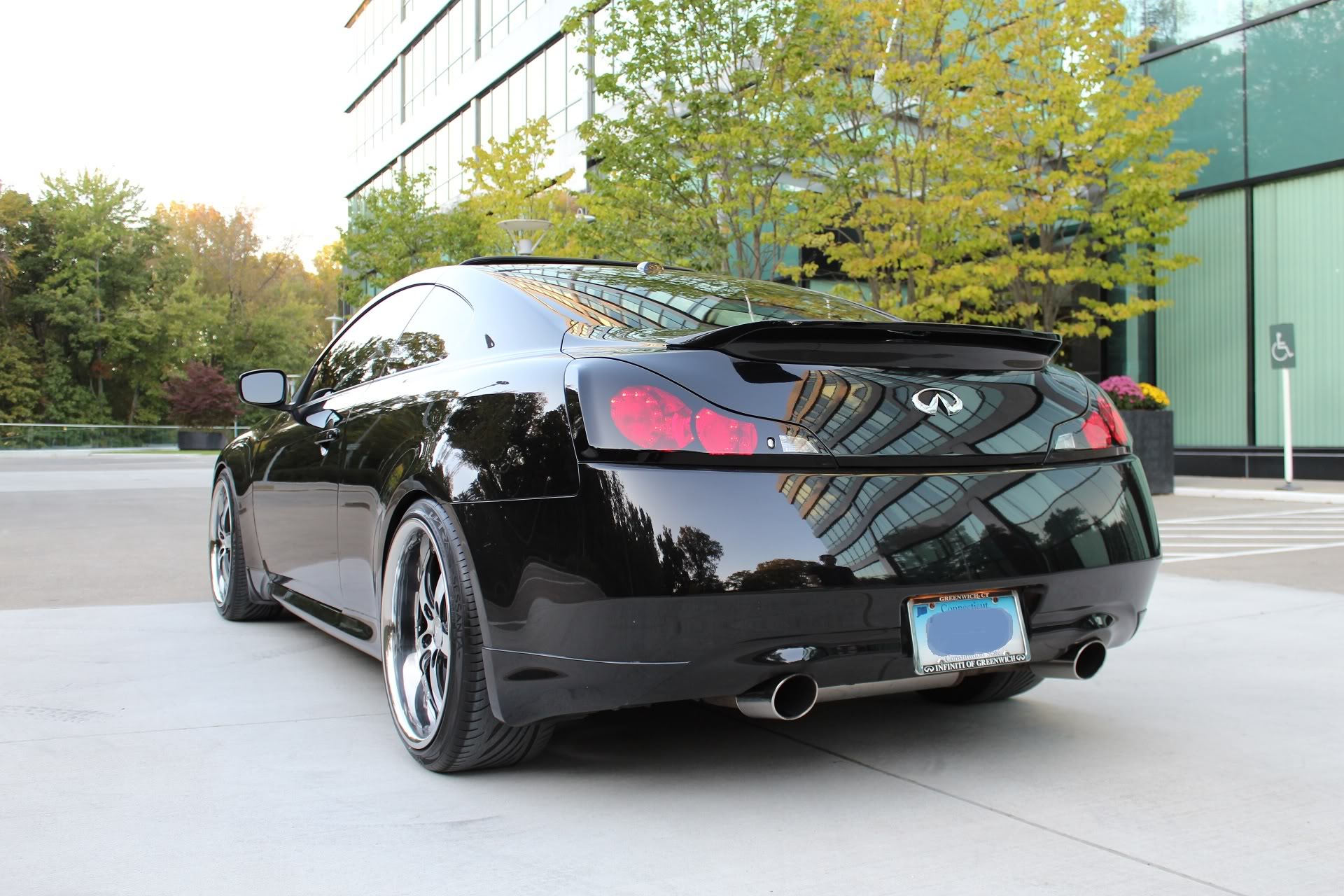

Hey Guys,
Is this kit a good idea for my G which is dropped on Eibach springs w/ 15mm spacers all around on Vossens?
STILLEN : Eibach Pro-Alignment Kit ????
Last year I went too long without an alignment, and unevenly wore out my 2 front tires I'm trying to prevent this from happening again, without breaking my bank. Your thoughts are appreciated.
-DC
edit: right now, after alignment, my front camber is -2 degrees, my rear camber is -2.3 degrees. This is my daily driver.

DUDE...that is a great shine on that thing...what do you use? I would love to see more pics.
Thanks man, here's some older posts of pics:
https://www.myg37.com/forums/picture...est-shots.html
https://www.myg37.com/forums/picture...ails-both.html
I'm starting to think that these spacers will be my demise :/ Had some minor issues since getting them.
