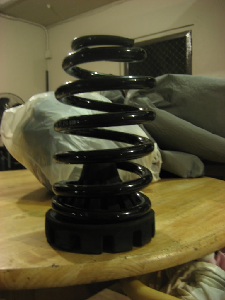

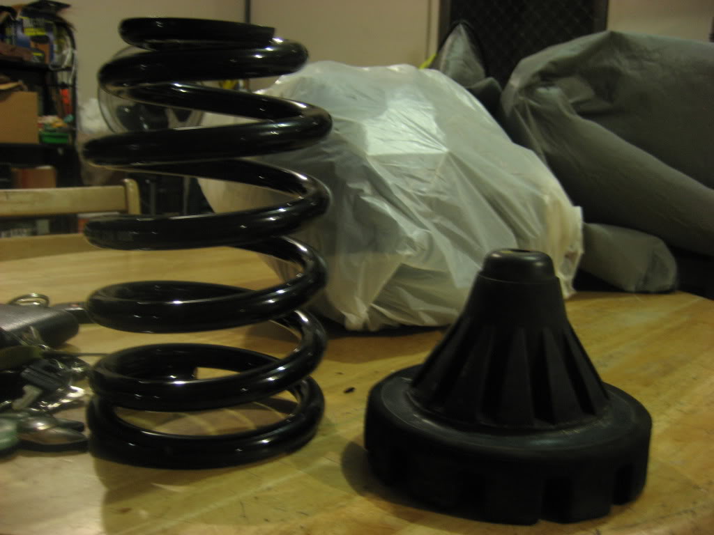

Are you adjusting the rear strut height too? If you are only adjusting the spring height, you have to adjust he stut along with it. I just adjusted my Megan coils last night and had to do this. But you are right, even all the way out I can only get to about 26 3/4" from the ground to top of wheel well.
If you still want to get more height read this thread her how to raise the rear of my megan coilovers.... - Nissan 370Z Forum especially post #7
He reused the old rubber spacer from the oem rear spring to help get more height that he was looking for. I don't know if the setup is the exact same on the sedans but it should have something similar.

Wakeboardr, you are better than google. I had searched and searched for a solution using every possible term I could think of. Of course, all of those searches included "bc racing".
I did what was suggested in the forum/pics you posted and I am now dropped about .75".
I am probably going to wait for another week or so and maybe drop it a bit further but not much over an inch. The ride seems unaffected so I am happy. I have the improved handling characteristics I was looking for!
