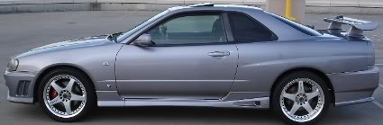

Nice . Where's the R34 now?

Thanks
Sold to fund the new toy. Kind of miss it but after the v36 there's no way I could go back
