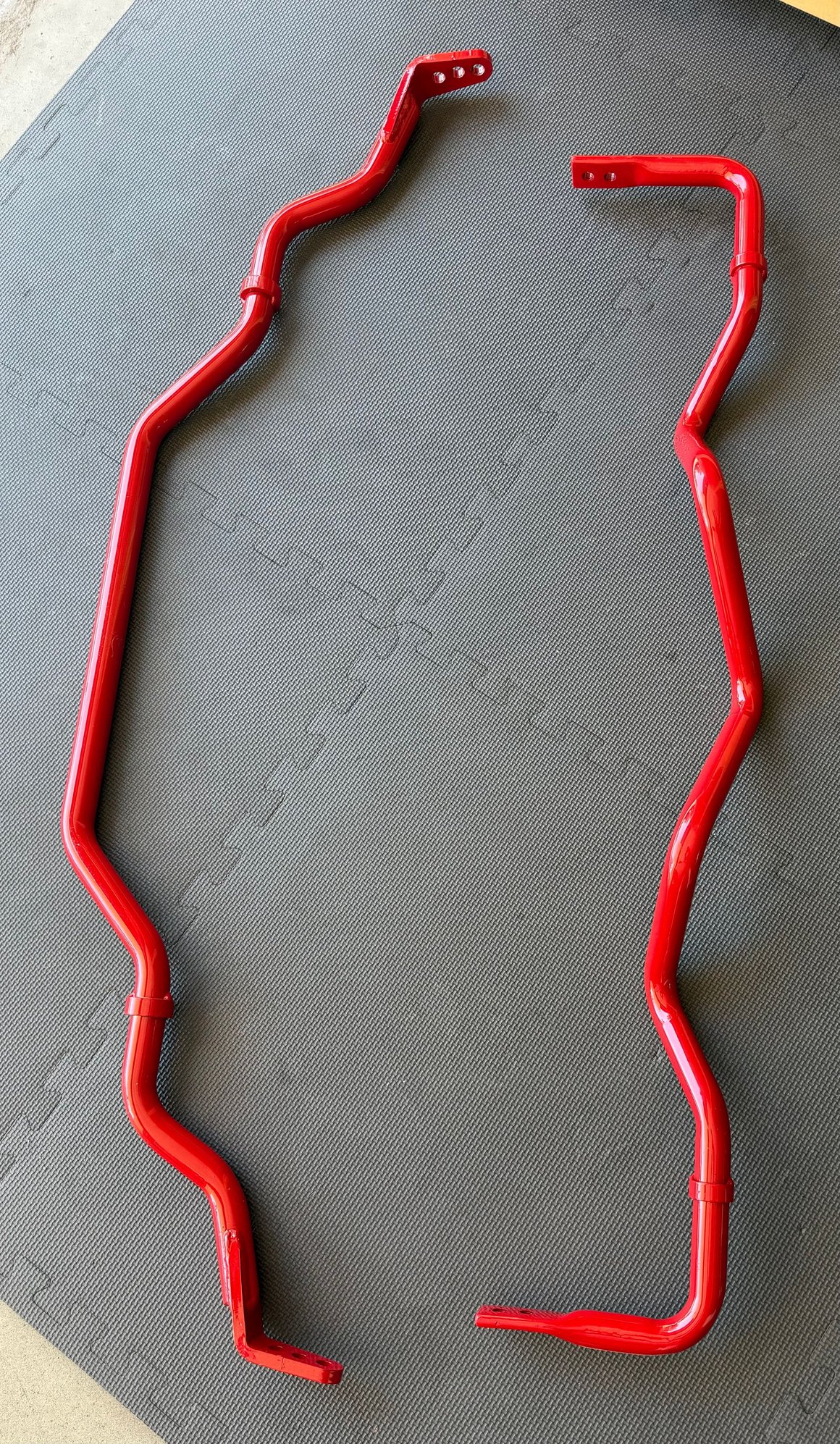

My Stillen Sway Bars arrived today. Ordered them the first week of June through Concept Z as they price matched Redline 360 (no shipping cost, veteran discount, etc.). Recall that these are the same diameter as the 370Z Nismo and IPL bars, but adjustable up to 48%(F)/70%(R) higher than those OEM versions. The G37S RWD OEM bars (purple marks) are the same diameter as those found on the 370Z base model.
I share additional details on the bar diameters across models and vendors topic here (#10380): https://www.myg37.com/forums/g37-sed...ml#post4339226
One can learn more about the Stillen Sway bars and their philosophy on bars within the Stillen 101 blog here: https://www.blog.stillen.com/stillen...ide-sway-bars/

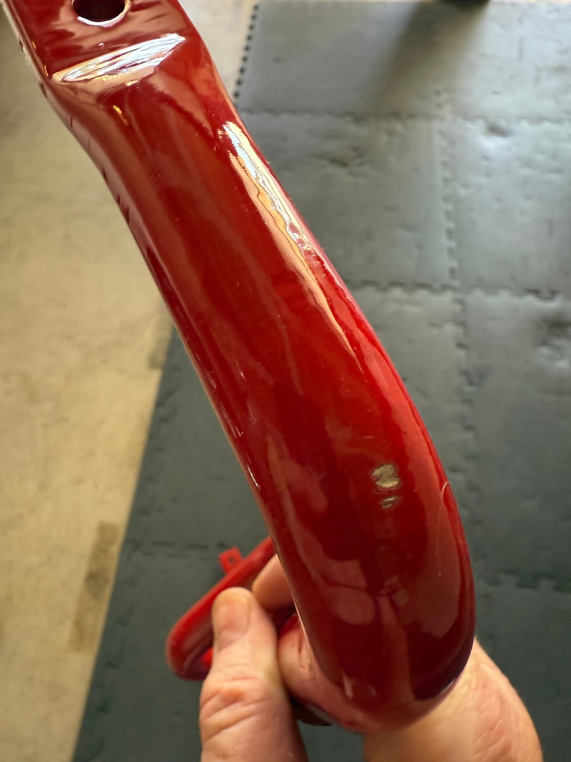

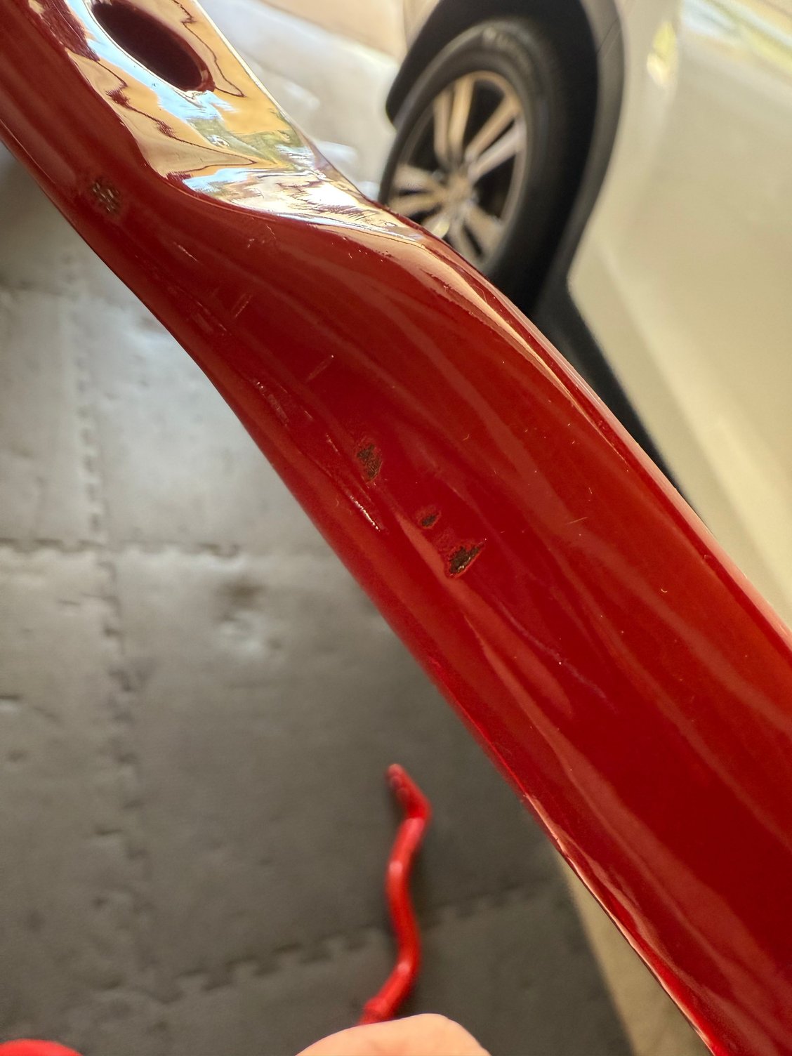

Stillen said due to high demand, they were out of stock and a new batch needed to be made. The box they shipped them in was huge and very sturdy, however, the bars themselves were only in basic plastic bags (not bubble wrapped and no Styrofoam inserts), so they banged around in the box during transit (so much so that I heard them clanking together when UPS dropped them off). The chips aren't game changers, but still a little disappointing.
In the coming weeks I plan to install them with my new OEM end links and sway bar bushings (the Stillen bars use the OEM version of both). Per the research I've done and discussions with Miza at Stillen in Costa Mesa CA, our platform tends to respond best with the front bar set to the middle setting (34.5% stiffer than the G37S RWD OEM Front Bar) and the rear bar to the highest setting (70% stiffer than the G37S RWD OEM Rear Bar). As such, I will start here and let you guys know the verdict as I have resisted this upgrade forever since I felt my car had almost no body roll and handled well with the factory OEM bars.

It was probably disappointing to see those chips in the powdercoat because of the careless packaging, but you're right that the correct approach is to just move on. There were be more over time during use, so don't sweat it. No one is going to see them unless they get down real low in the rear.
