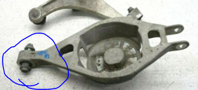

Does anyone know if the bushing in the lower control arm is replaceable. I had a bolt seize in it and it is not coming out. Could someone also comment if the lower arms are different among g37 models? I have a g37x coupe.
Thanks

Could possibly work. The majority will just replace the whole bucked since it isn't all that expensive. If you are to replace just the bushing you will need to do it on the other side as well since they are Polyurethane. As far as if they are all the same, I would say yes but someone can correct me on that, not 100%.

I picked up the whiteline bushings and they don't fit. I have the old one pressed out, but the diameter of the news ones are a bit too large. Maybe I will try to freeze them
