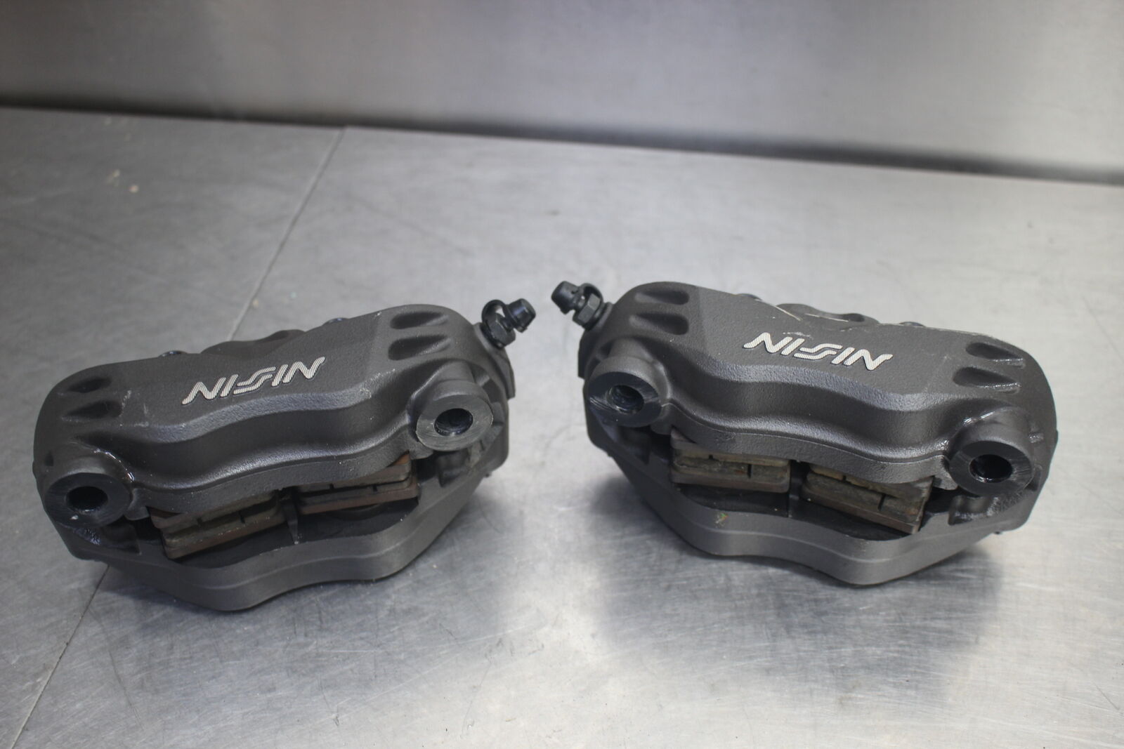

It's a fixed caliper, one bleeder for each side it appears.
I just looked at some motorcycle fixed calipers. Looks like those use a single bleeder for both. I suppose one does the bleeder furthest from the brake line first.
from a 2012-2015 zx14
Caliper/system flush hints-9p1tgei.jpg

I'm not finding good pics of them, but the FC3S T2 and FD3S RX-7 calipers are fixed 4-pots and have only a single bleeder. I think it depends entirely on the whims of the engineer involved.
