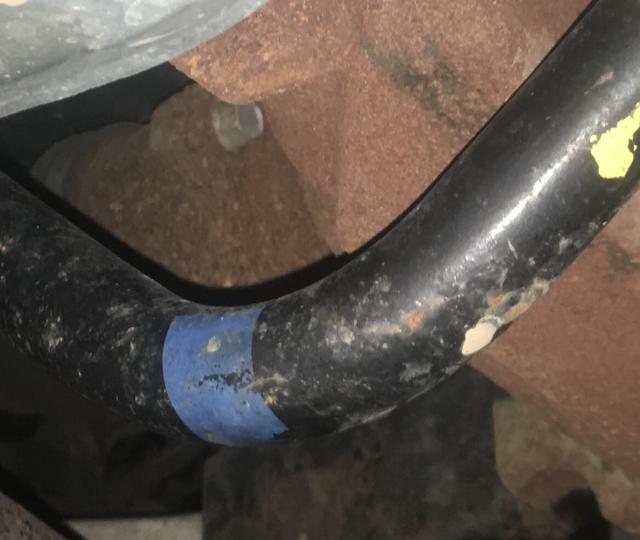

A few on this board have found just about the perfect rear bar for a X sedan is from the coupes or 370z Nismo. They are identified by being about 25.5mm in diameter and have a blue stripe on the middle jump as seen below. I picked mine up for $90 on eBay, but you could check with that G/Z chassis dismantler southwest of the TC. You can find their ads on CL. I’ve never used them in the past, but might be worth a shot.
Rear bar marking:
Rear bar marking:

Rear bars from the same model can have different color paint depending on the year. I don't know what exactly the colors mean. Different rate? Ease of matching for the assembly line?
I have blue, confirmed at 25.5mm, from a 2016 370z Nismo. From my research, same as the IPL as well. Same bar as the all white Nismo bar available from the parts counter.
There is a lavender bar out there, same as the lower model 370z and G37 rwd sport/non sport sedans? Don’t know dimensions.
orange is the stock AWD bar and is 17mm.
I could be wrong but haven’t found people willing to grab a caliper and get an exact measurement and color of their bar. Would be an interesting database to comple to figure out cheap upgrade options since these cars are trickling to the more DIY crowd.
The rear bar off my sedan S had blue paint and it measured 25 mm. Could be 25.5 mm, my calipers are pretty cheesy and it was a couple of years ago that I measured it. So, again, paint could be rate or it could be for easy matching during factory assembly.
