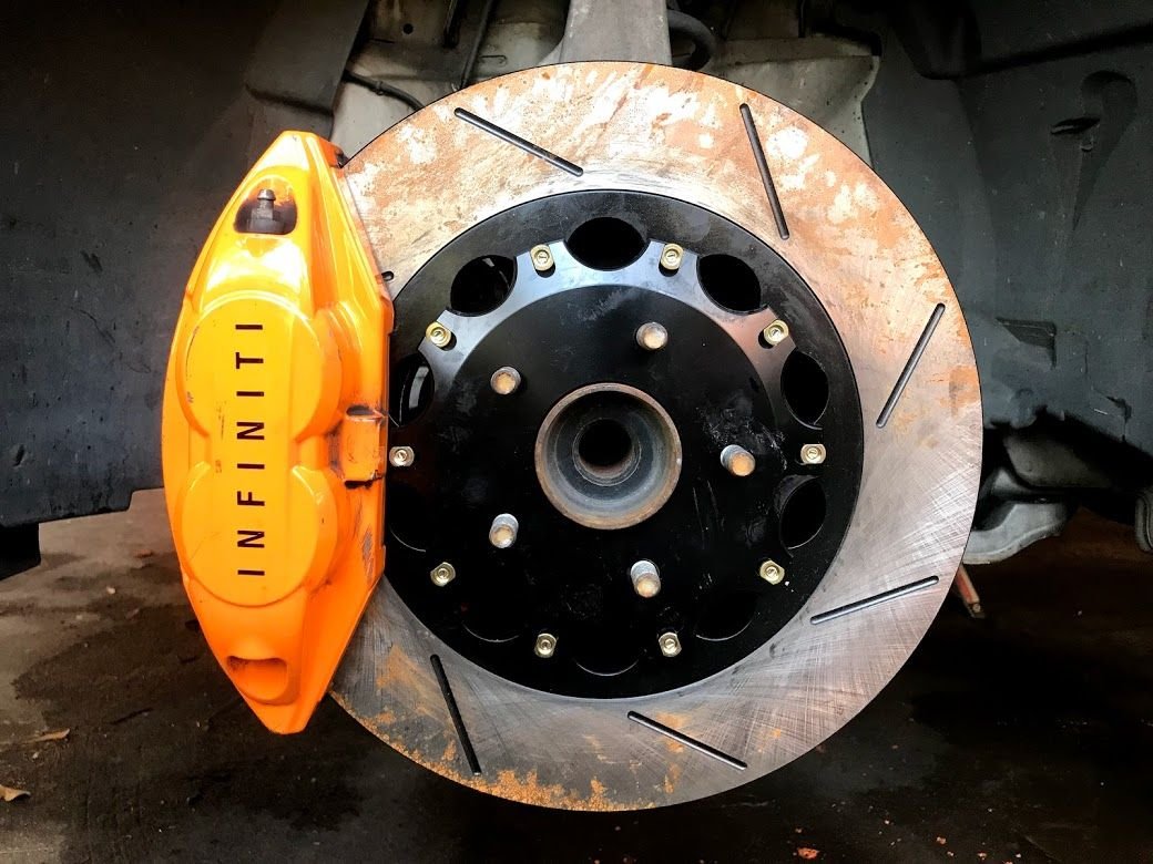

Z1 2 Piece Rotors - Fronts
I needed new rotors bad since my fronts would vibrate during braking. I thought about keeping it simple and just go with OEm replacements, or 1 piece slotted, but figured I wants to splurge and bit the bullet to buy Z1 2 piece units during Black Friday.
In agreement with the other reviews, feelings, and experiences with this product in the front, shedding the weight made a huge difference in the driving feel; increased response and feeling more nimble and easier to steer the car. I opted for the slotted rotors as opposed to the popular sprinkle. I wanted a simpler look but still wanted slots. installation was as simple as remove the old and reinstall the Z1. No problems with thickness' or clearances, even with new pads.
Z1 2 Piece Rotors - Rears
I mentioned earlier, I bought the rears during Black Friday to maximize my savings. However, I was sent the incorrect hat. I received one for the 2017+ Q60. The difference is in the diameter of the rotor hat, with the Q60 being larger. I did not realize this until I adjusted my parking drum to the ,ax and it still didn't touch the hat. After making a trip back to Z1, Jon was super koo to help me out and swap to the correct one for a G37. Got home, slapped that bish on, adjusted my parking brakes, and I was good to go. Same with the fronts, clearances and all was spot on and I have no issues with new pads.
Excuse the rust, the fronts sat a couple of day while I was trying to figure out teh rear rotor situation.
This pictures is with the Q60 rotor hat. Everything bolts up fine except the parking brakes won't make contact.
