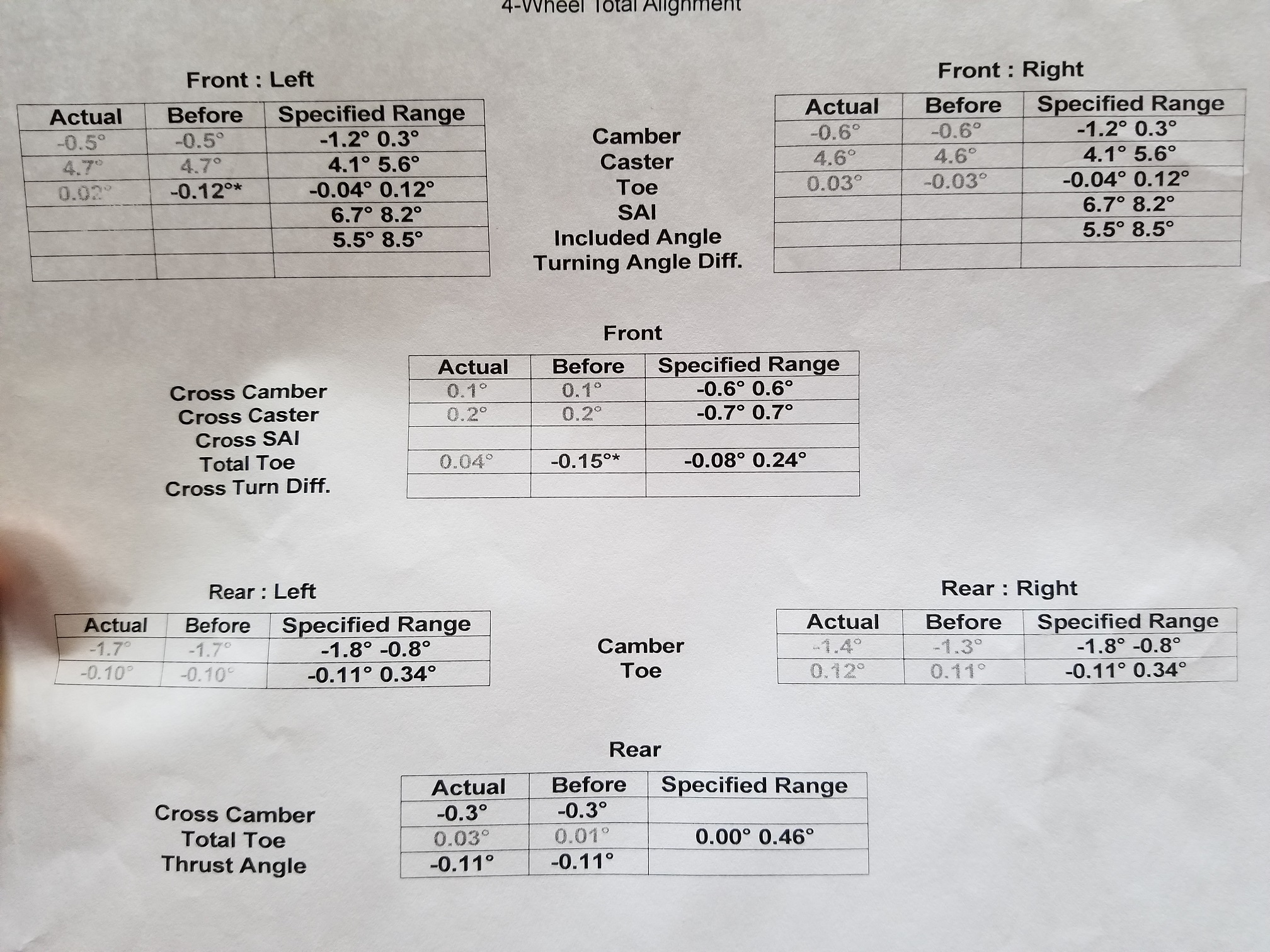

I have also attached my last alignment specs

In re alignment, you really want rear thrust angle as close to zero as you can get it. This generates a crab angle that can upset handling if large, besides looking goofy.

Thankfully the situation has been resolved, my right rear damper was completely shot (surprising for just 50k miles) so my mechanic replaced both rear dampers last week with new OEM dampers. The ride is much better now but I still need to get an alignment done which I should hopefully sort out this Thursday.
Thanks for the tip regarding the thrust angle. Did some reading up based on your suggestion....my left rear toe is -0.1 (toe out) and from the info I've gathered that shouldn't be especially as the right rear toe is 0.12. That's probably why the thrust angle is -0.1..smdh.

I had an alignment check today and nothing was changed as everything was in spec (Thrust angle is now -0.02 which is fine) so the busted dampers probably contributed to the original alignment issues as pointed out by Slartibartfast.
