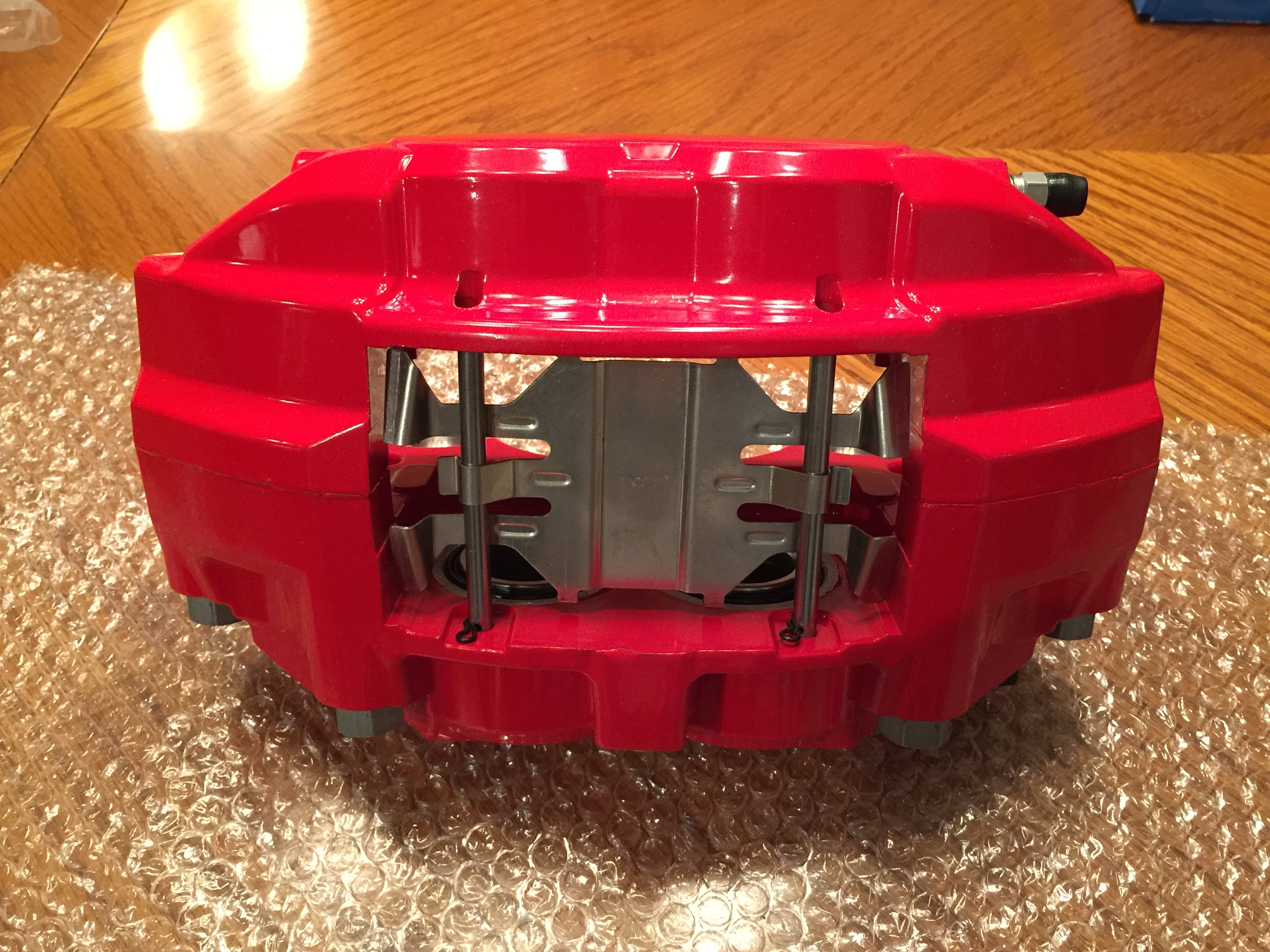

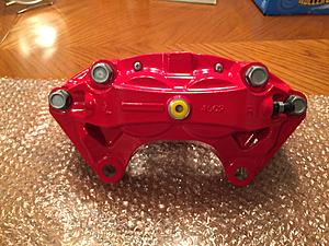

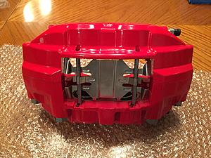

Attached a few shots of one of the front calipers. I'm no expert in powder coating, but it looks ok. A little thin over the raised numbers and letters on the back, but nothing chipped. A few minor flaws in the coating, but nothing to get into a twist about IMO.

One more small hiccup. If you look closely at the first picture I posted above, of the front of the caliper, and zoom in on the caliper mounting points you may notice something important is missing. Yep, the thread inserts which have, you know, the THREADS in them.
