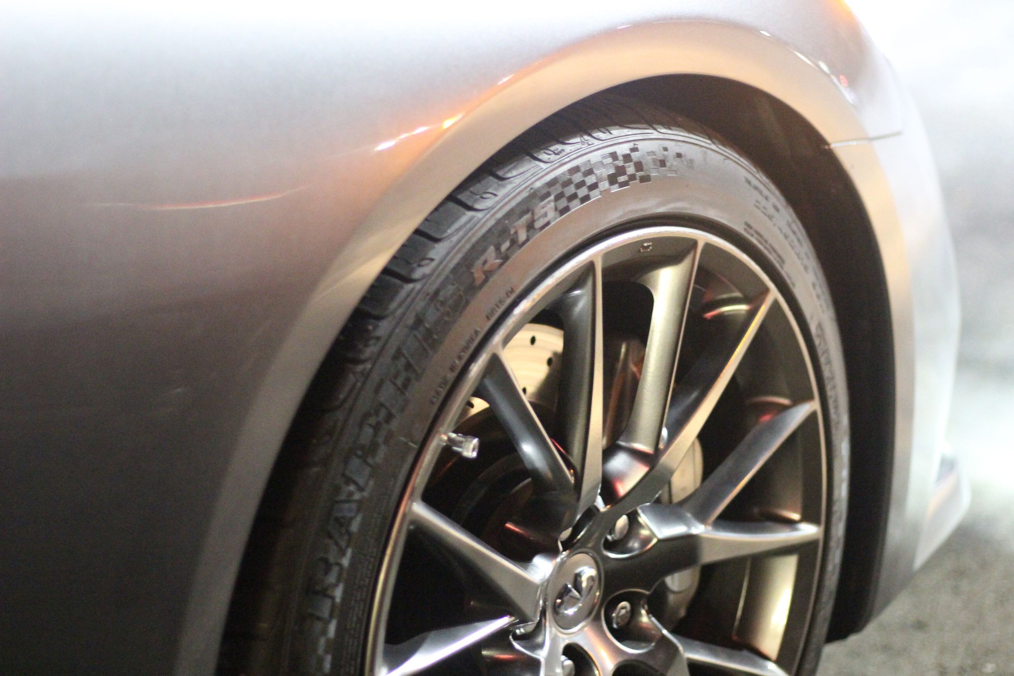

Hey @usechapstick, I just installed my Eibach pro-kit springs for my IPL. If you're still sitting uneven I'd say take apart the springs and make sure they're lined up with where the fittings for the struts are. Mine was uneven for about 3 days but then finally settled after a week or so and I'm getting it aligned soon. I measured with my fingers lol but the first 2 days, front passenger was 3 fingers gap while front driver was 2. Rears evened out immediately. And I'm also on H&R 20mm spacers all around.
Front passenger night after install
Fully settled front driver
Fully settled rear driver
