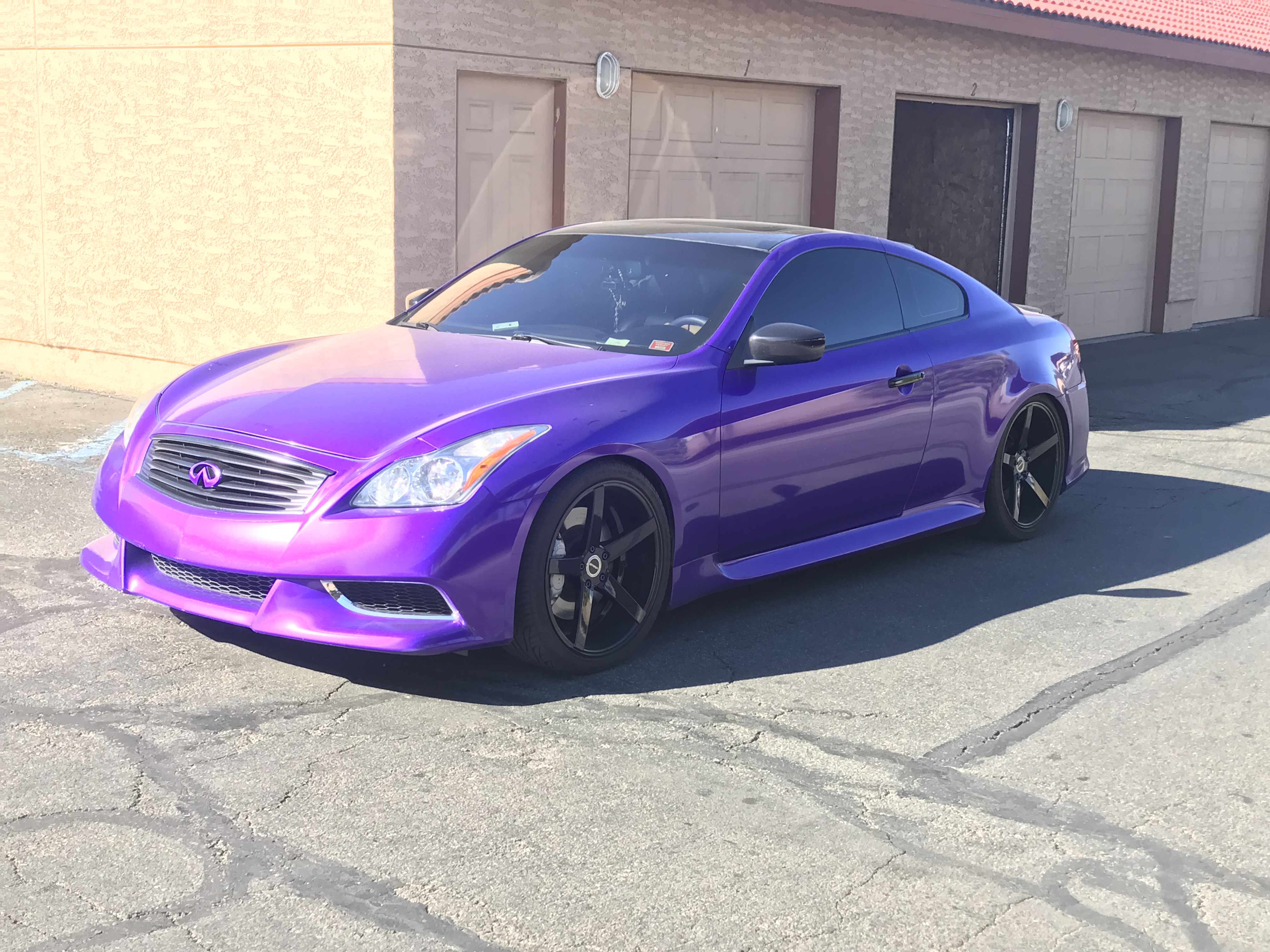

Here's what my G37 looked like before the install (Don't mind the sunshade lol):
Rear is sagging after installing KW V3 Coilovers. What are my options?-before.jpg

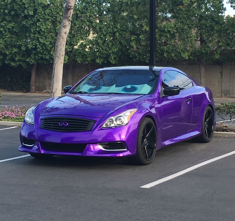

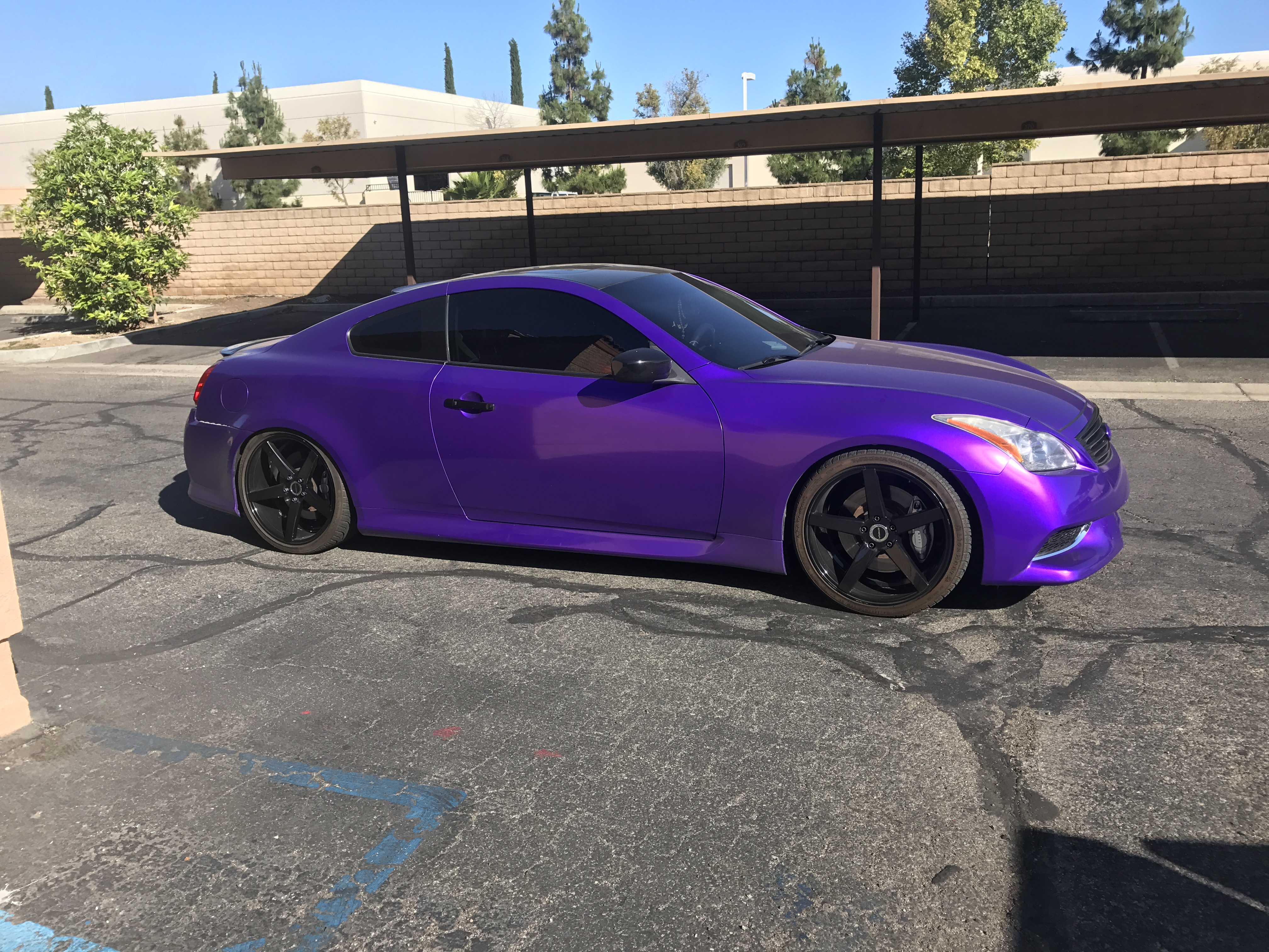

And here's pictures I took just this morning (Sorry it's not clean and shiny):
Rear is sagging after installing KW V3 Coilovers. What are my options?-after-1.jpg
Rear is sagging after installing KW V3 Coilovers. What are my options?-after-2.jpg

It looks like you may have been sent shorter rear springs, I've not seen coupes that low on KWs when set to the highest point (the sedans this is a problem, but even for them that's real low). You might try to confirm the spring length, hopefully there's a part# stamped on them, if they are correct then an extender from KW would be the plan.
