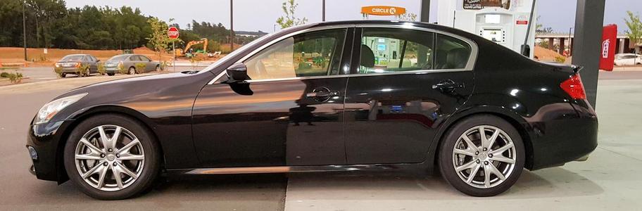

I went with Basis Zs. They are a little soft though. Where do you live? Don't have to give the exact city, just the area. I'm in the Southeast and the roads are smooth, so they ride great.
One thing I will say is the shocks seemed to need like 50-60 miles to break in. When I first put them on they felt a little harsh, but now they are downright plush. I am pretty low too; I think I'm at 26.5" all around on a full tank.
