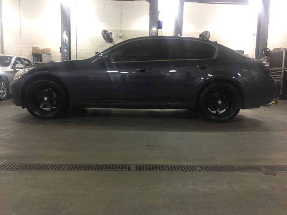

Affordable Street Coilovers on an X.... any reviews?
Seems like X's are much more challenging to shop for than the RWD's.
What I'm looking for personally:
  1. 1.5" front drop, 1.2 rear.
  2. Comfortable for dailying if adjusted properly. I'm looking for a near stock quality ride.
  3. I'd like coilovers that I can basically ride near stock height on the highest settings (optionally at least).
Not looking for anything for serious racing, maybe something decent for an auto-cross but that's about it.
I don't think I could go down much further than the above measurements, I got some beefy tires.
As far as why coils over just springs? Well my car has 116k miles and I really don't want to throw some springs on high mileage struts. Buying Struts and springs would be about the same as some coilovers so it seems less wasteful.
Thanks fella's!
Pic for what I'm currently dealing with I attached.
