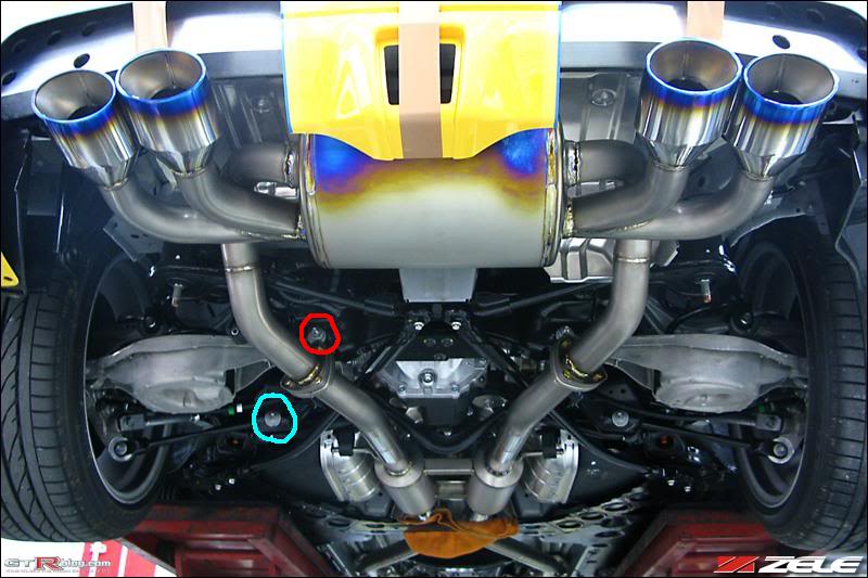

If you found bolts under your car I would at least get you car on a lift or jackstands and have a long look around, compare one side vs the other to see if anything is amiss. The rear camber and toe are adjustable, not a lot of adjustment range but there is some there. There are a total of four bolts (two on each side) that are offset mounted into a washer that when rotated will slide along a slot to adjust the camber & toe. If one or both of those bolts broke on one side it could cause a very significant change there. I would NOT drive it until you can give it a good look.

This is a Z but it's the same on your G, the red circle is the toe adjust bolt, the blue circle is the camber arm adjust bolt. Definitely get a full visual account of everything prior to considering an alignment.
