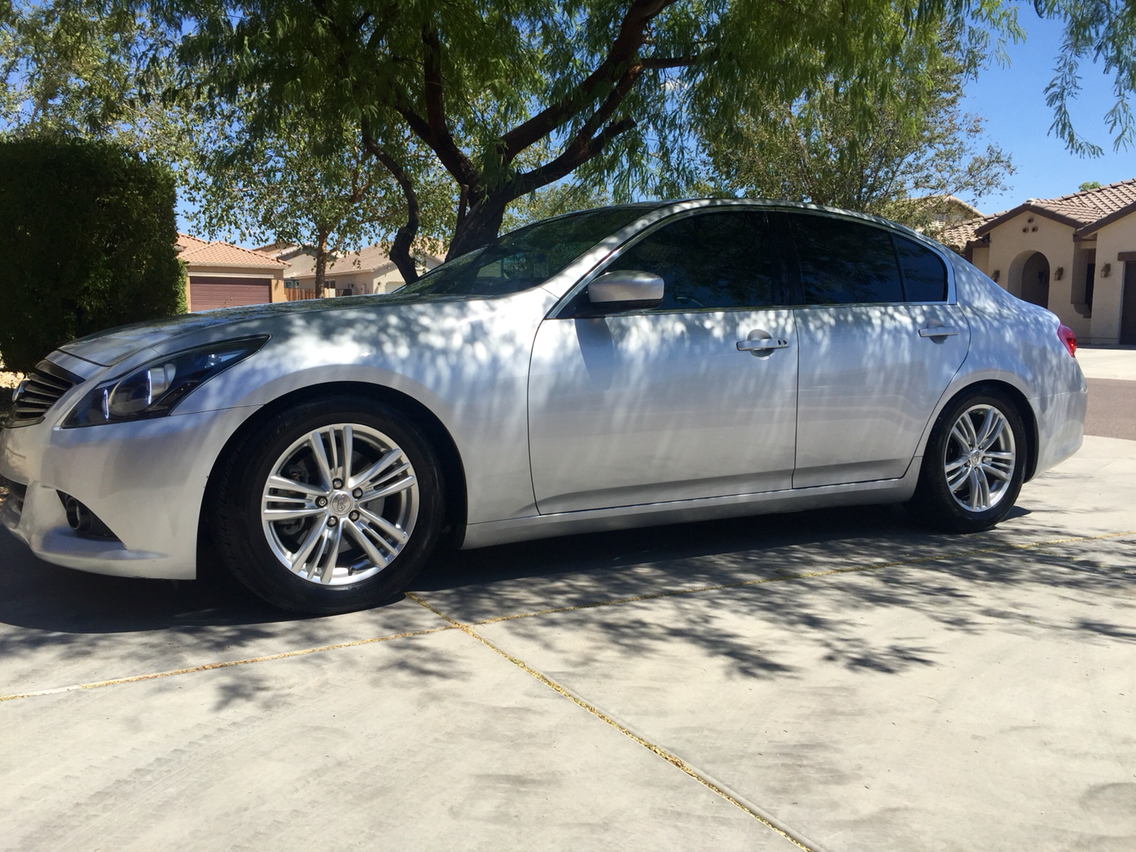

Old Aug 31, 2016 | 04:09 PM
Ricio1991's Avatar
Ricio1991
Joined: Jul 2014
Posts: 1,301
Likes: 113
From: Tempe,AZ
Swift Springs for sure, no camber kit req
