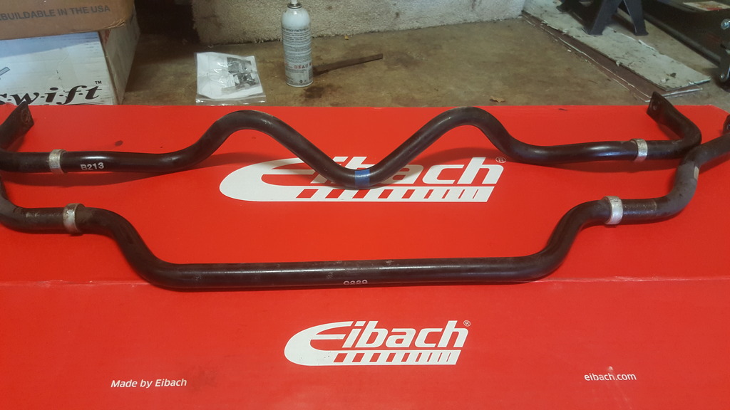

Ipl rear sway
My ipl rear has the blue line but different numbers than the coupe and is fs too.
