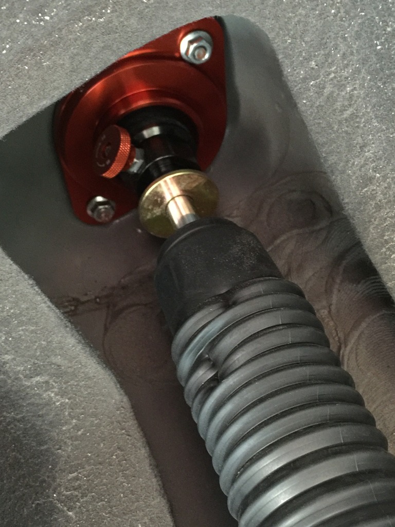

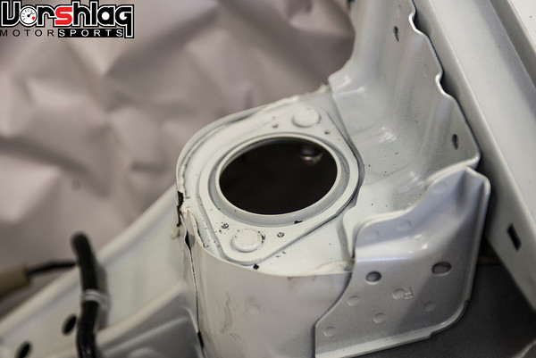

Here's the 370Z upper mount. If the top sits just below the plastic, the entire adjuster may poke up. It'll be a pain but I'd take the plastics out and check thoroughly. Take lots of pics.
