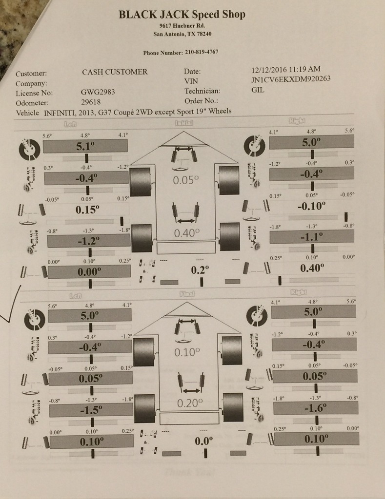

Alignment was a success yesterday and I have very conservative numbers all around. I'll post the alignment sheet in a bit. I may have them add a bit more negative camber but I'd like to go without replacing tires once a year. I drive between 8-10K per year these days, mostly highway.

Here's the alignment sheet, current specs are on the bottom (checkmark next to it):

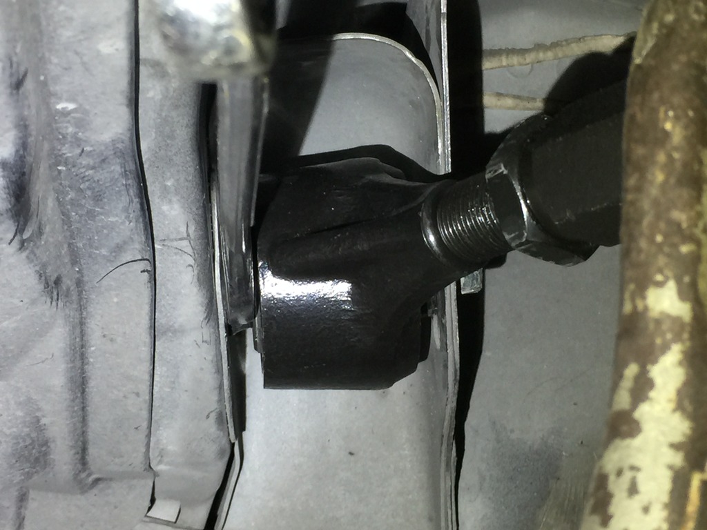

Pics.
You can see the wrench on the left side of the forging/bearing keeping it parallel. This is on the passenger's side, rear forging.

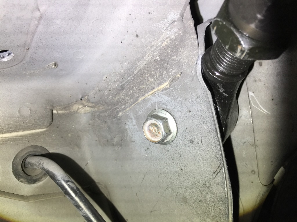

Here's a shot of the front forging/bearing, passenger's side, closest to the front of the car. You can see where the sheetmetal has been pushed out in an arc as the forging is pushed up. This is with the arm pushed fairly far up.

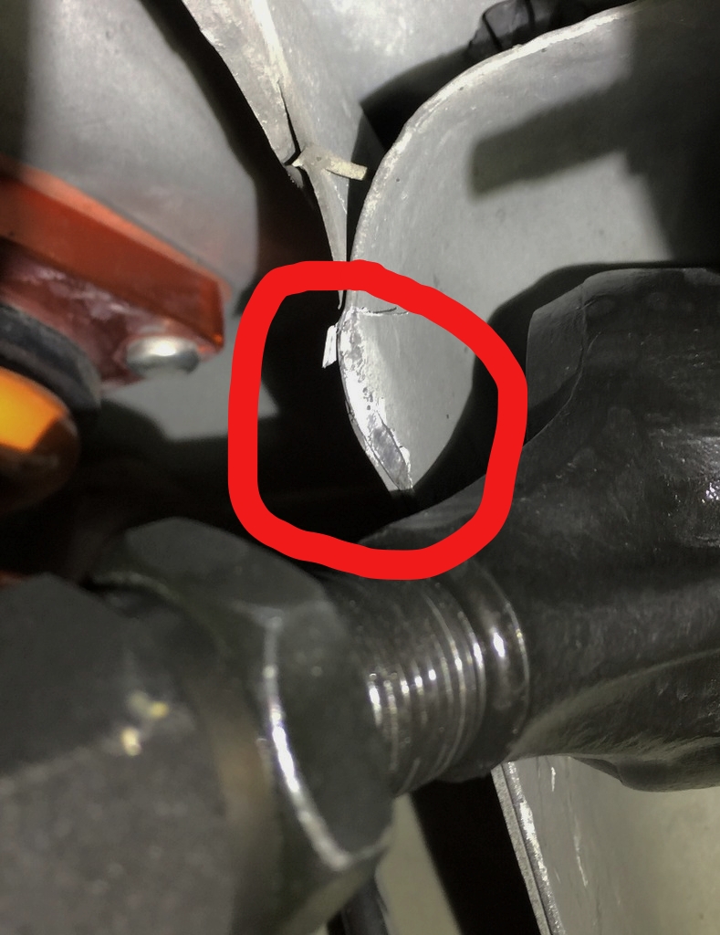

Here's a shot of the damage, with the arm all the way down (decompressed). This is before I took everything out to make adjustments and you can sort of see how the end of the control arm, the forging, is skewed and not parallel to the sheetmetal.
It seems like there's more clearance on the rear side of the control arm. It did this on both sides. I measured the length of each end and there's no difference.

Pics.
