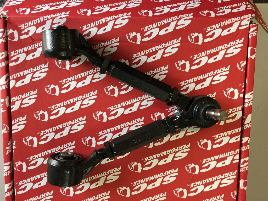

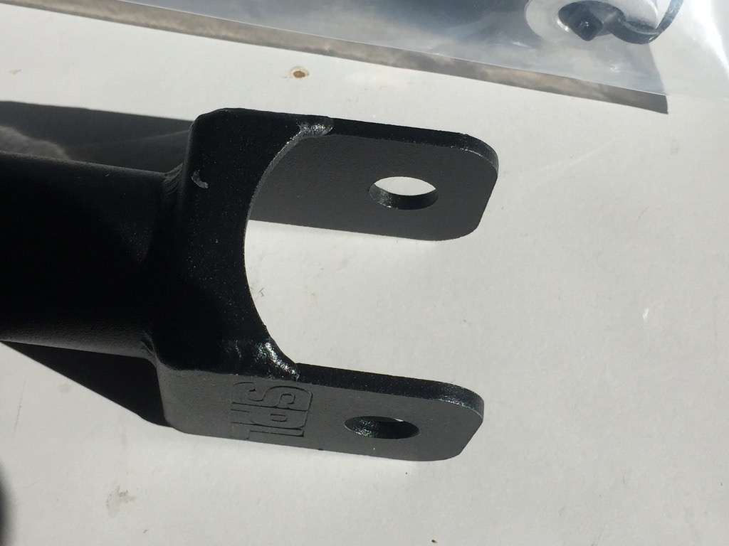

SPL rear camber arms in hand. Ah no wonder they got here so quick...I had no idea they were in Austin.

Old Dec 1, 2016 | 08:26 AM
Likes: 4,952
Almost too pretty to install

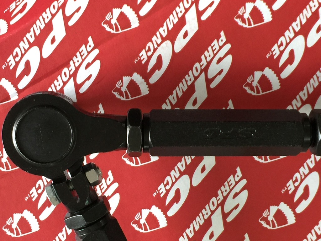

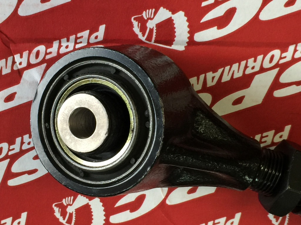

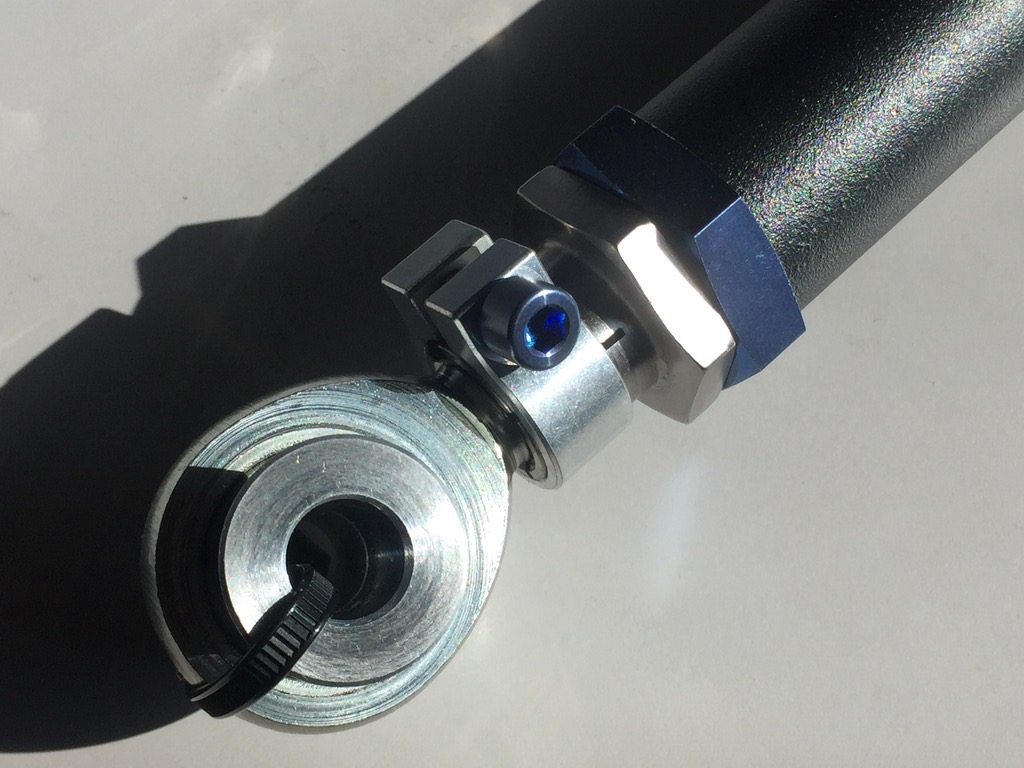

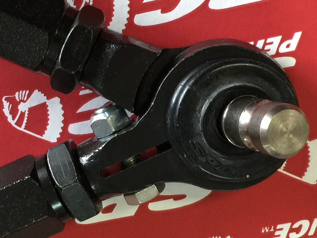

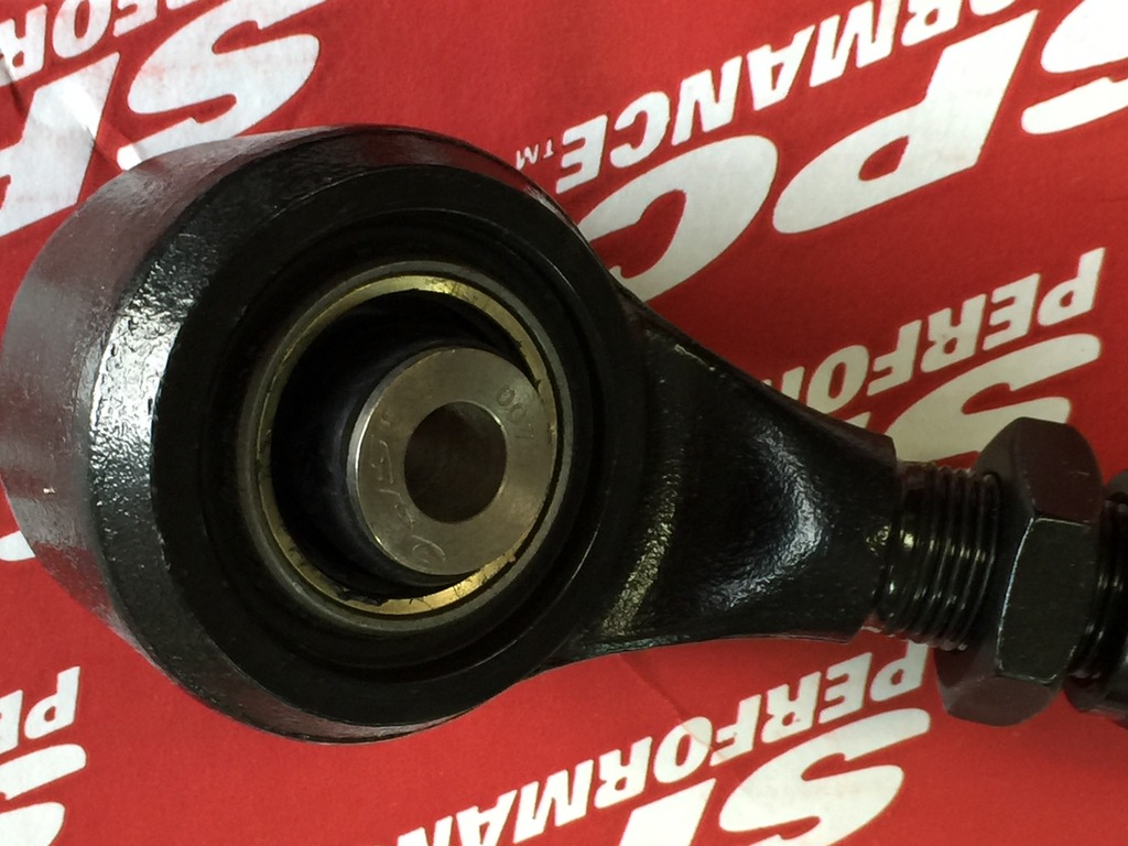

The front SPC arms came in this morning. Haven't seen anyone else that's purchased these yet so it's probably the first up close and personal look at them. You'd have to hold them to really understand how durable they seem to be made. It's a really solid piece. I think the Voodoos or SPL's would have been lighter but they were also $300 more expensive.

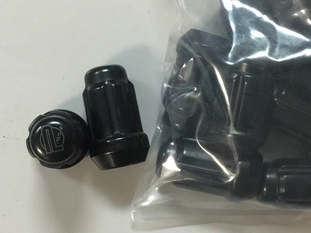

One more piece of the puzzle, or in this case, 20 pieces. Micro chromoly lug nuts, 32 grams each. Closed end. I could possibly see myself going with a forged high quality aluminum lug later on but these should suffice.

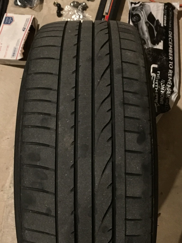

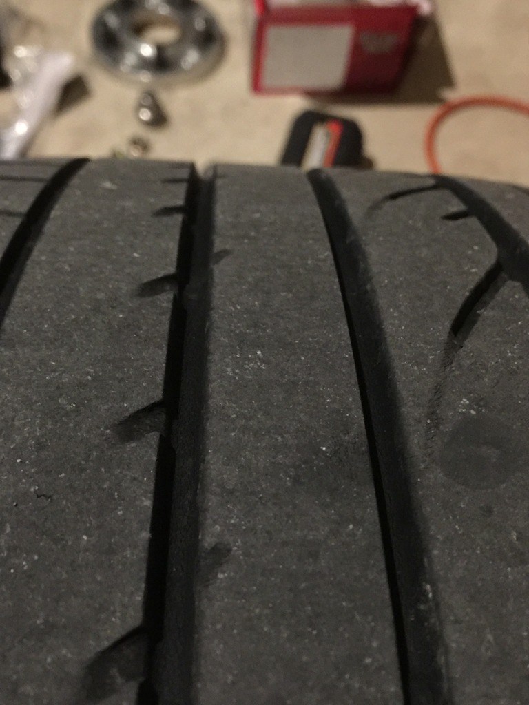

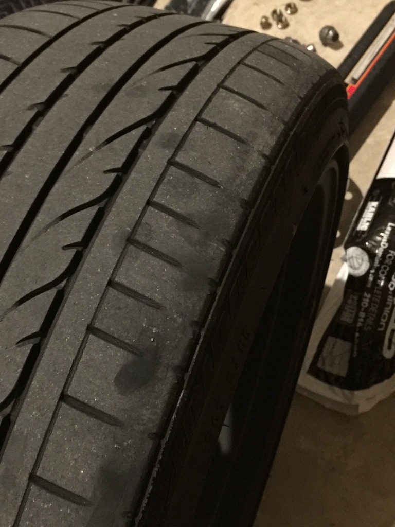

Pulled one of the wheels last night to do a bit of test fitting and here's how the front tires look. Not good. Looks like I could have gone well through the winter and into spring had my toe not gone out.

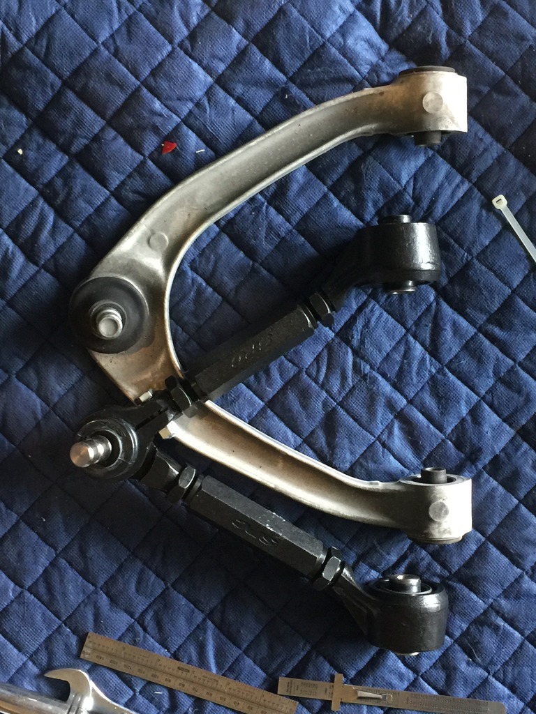

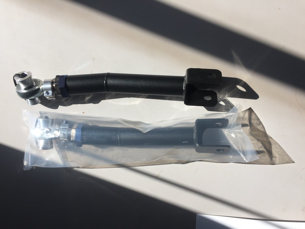

Spent half a day installing the front arms and rear links along with a few other tasks.

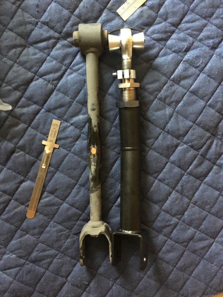

One thing I noticed is the SPL arms, adjusted out as far as they recommend, are shorter than the stock arms. I didn't measure the difference but I'm guessing it's a bit less than half an inch. The alignment in the rear is way off but I'm taking the car in tomorrow morning for an alignment. My toe is pretty out, car looks knock kneed in the rear. Luckily I'm a mile from the shop.
Everything went in fairly easy, no major issues. Both the SPC's and the SPL's require some big open ended wrenches which I didn't have. I used channel locks instead. It'd be great if they listed the required tools in the instructions. As for instructions, there really aren't any to speak of but there are plenty of DIY threads on this and the370 forum.

Thanks for the great comparison pics, sounds like a full day there Look forward to your reviews.
