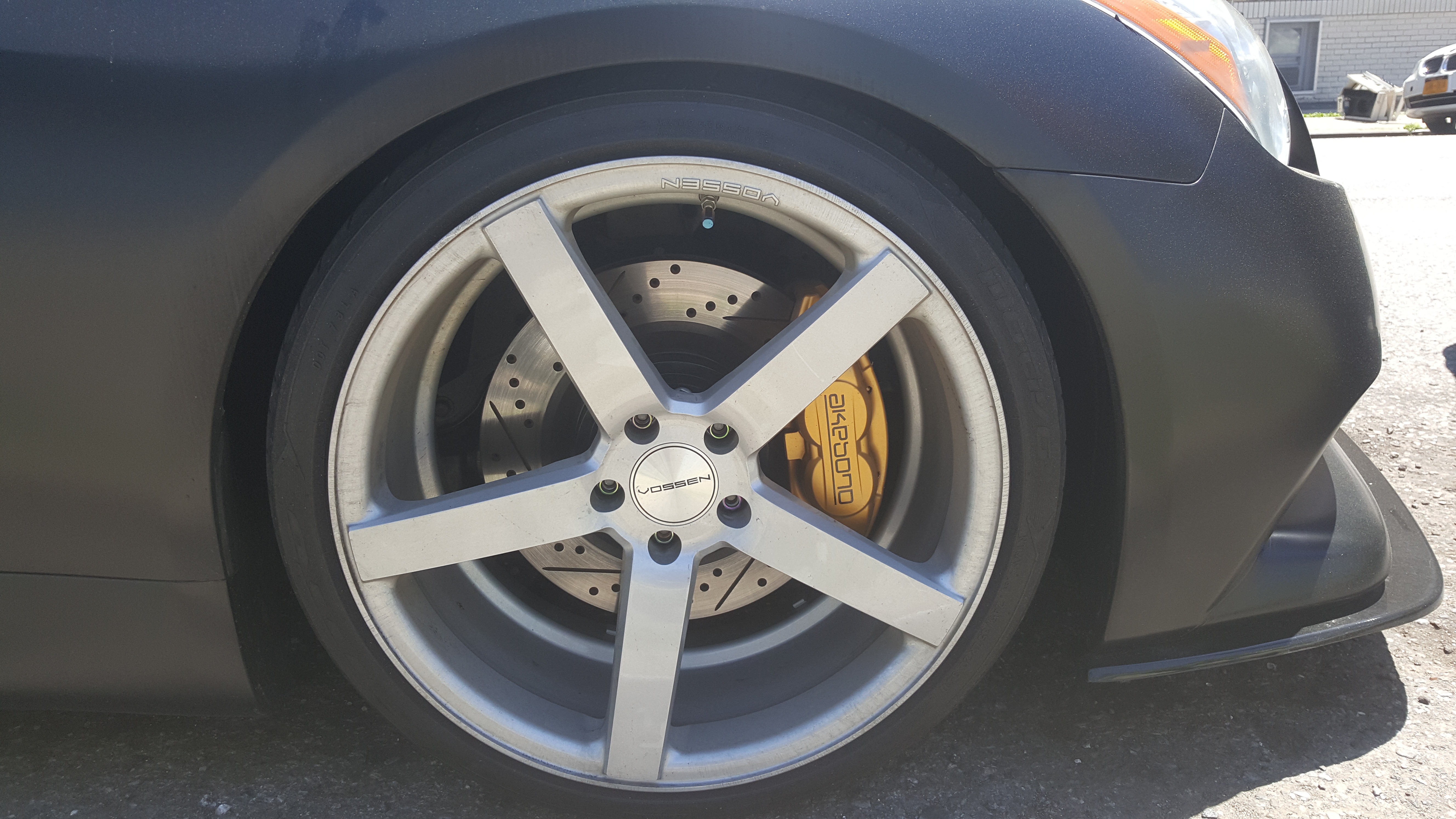

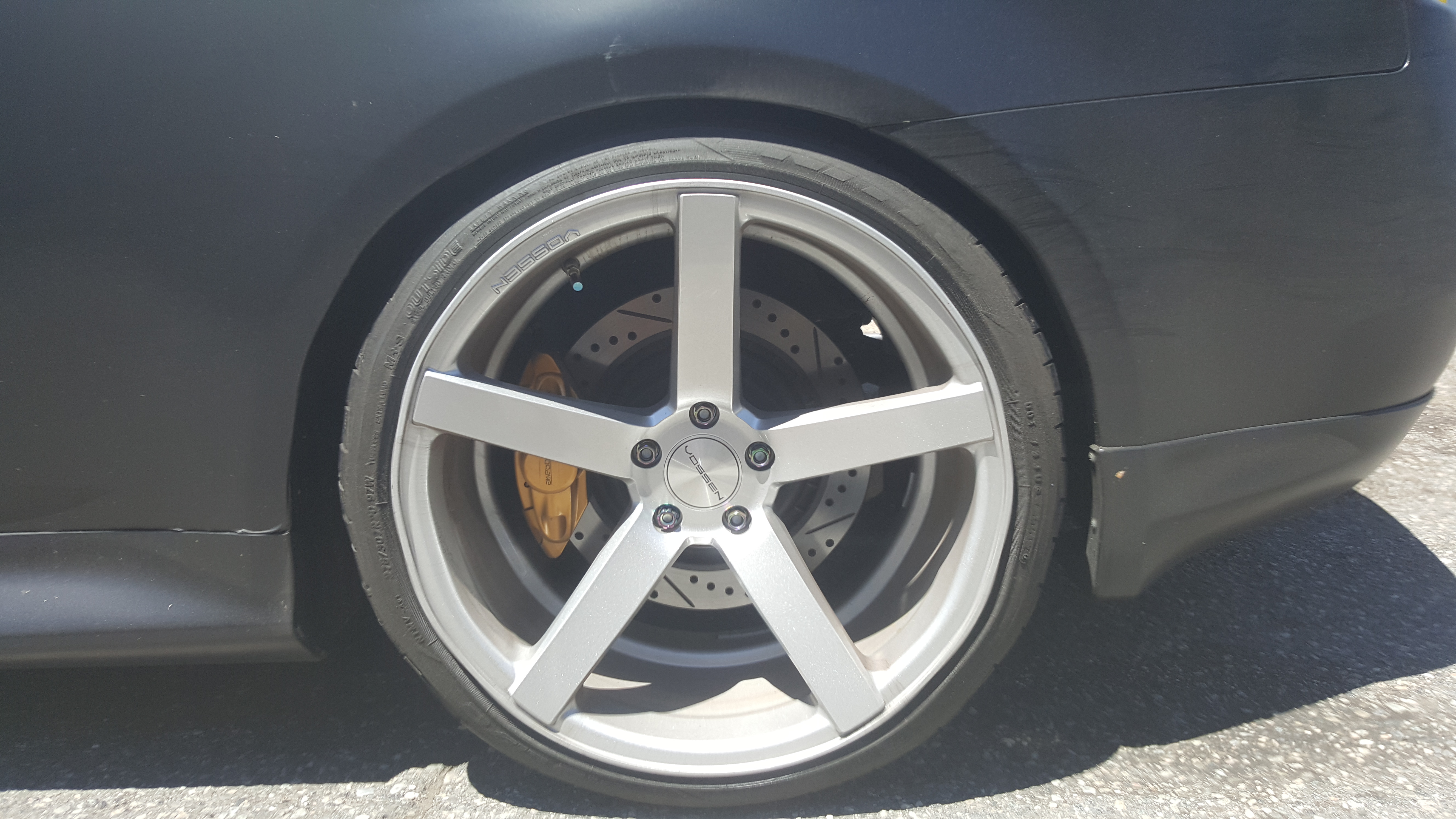

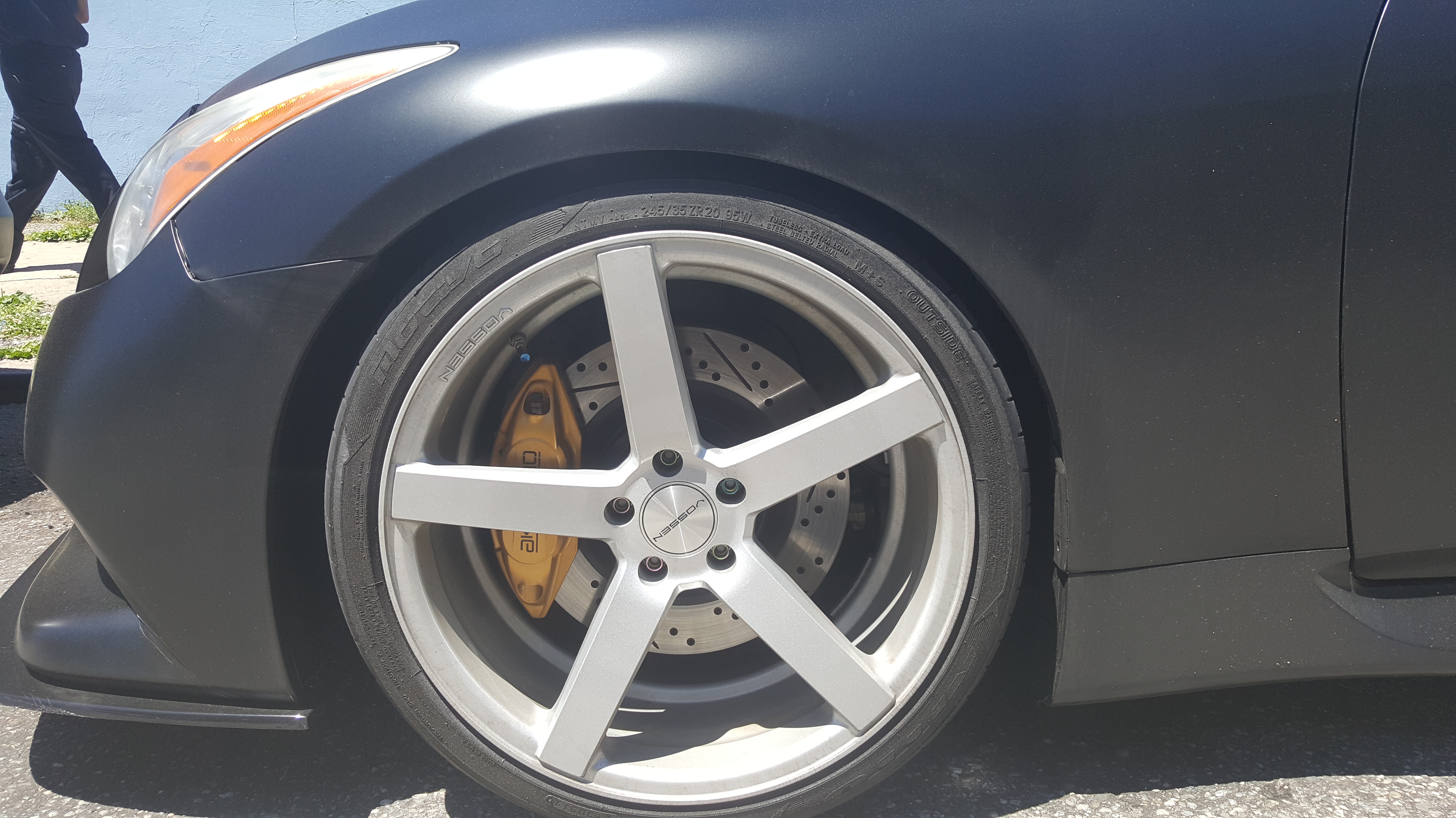

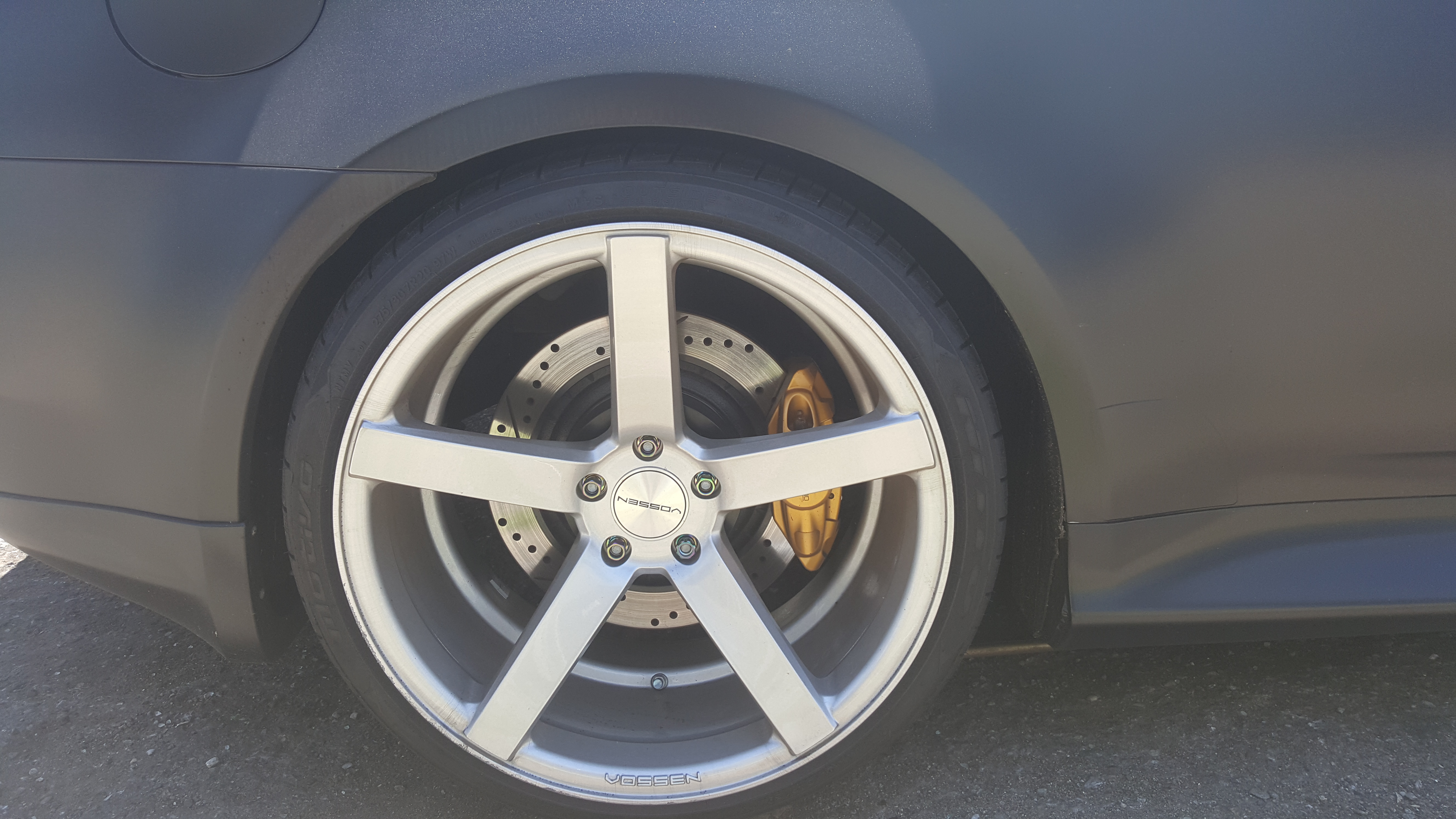

I have the Eibach Pro Kit on my X coupe and i think as for springs they're great. I live in NJ and the weather especially snow is pretty bad but I've lasted 2 winters so far without any issues.
I can't really speak on other brands but swift have good reviews as well but not as nice of a drop as the Eibachs from what I've seen. The Swift is more of a subtle drop.
Here's some close up pictures of my drop to compare what yours will look like on all 4 sides on an awd coupe.
