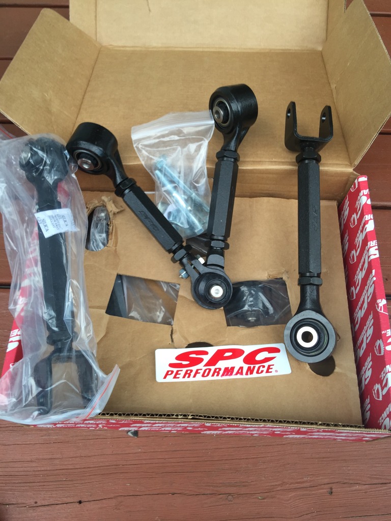

I got both waiting for my coilovers :
$512 SPC performance x-axis A-arms (#73005)
$189 SPC Performance x-axis rear camber arm and toe bolt kit (#72262)
