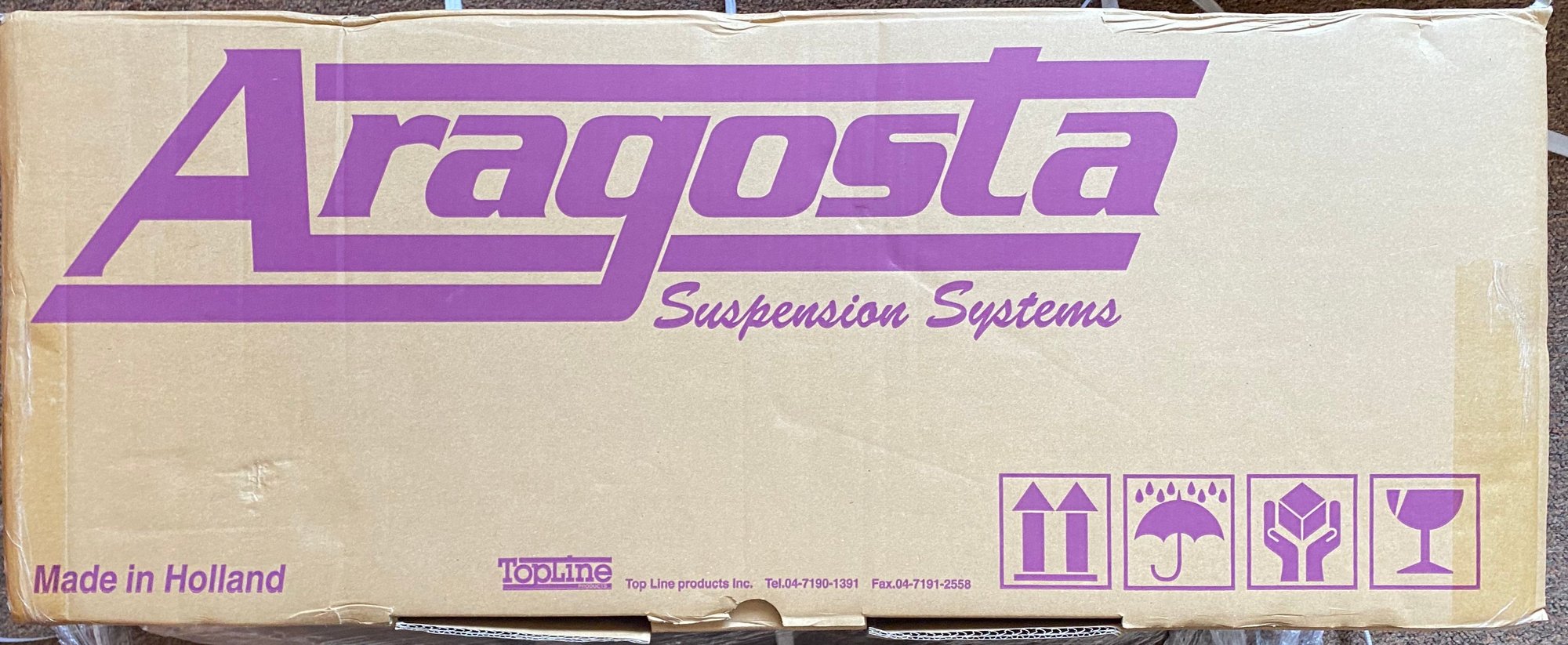

Brand: Aragosta
Model: Comfort Type S
P/N: NI-A1-000
Type: OEM
Body type: Monotube
Upper mount: Pillowball
Separate hgt adjust: Yes
Damping type:
Damping adjust (F/R):
Rate (F/R), kg/mm: 15k/7k
Front/rear ratio: 2.143
Spring diameter, mm:
Rebuildable: Yes
Warranty (yr):
Note: Aluminum body; Japanese dampers that can be rebuilt by Moton in USA; coupe rates are 12k/10k
Brand: Aragosta
Model: Comfort Type E
P/N: NI-E1-000
Type: OEM
Body type: Monotube
Damping type:
Rebuildable: Yes
Warranty (yr):
Note: Steel body; Japanese dampers that can be rebuilt by Moton in USA; coupe rates are 12k/10k
Brand: Aragosta
P/N: NI-E1-R00
Type: OEM
Body type: Monotube
Upper mount: Rubber
Damping type:
Rebuildable: Yes
Warranty (yr):

Curious on the note on AST's...
- I don't think AST is Japanese product?
- I understand AST and Moton merged, or AST bought Moton, whichever it is.
- Did you mean that Japanese Aragosta dampers can be rebuilt by AST USA, since they share some AST internals?

I'm going by what Ape Factory wrote in his Choosing the right coil-over thread regarding the Aragosta rebuild. I do believe I cutted and pasted rong abow the AST. Wot a dumazz.

Aragosta Coilover AWD
Bringing this back from the dead just got a custom made first set of Aragosta Coilovers made for the AWD Sedan.
Brand: Aragosta
Model: Type-S
Price: $2800
Type: OEM
Body Type: Monotube
Upper Mount: Pillowball
Separate Height Adjust: Yes
Dampening type:
Dampening adjust (F/R): 20/20
Rate (F/R): 14k/10k
Front/Rear ratio:
Spring Diameter:
Rebuildable: Yes
Warranty:
Note: Rana springs
