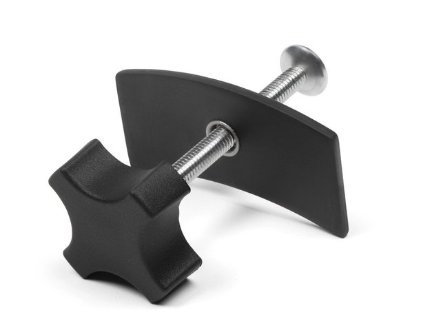

Can the caliper pistons (front and rear) be pushed in with just a C-Clamp? I don't need a specialty tool for this right?

this is what i use
Yes. I used a c clamp and placed the old brake pads in between the c clamp and the two pistons and pushed them in.
