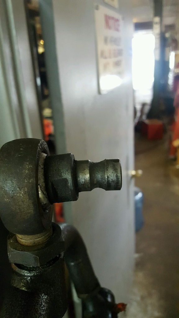

Anyone ever have these arms then go to SPL? I'm curious to see how the SPL arms differ in physical dimensions over the Z1's. I'm at the alignment shop now and the design of the Z1 arms just doesn't allow enough suspension travel when the car is lowered significantly like I am on coilovers. My fender lips are just about 26" from the ground in the front. I actually had one of the ball joints snap in half on my control arms and now I see exactly why.

Z1 sent me out a replacement ball joint over night, but I'm thinking just the design of these arms aren't meant for the G37x sedans. They physically fit of course, but the angle of the ball joint needs to be pointed further down. My alignment shop and I also just verified the arms are installed 100% correctly.

That sucks bad. I'm a little over 25.5" from the ground on my front driver side and have had the Z1 FUCA for a few thousand miles. Can you take some pictures of the brake? Which hemi broke? Was the arm impacting somewhere? I would like to see if the same future is laid out for me. At least Z1 acted fast to get you a new joint.

I would raise your car up ASAP being a G37x sedan. Z1 claims they've done extensive testing on these arms on their Z1 track 370z, but I think that's a completely different situation than a daily street driven G37x sedan that's been lowered quite a bit. The problem is that the downward angle of the ball joint is just not enough once you go lower than about 26.5" from ground to fender lip. The ball joint runs out of travel and you can see where the ball joint actually starts smashing into the outer lip of the heim joint. It will eventually bend like this and will eventually fail:
I had to raise my car up a good 3/4" so the car is safe. I must admit the car drives 65783168510x better now that it's been raised a bit and has a proper alignment by a shop that truly understands suspension.

Ah, now I see what your talking about. They need to adjust the knuckle mount point to be more conclusive to lowered cars, issue a high-misalignment spacer kit, or figure out something else.
I just went and looked at mine, now knowing what to look for, and the angle is almost maxed out on the drivers side and nearly maxed out on the passenger. I will call Z1 today. There is little in the world that will make me raise my car unless they are going to pay for the corner balance I would lose and the re-alignment. Since I'm only an hour and a half or so from Z1 I will try to work something else out.
Thank you for bringing this to our attentions, its an important thing for people with lowered cars and these FUCAs to know. I do not see how it would be AWD only thing. Yes, our FLCA is different and we yet a driveshaft and a different yoke for the front shock but all the upper front suspension parts are the same to my knowledge.

Exactly. I emailed them today calling this out and sent them the picture. I requested a replacement ball joint now that I'm at "proper ride height" and asked that they add a disclaimer for cars that are lower than 26.5" or so from ground to fender. It's just frustrating because the only reason you even buy these arms is when you lower the car...
