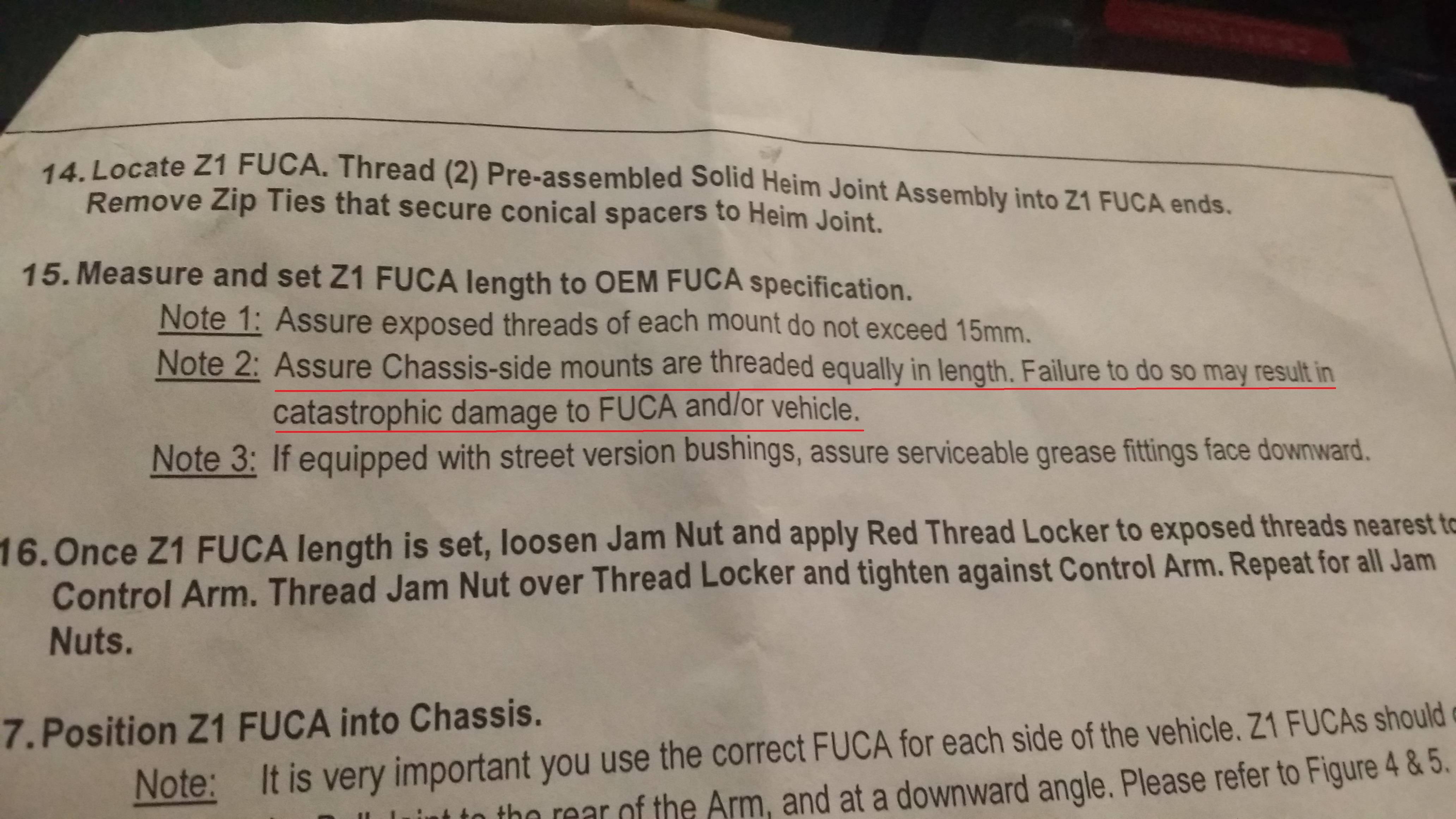

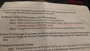

35sport if you think it's "misinformation" then both SPL doesn't know what they're talking about and neither does Z1 when you call and talk to them...
What you showed is initial install of the arms. Do you think you install them as close as you can get and leave them like that? Hence the "set the arms to the factory fuca lengths".

From: Central Florida
Originally Posted by jfisher
The principal of caster adjustment on the Z1's is exactly like it is on the SPL's. "To adjust caster, lengthen or shorten one adjuster at a time. For more caster shorten the adjuster towards the rear
of the vehicle or lengthen the adjuster towards the front of the vehicle. For less caster lengthen the adjuster
towards the rear of the vehicle"
Page 1, second paragraph of SPL's instructions:
http://www.splparts.com/content/SPLFUAZ34.pdf
Neither does SPL
Z1 Motorsports Adjustable Front Upper Control Arms feature an offset ball joint location in order to deliver an optimal caster increase. Increasing the amount of positive caster will increase steering effort and straight line tracking, as well as improve high speed stability and cornering effectiveness. Positive caster also increases camber when cornering as the steering angle is increased to keep your Z planted through hard corners.
**In addition to a slight increase in caster, they have an adjustable arm length to provide additional camber adjustment for stance or tracking for the serious motoring enthusiast.
