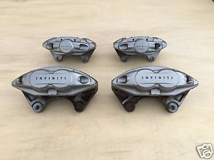

Hey guys just a few quick questions owned a 05 g35x did some things like change mid pipe with the coupe and intake muffler delete etc
Now just upgraded to a 09 g37 vert ( couldn't get ahold of a g37s in time) so I was already thinking takeda long intake maybe lowering a few inches just to close wheel gap, going to have top connected to fob to go up and down, remote start, strut bar but my main question is the OEM infiniti calipers that say infiniti if I was to buy them would I be able to just instal them since my car didn't come with them or do I need to change out the lines as well.
Thank you.
Attached Thumbnails New to posting just bought g37 vert quick question on oem caliper-s-l300.jpg

Welcome to the site, I'll move this to the brake folder for specific replies~
You'll need new rotors and new banjo bolts if you use the OEM lines, also need to trim your smaller dust shields. Not sure about the verts but the regular non Sport Gs also need a spare tire/wheel from the sport as the regular spare won't clear the big brakes.
Here's a thread that should help
https://www.myg37.com/forums/brakes-...the-cheap.html
