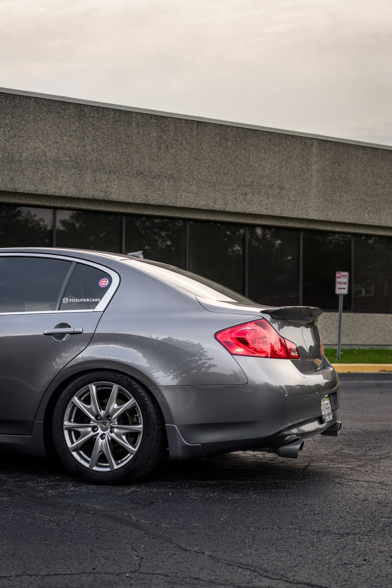

Here a photo, i will take better shots on the weekend.
Attached Thumbnails BC BR Type Coilovers + '12 G37xS sedan-f83b5833-b473-46f0-b45b-760e0eed0b83.jpeg
