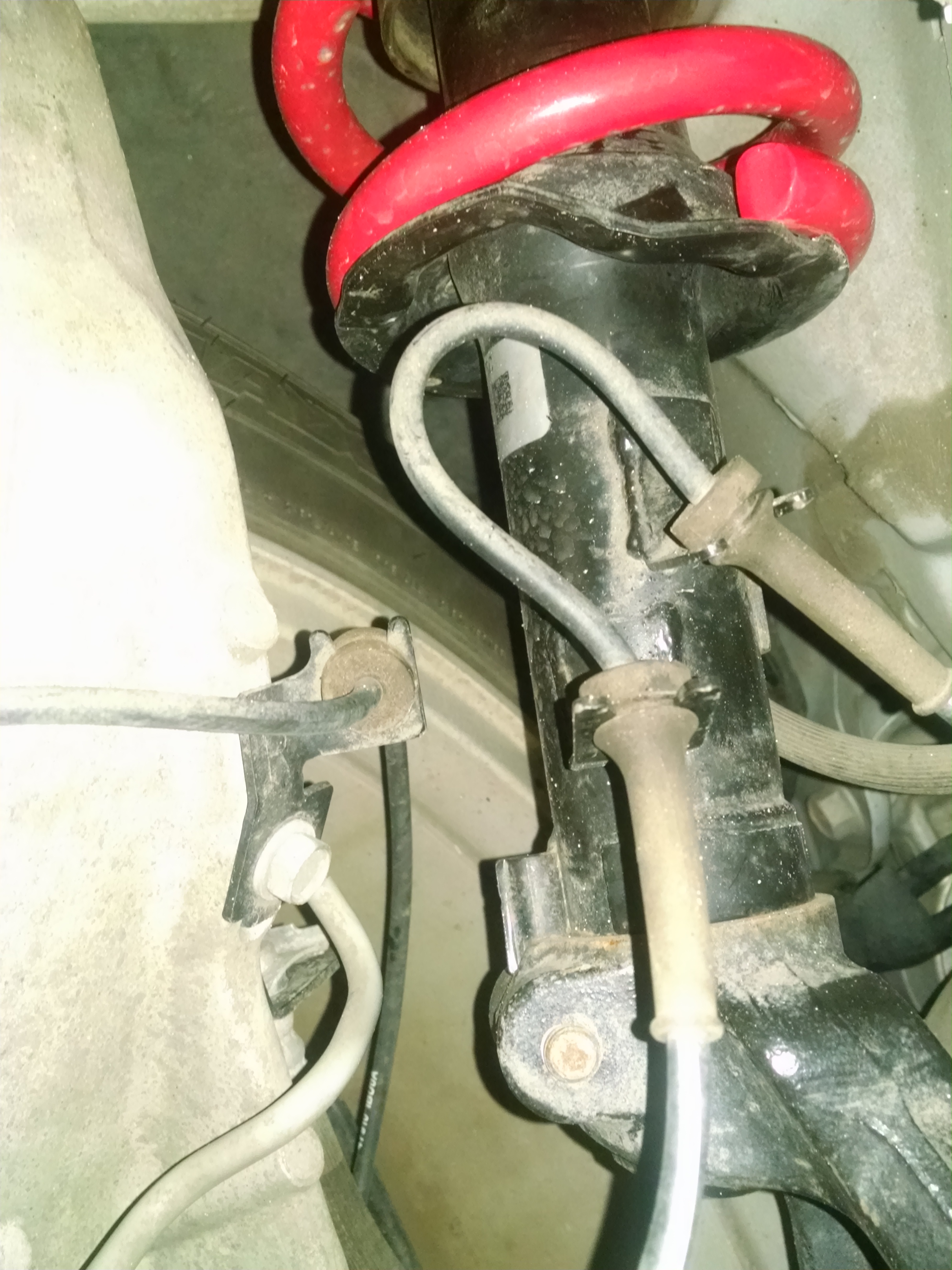

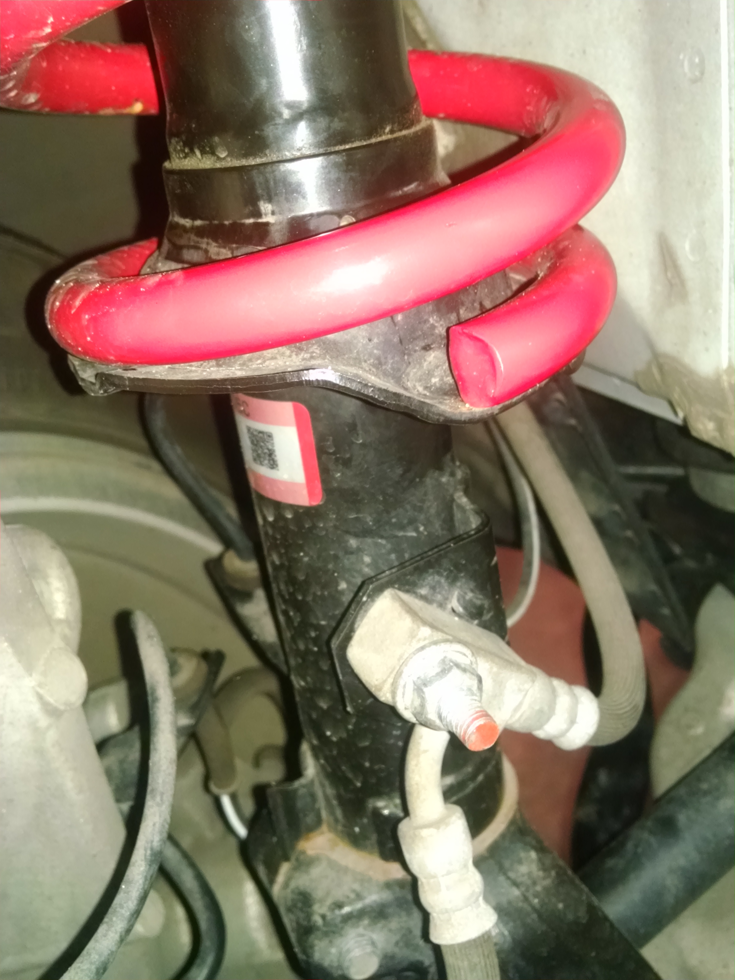

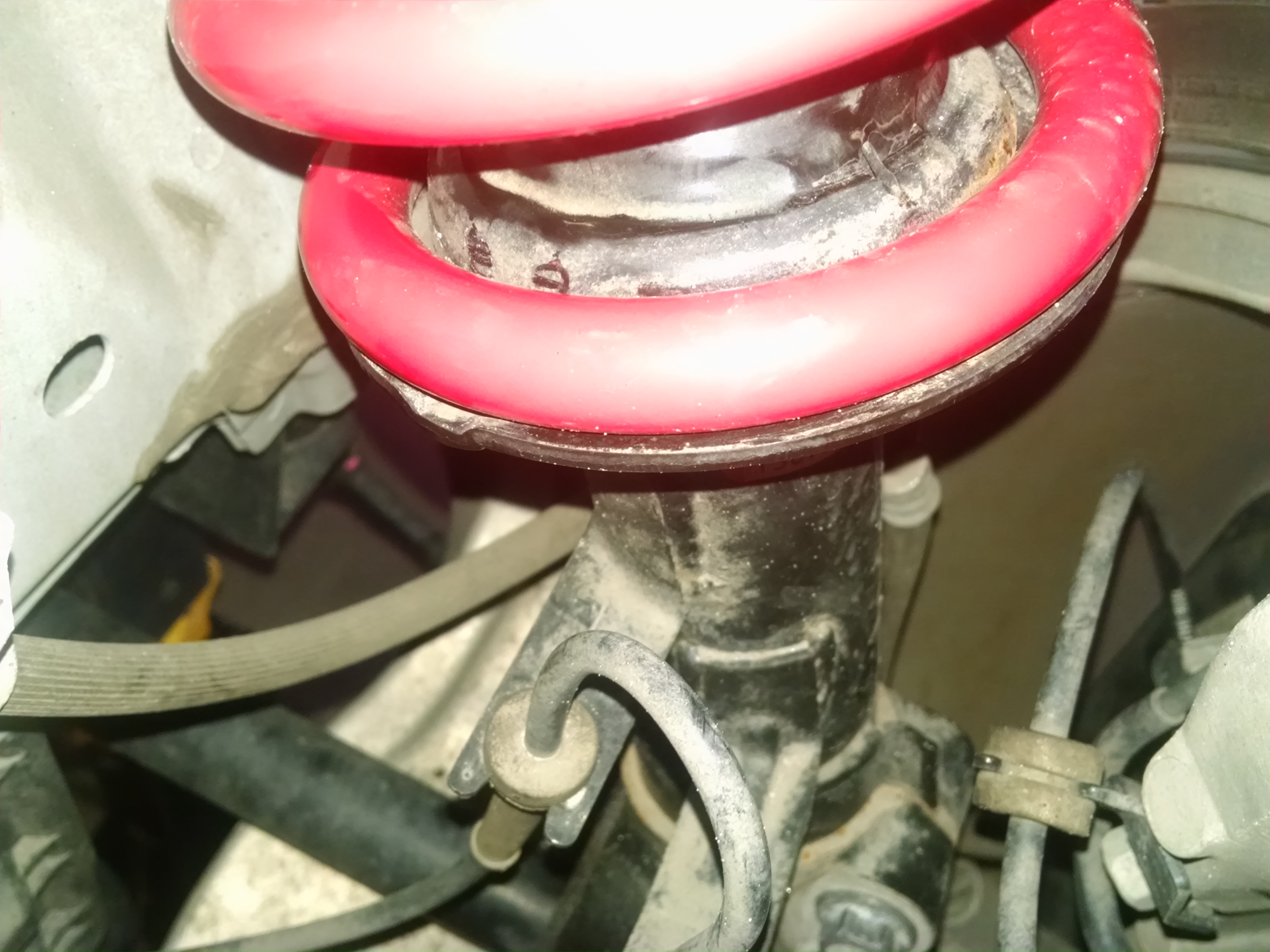

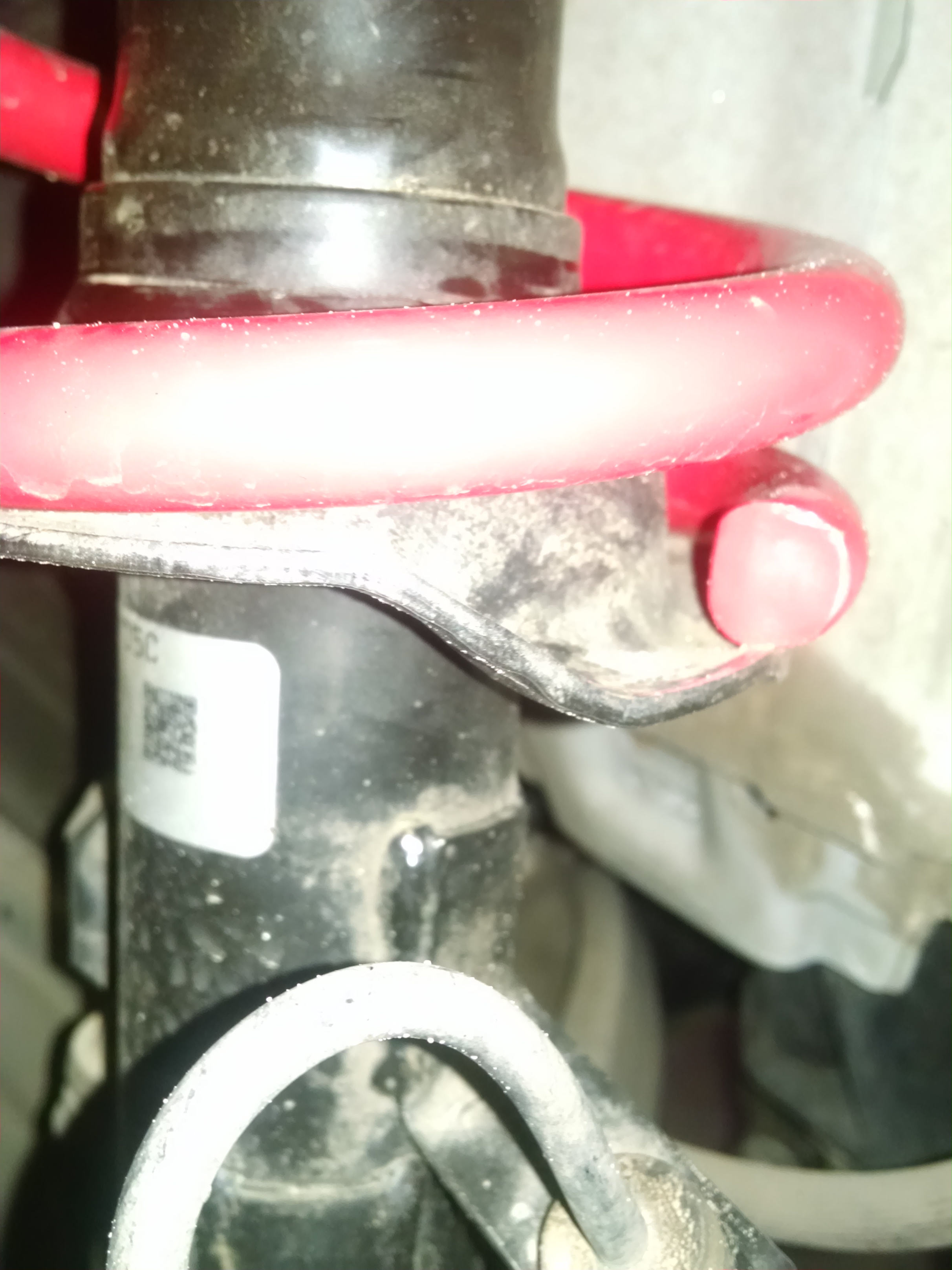

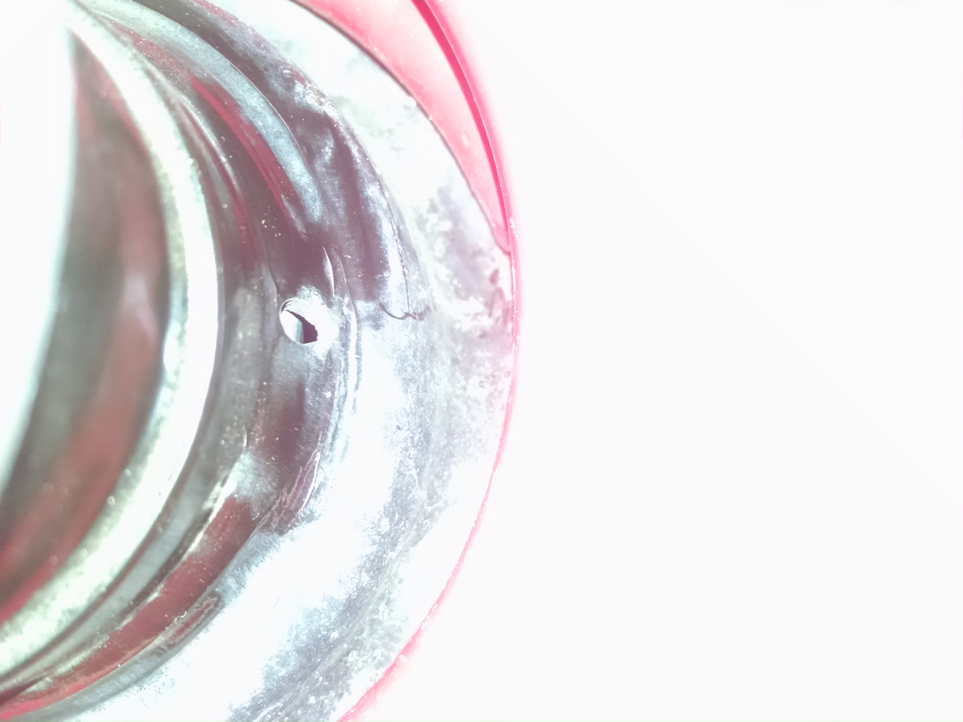

Due to overwhelming amount of good reviews I installed a set of Swift springs on my Q60 coupe. I'm happy with the springs ride but concerned about the fit. The inside diameter of the springs aren't close to the OEM set. They sit very loose on the shock perch. Swift tech said "this is normal", "the springs will shrink in ID when compressed" and "no need to worry about spring coming off perch". Here are some pictures of the springs mounted. Keep in mind, the backed off spring and brake mount has been fixed, I'm just looking for advise on the gap between the base of the shock and the spring itself. From what I have read about springs, the ID expands when compressed not shrinks. I'm concerned that the spring riding on the outer edge of the perch will weaken the perch or the end of the spring will come off. For those of you that have mounted springs, is this gap normal? Should I worry?

Can't tell w/ pic 1, pic 3 & 5 the spring isn't properly turned so the end of the coil is to the end of that indent in the shock flange/seat. Pic 4 seems to look OK as far as I can see, but would be better if you had a picture looking up from the bottom to see how much of the seat is under the spring in pic 4.
I wouldn't drive it until you at least get that spring turned so it's seated correctly. As far as the spring ID "shrinking" when compressed, gotta call BS on that one. From most of the pics there does seem to be a sloppy fit at the seat so you may have gotten the wrong part #.
Spring has been corrected and is now correctly seated. I included these pics as they give a great look at the gap between spring and shock tower.
Pic 4 does have the spring seated correctly but you can see the different dirt mark shading from where the OEM spring sat. I'm unable to get a perfect picture (see pic 5) but the spring end sits right on the edge of the perch. Meaning the edge of the perch is right up the middle of the spring (1/2 of spring on perch and 1/2 off the perch). This didn't change when I turned the spring on the perch. On one strut the spring sits to one side of the perch where the other strut the spring sits centered. I compressed the spring on the off center one and centered it but it moves itself back after I decompress the spring.
The springs I installed were from 4N911. Maybe I got an out of spec set. I'm awaiting for the ID specs on these springs. Hopefully the tech I talked to sends them out promptly.
