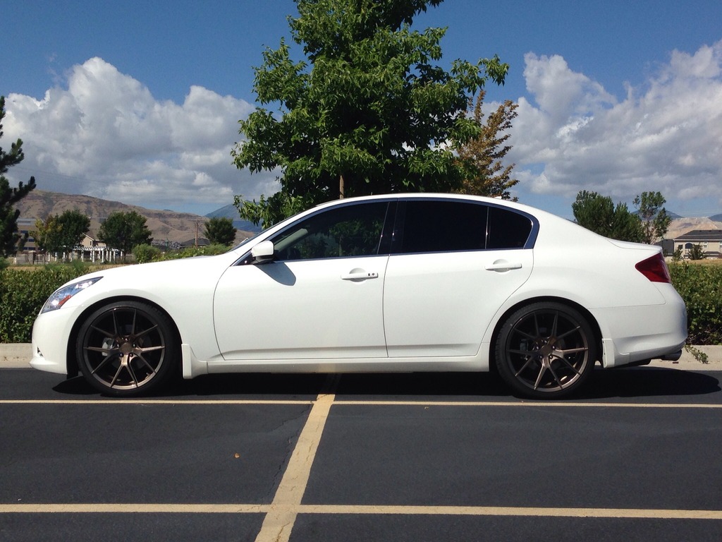

I thought my PC was playing tricks on me as I thought those had a bronze tone but didn't know those are available in bronze (thought they might be gunmetal). Great choice, nice to see more wheels available in that shade, and goes very well w/ white
Kind of a bad pic to see the true wheel cool. Regardless though, thanks man, I wanted to do something different then all the G's I've seen around here.
