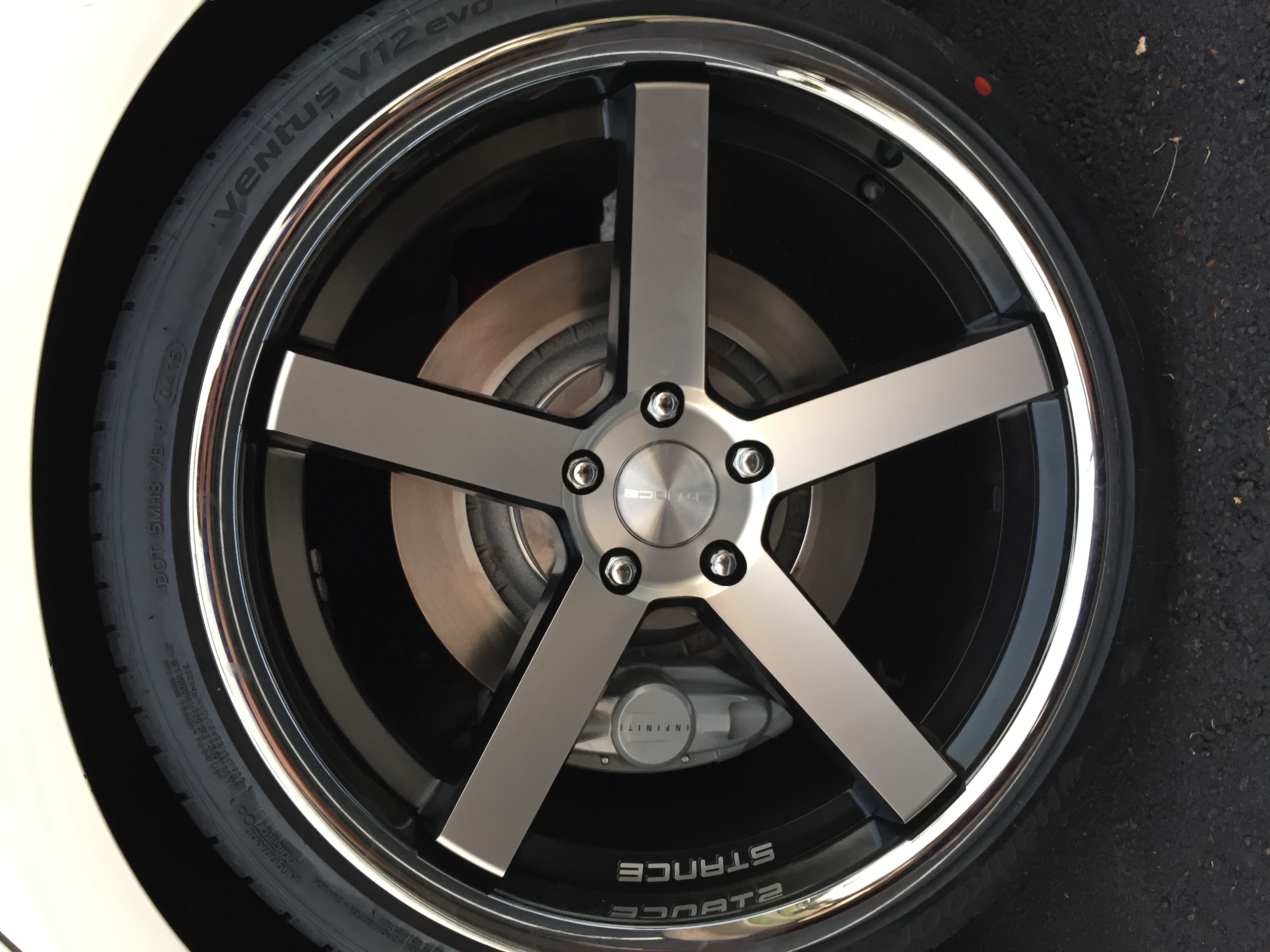

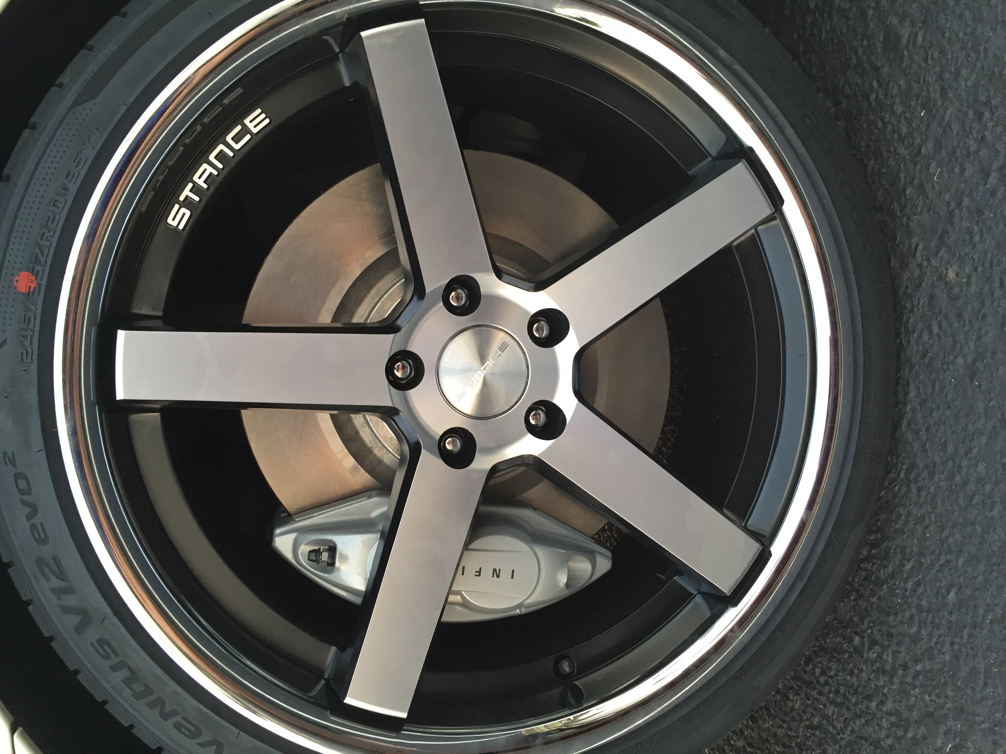

Here are some pictures of my car:
Attached Thumbnails Akebono BBK installed. No pressure on brake pedal after bleeding the brakes!-img_4017.jpg   Akebono BBK installed. No pressure on brake pedal after bleeding the brakes!-img_4016.jpg   Akebono BBK installed. No pressure on brake pedal after bleeding the brakes!-img_4015.jpg

Looks good! It's almost weird seeing someone do BBK and not have slotted rotors now.
Haha I really like the look of drilled/slotted rotors. Next time when I need new rotors, it's gonna be drilled/slotted.
