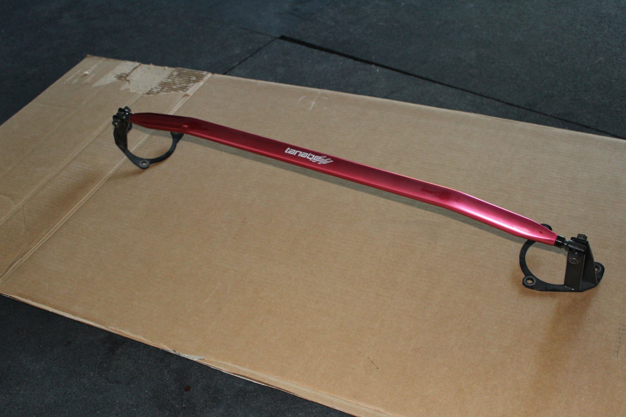

Well finally got the strut brace today after about a 3 month wait. THMotorsports was great about keeping me updated and since this was on a national backorder, and a brand new offering, I expected it to take awhile. The part is Tanabe Sustec Front Strut Tower Bar Part # TTB176F

Great packaging, well padded & protected, item arrived in perfect condition

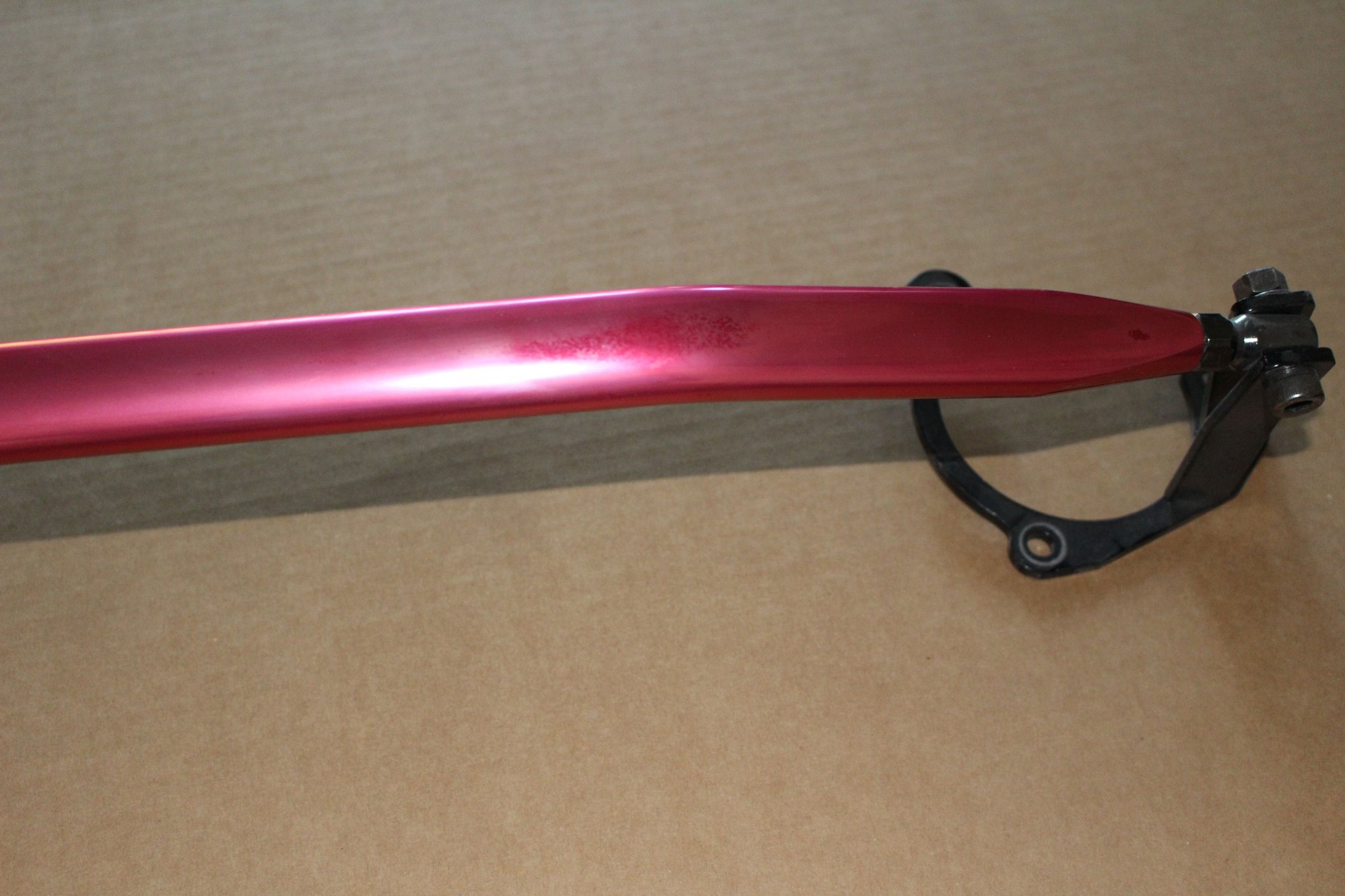

Nice, substantial brace, w/ an integrated support rib on the underside of bar, bar mounts are well designed w/ excellent fit.
The adjustable threaded ends allow the bar to be adjusted for a perfect length, again, the fit all around is perfect. The design of the bar & brackets allows great access to the adjustment of my coilovers too
Overall very happy w/ the product, it appears to be well made and the fit seems to be on par w/ the Cusco & GT Spec braces. I put a few small dabs of liquid soap across the bar and closed the hood (w/ the liner on) and it did make contact on the very outside points on the bar where the bar angles up then flattens, but not in the center. Hood closed fine without any additional force so the contact is minimal. The contact w/ this brace seems to be exactly what the Cusco & GT Spec braces also have. I'll keep an eye on it and if there's any wear on the finish I'll post updates.
One important thing that I left out and it clearly states it in the instructions "if you want the bar to lay flatter just shorten the bar with the threaded end links or if you want it taller, lengthen them." That makes perfect sense and I've got about 3/8" of thread on both sides to shorten it, so this weekend I'm going to see if it gives it enough clearance to avoid any liner rubbing, stay tuned........
After install and a spirited drive the front end does seem to be a bit more locked-in for lack of a better term, not drastic but noticeable.
For about $130 shipped this seems like a great buy for a strut brace from a quality Japanese company. It's currently only listed for a 2014+ Q50 application, BUT I CAN ASSURE YOU IT'S A PERFECT G37 FITMENT.

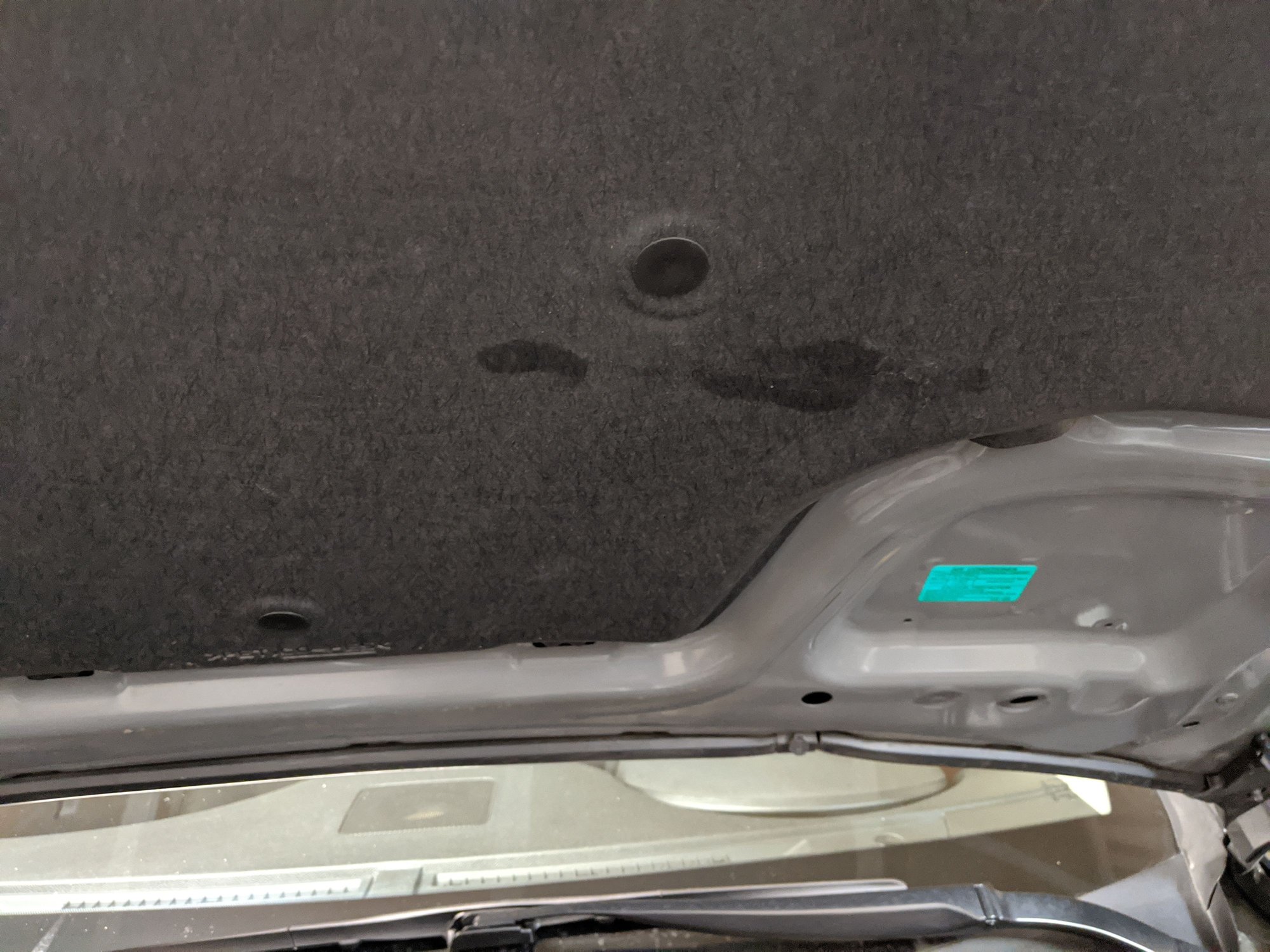

Fresh pics of slight buffing on the ends from the hood liner

so bought mine for little over 130 with shipping and tax. The fitment worked even though it say q50. There is slight rubbing on the hood liner but not a big deal imo. So far I think this is a real good deal for a nice tower bar. It is in par with the gt and cusco bars for a cheaper price.

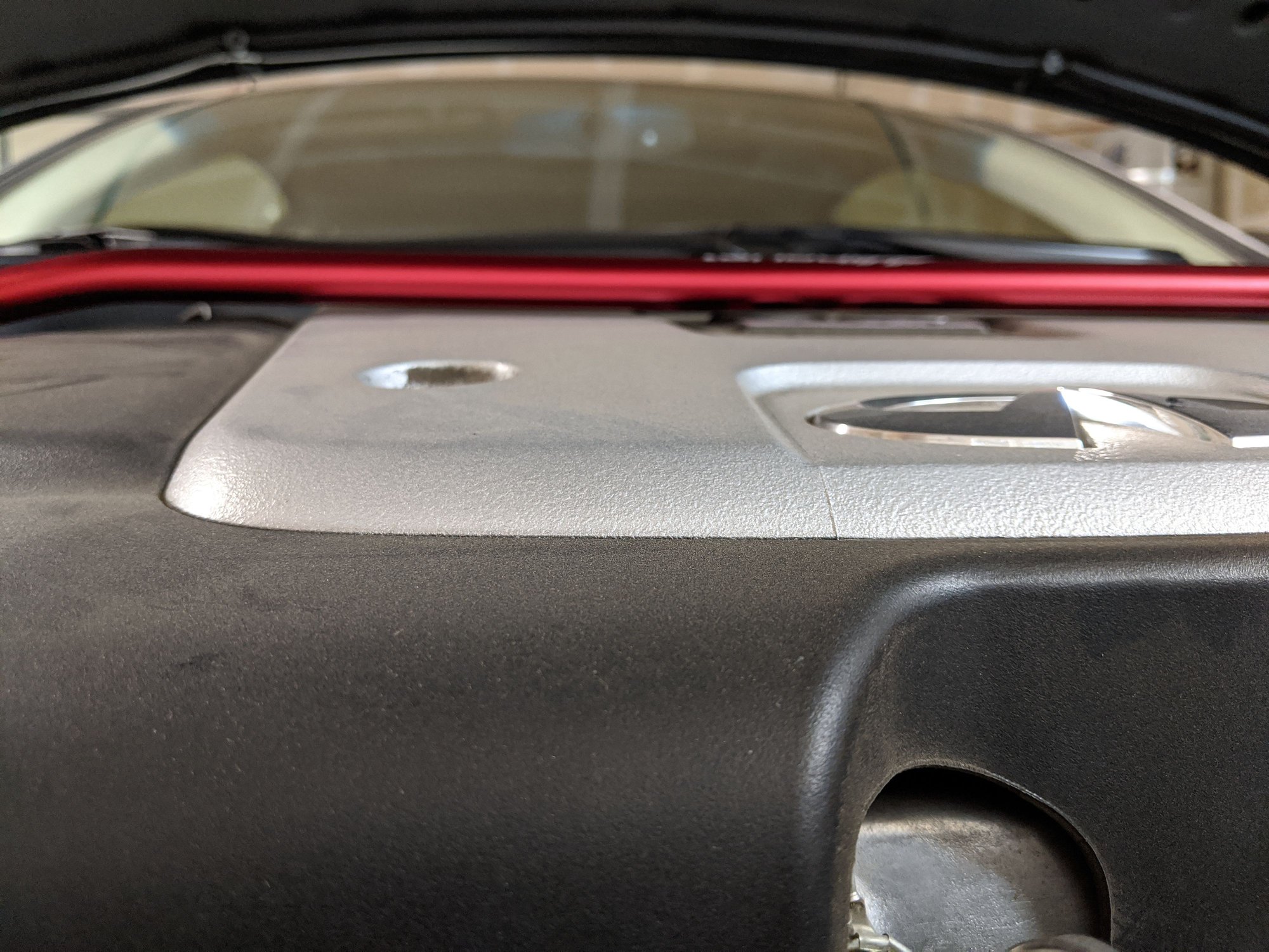

Like he said above it works great. This is on a 2013 g37 coupe. Couldn't get a good picture but the bar is not touching the engine cover but is close

The hood liner contact will mar the finish of your new FSTB, guaranteed.
There's a really simple, common solution, too... remove the hood liner.
