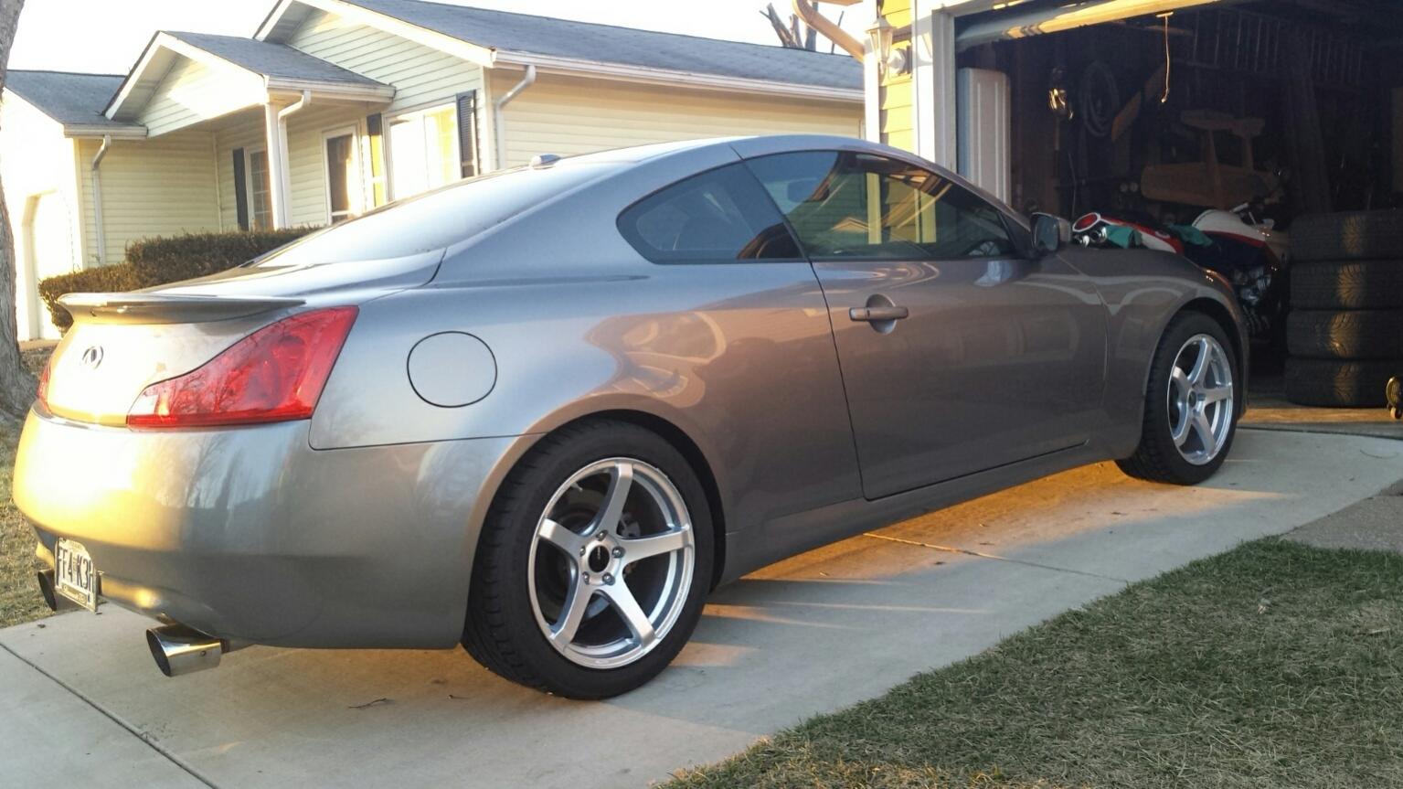

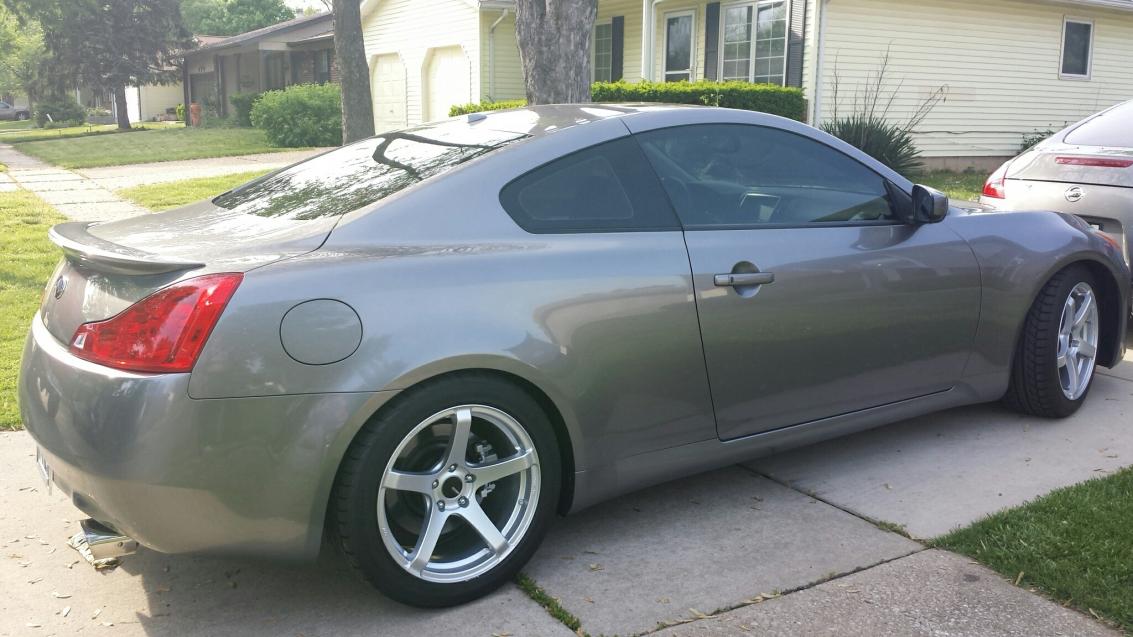

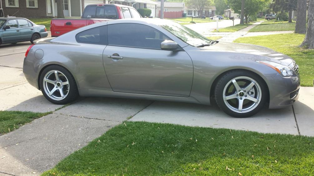

Here are my alignment specs, the first file is all stock. The second is with the springs and new rims, and tires. I added a before and a couple of after pics of the drop. 5-3-15

I haven't had a chance to take any decent pics since the springs have settled, but when I get a chance I will do so and add them to the review. There are some pics in the aggressive offsets and fat tires thread that I took right after I put the springs on, but they have dropped another half inch or so since I took those.
